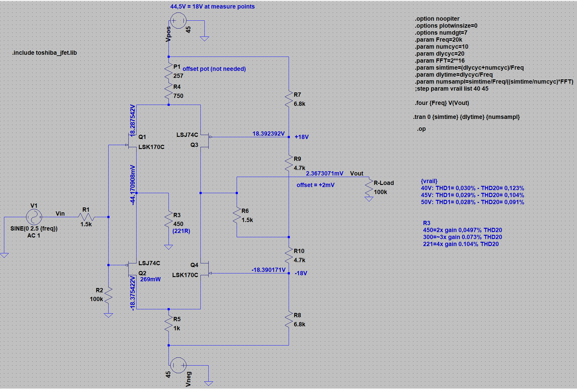

Preamp with LS Jfets
gain is matter of R6 value
I played with it and lower I could get was 3,5X, but not in a very linear way. Not satisfied, I played with R3 instead, and I'm not sure how to interpret the results of the simulation. It should affect the currents, but dissipation of the 4jfets was basically the same. Hummm...
Distortion follows the output voltage (therefore keeping Vin fixed it seems lower with lower gain) and is very close to the one measured by Papa, except THD20>>THD1. I think the "C" version of Linear jfets improves linearity a bit especially at high frequencies (very important for me). I had to use j74/k170 models.
I also played with the rail voltages, which showed that the 18V chosen value is ideal (shouldn't have doubted that, but hoped to run it lower) and correspond to about 45V for the rails.
Anyway, I do like this circuit very much, I love the offset cancelling behavior (had to add only 7 ohm on upper rail to make it virtually 0 in sim). It looks like the perfect linestage to put in front of an F4.
