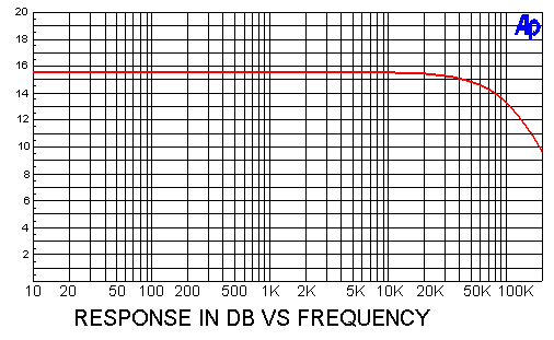

I wonder what is the approximate Vgain of your circuit in first post?
Can one change the gain a bit .. and if so, how?

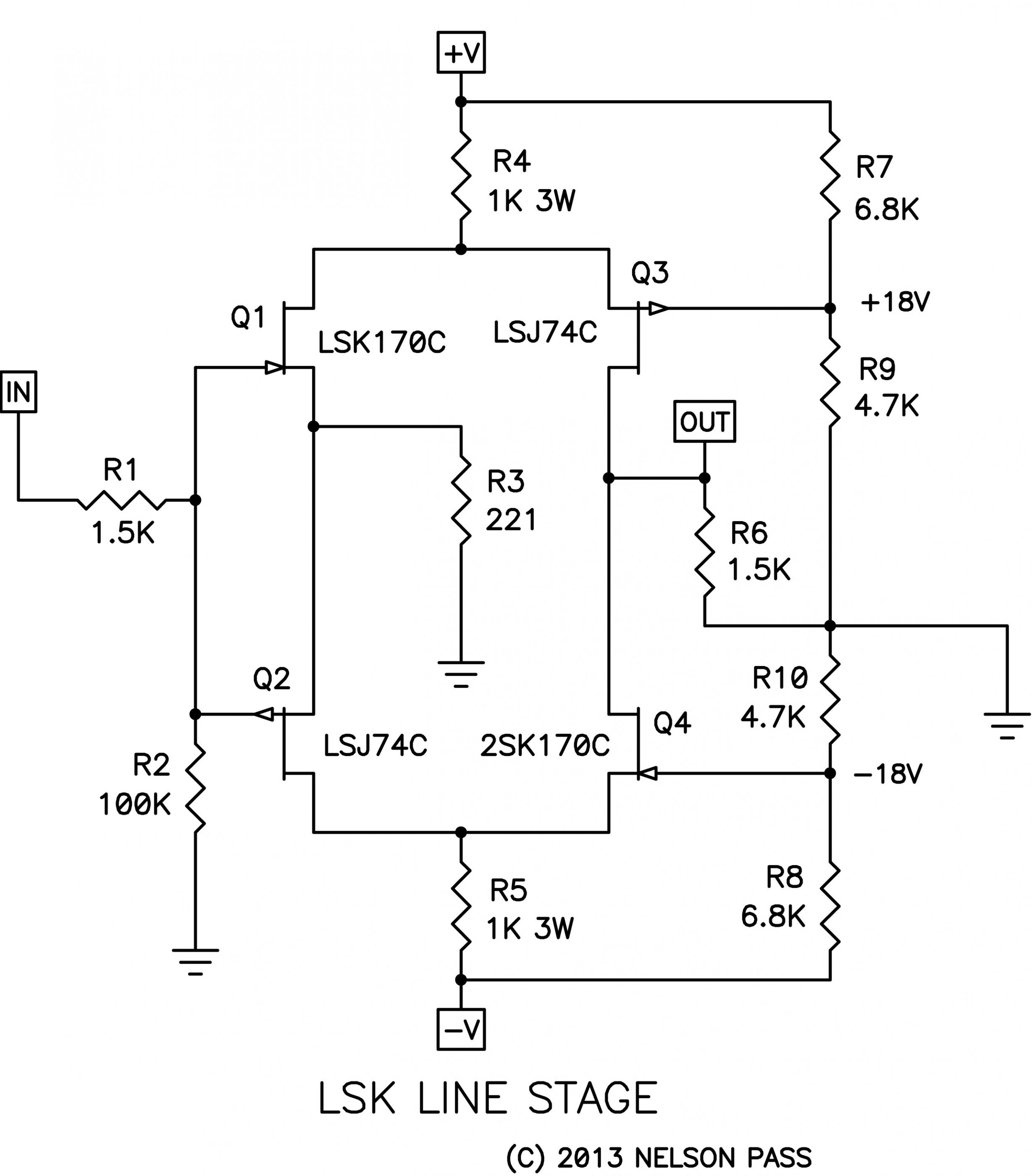

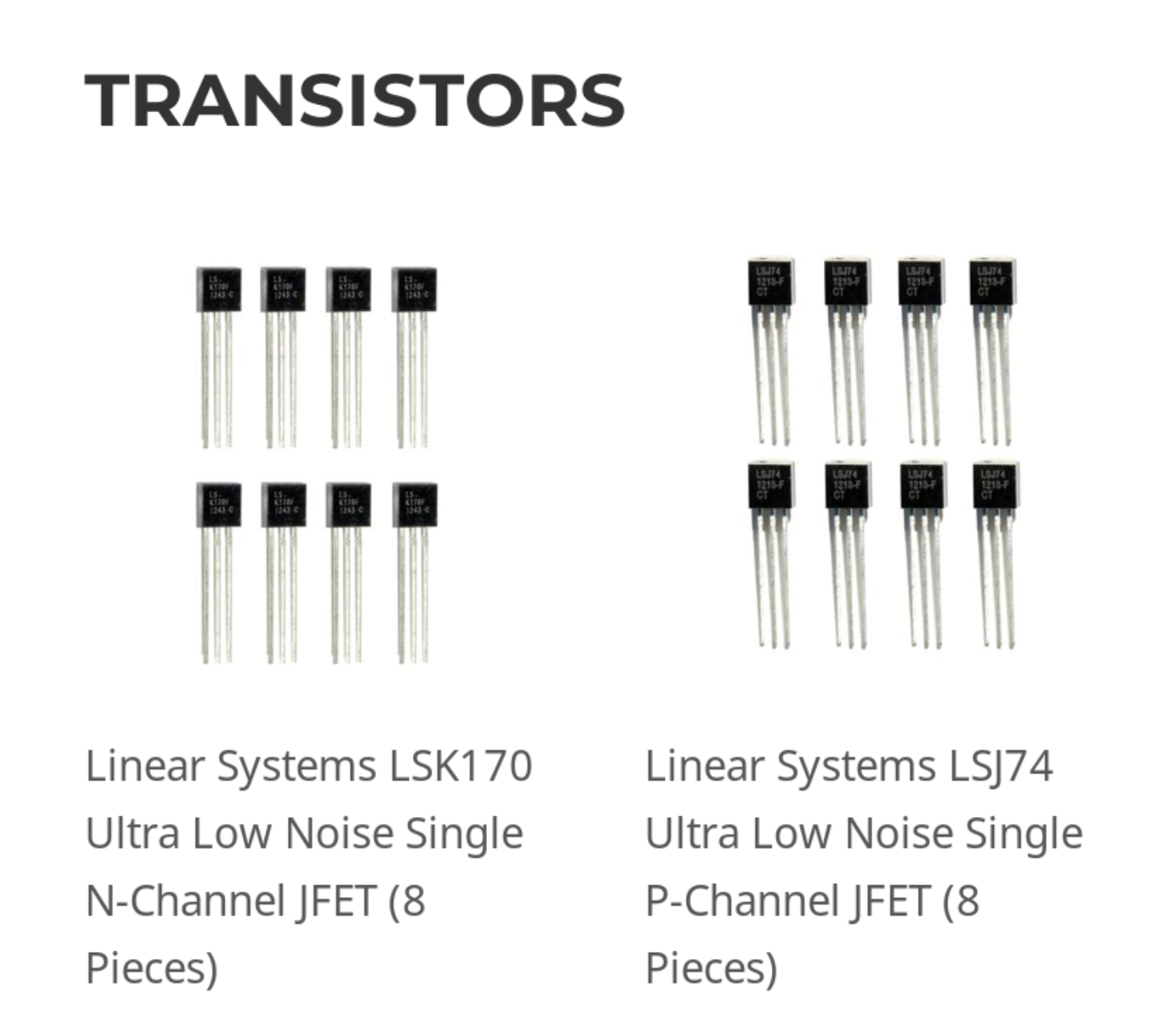

I have another bonehead question. I watched the BAF 2013 video several times over the years since released, but still baffled by the voltage requirements.
Reference schematic for LSK Preamp in first post.
The circuit can run off +/-45v, and the input and cascoded jfets need 30mA.
However, when describing the jfet output buffer to lower output impedance, There's talk about the jfets can only handle around 25v.
Why can the input and cascade jfets handle 45v and the buffer cannot?
I know R4 and R5 provide 30mA
Is there a voltage drop provided by the 1k R4 & R5 that lowers the rail voltage?
Does the jfet themselves and R3 come into play in lowering/adjusting the voltage to another level?
Kirchhoff's Law come into play? All the voltage drops must equal 45v?
see 18V marked ?
these JFets (in post #1) are seeing 18V from D-S
include buffer stage , cascode it regularly to 12-15-18V rails , and you're good
aha ...... I forgot to say - second half JFets - they're having gates clamped to 18V ; source is looking at 1K resistors and they will fight to death to keep source voltage somewhere near 18V too
think how JFet is biased and you'll realize what "somewhere" means
