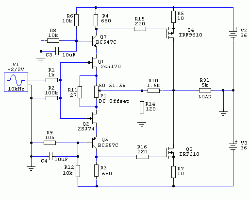

juma-- do you think this preamp would work well built into an F4? and i have a B1 for volume control duty, could i just leave off the 10k pot? how would i implement that ? thanks bubba177
bubba177 said:juma-- do you think this preamp would work well built into an F4? and i have a B1 for volume control duty, could i just leave off the 10k pot? how would i implement that ? thanks bubba177
Not as it is because F4 needs ~22V peak input for full output. F4 already has built in JFET buffer so it doesn't need B1.
In fact, with circuit below you can lose input JFETs from F4 and connect the output of this preamp directly to point where C1 and C2 (F4 sch.) are connected.
thanks juma-- i normally listen to my B1 and F5--when i put in my F4 it plays with the B1 but i wish i had three more clicks on the volume control--i have been looking for something ( gain stage) to install in the F4 and run off of it's 24v rails.
Of course you can run it from 24V rails, but it won't drive F4 to full power. If you can accept that compromise, use 78L18 and 79L18 regs (instead od 7xL12) in circuit from post #53, change R9 to 220 Ohms and you can expect clean ~16V peak output which will suffice for about 32 W/8 Ohms peak (16 W avg.) on F4's output.

juma-circuit from post 53 with the changes mentioned in post 72 is what i use to drive my F4--correct? circuit in post 70 confuses me-i don't even see an output-dumb in missouri ( show me state)
The post #72 refers to circuit in post #53. The changes are intended for driving F4 better with that circuit.
The circuit in post #70 is intended for driving F4 to full power. It should have higher PSU (+/- 32 to 36V). Its ouput is taken from MOSFETs' drains. R31(5K) is not the part of the circuit - it just represents the load i.e. the amp that it is driving.
