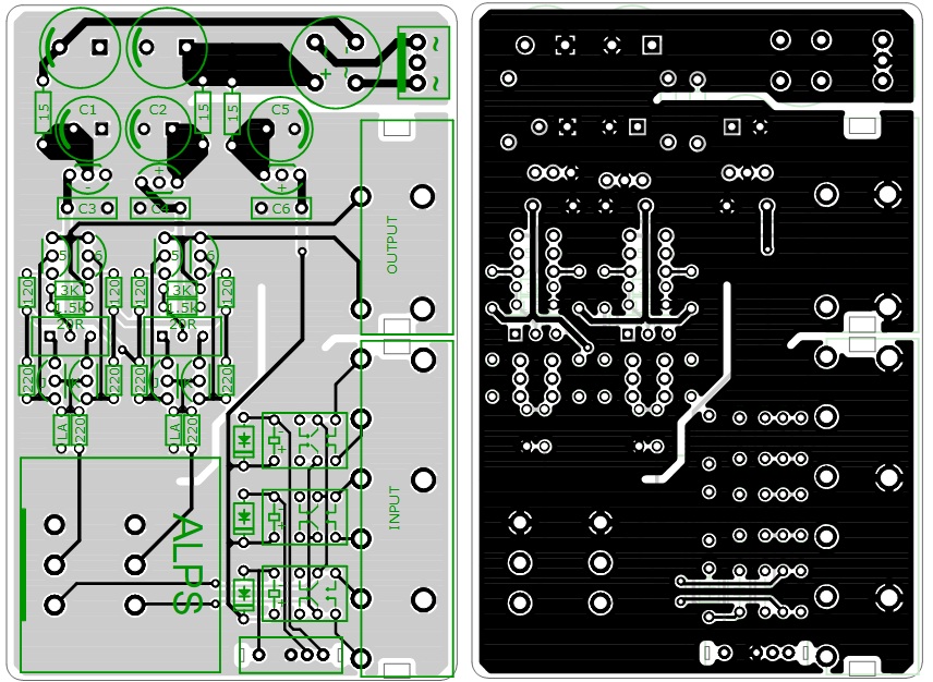

Using juma's post 53rd schematic to draw a buffer with input selectors. Hope he don't mind😉 The size is 56 X 85 mm.
I am curious that should I put each 0.1uF on the voltage rail near to the buffer? Or just one unit 0.1uF on the PSU is enough. 78L05 regulator feeding G6K-2P-5VDC relay with 1n4001, I doubting will this work nicely? 😕

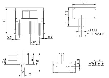

I am using SK-13D07 slider for selecting input. I wonder if the connections correct compare to datasheet 😱
