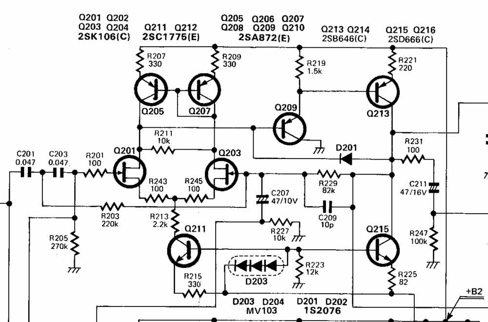

anyway - here is just as illustration - HK725 , discrete OP with Jfet input ;
possible to use whatever is in drawer

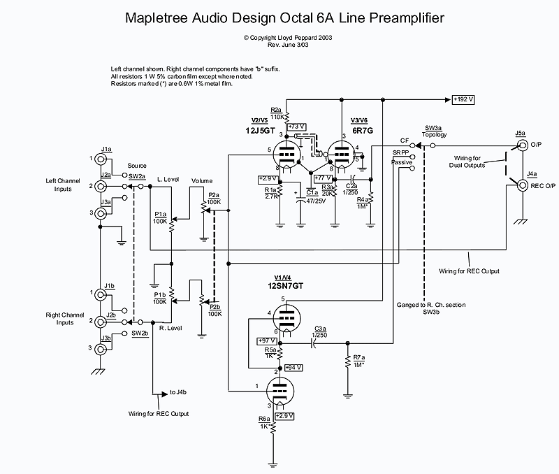

Here is another idea that I've been playing with. It's based on J. Broskie's Aikido tube design. I used FETs that are cheap and abundant.
no P-channel FETs needed, and IMHO, it sounds good 🙂
Heve you ever tried using JFET like Tubes, but in SRPP arrangement ?
It uses almost the input stage of your posted circuit.
But Instead of upper NJFET is pure current source, CCS,
it should be coupled as SRPP ( Shunt Regulated Push Pull ).
SRPP is frequently used in Tube Preamplifier stages.
They are a kind of PUSH-PULL, but with two N-polarity devices.
Because of the similarity between JFEts and Valves
we can try Shunt Rgulated Push Pull for JFET, too.
See my Attachment of a line amplifier.
The bottom 2 tubes are in SRPP.
This gives lower distortion than using your circuit.
But only if you can find one SWEET SPOT, for Shunt Reg Push-Pull.
This sweet spot should be arranged and setup while condering The Load impedance as one parmeter.
At least this is what I read about it 😎
Lineup

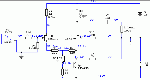

Bored by a rainy day I decided to try JFET-CCS-BOSOZ (schematics in attachment) as a preamp for F5. Yes, it has 1k Zout, but that's without significance when driving F5 (100k Zin).
2SK170 are of V type (12mA Idss). CCS gives 20mA. Gain is 6dB (2V/V).
+/- 18V PS is made from F5's PS by means of 7818 and 7918.
Output cap is 1uF MKP + 100nFMKS and it doesn't leave any imprint that I'm aware of.
Preamp is very neutral, nothing is changed in music presentation compared to F5 without preamp, signal is just amplified to level that drives F5 to full power.
I don't know if I like this preamp more than previous one, it's in nuances, so it will take more listening to make a decision. Anyway, circuit is simple, parts are easily obtainable, topology is nice, F5 is light load, it's simple enough to make it p2p, and this preamp sounds better than its' cousin with MOSFETs - what more could a man want to give it a try ? 🙂

Edit: So, one question about this one: http://www.diyaudio.com/forums/attachment.php?s=&postid=1613044&stamp=1221762706
Do I have to match the SK170 to pairs for this... ?
