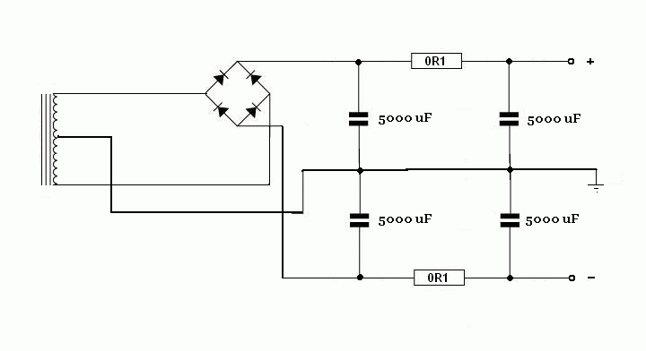

Another detail, even a very low ground loop noise would reduce a lot the sound qualities of your Aksa amp, so even wen you don't ear hum and buzz noises, there is a loss of sound qualities wen there is a ground loop.

The AKSA uses a floating earth with back to back diodes and a 10R resistor. Only fb shunt cap, input bias resistor and input ground are floated, the remaining grounds are taken to Star Earth.
This is a conventional, widely used earthing schema with proven credentials.
I cannot understand why there should be a mismatch between the AKSA and the Benchmark, particularly if the Star Earth on the AKSA is correctly floated to mains earth via more back to back diodes and a 10R resistor, as supplied.

Do you have a wire from Star earth to mains ground via back to back diodes and the 10R resistor (I believe I supplied it with the modules).

If you still have hum problem, you really should do that important modification that I've described in this #43 post;
http://www.diyaudio.com/forums/aksa/151644-preamp-aksa-55-a-5.html#post1953640
You will alway have hum problems if you don't correct that ground loop problem in your input wires.

All amps and preamps could be sensitive to mains noise, sometime the noise on the main can be very strong, here I have a neighbour who use very bad electrical tools and those tools are so noisy that TV become fuzy, but my amp do have a RF filter and Pi filter in the power supply and nothing get in my amp. But my ground and well made and my amp are dead silent.
Have you try a Pi filter in you Aksa power supply, like this one ?
