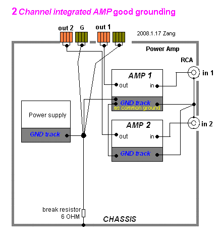

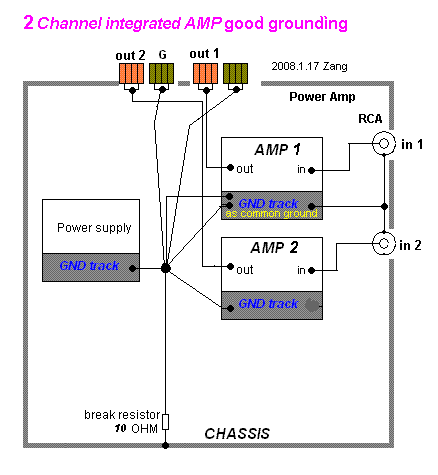

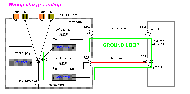

Hello Kenji
Please, don't blame the Aksa amp, I know this amp and never it would do any hum and buzzing.
You just have a ground problem, maby cause by your wires connection, have you check all wires and the 10 ohm ground lift resistor ?
Be sure that your Aksa amp input wires ground are connect at one end only to the amp ground, if you connect both end of the input wire ground you will have a ground loop.
Those ground problems will bring hum and buzzing wen you connect your amp to most brand of preamps.
Bye

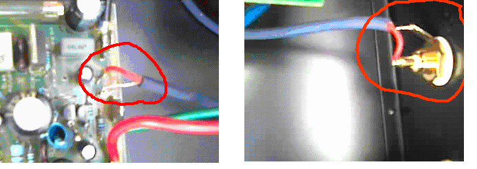

Hi Kenji,
Can you take a big and clean close photo of the inside of your Aksa amp and show it here, so we could see all the inside of your amp and maby find the problems.
Bye
Gaetan

Hello Kenji,
I have lot of amps in my life, my best was a Crimson and a Radford, but the Aksa amp was sounding much better than those two amps.
A years ago, in the Montreal Audio Show, I did listen to many many high prices amps, only few very costly amps, like a VTL tube amp costing $15,000, was sounding as good as the Aksa.
Wen the Aksa are properly assemble and connected it sound with a 3D and life-like sound that we can really call magic.
Did you look a my second diagram ?
Even a very short ground loop wil do hum and buzzing.
Don't forget to show us the photo I've ask you.
Bye
Gaetan

The standard way of connecting, as per instructions, work fine with my AKSAs. A single star earth with lift resistors on each PCB, but on your system could be different to normal.
When I have my AKSA connected directly to my source (no preamp) it is very quite. Conecting a tube preamp introduces a very small amount of hum that is not usually noticeable. I have tried a couple of cheap DVDs (double insulated) as sources and these caused servere hum when not playing music. Luckily my CD player and Transporter are very quite.
When looking for ground loops you need to look at your entire system not only each piece of equipment. Remember the safety earths are usually connecting all your eqipment's earths together back at the GPO. Look for any equipment that is connected to a different earth potential.
You need to consider if DIY is for you. If you are losing lots of sleep, it might be better to cut your losses and move on.
A good picture of the inside of your amp would be extremely useful.
Bye
Gaetan
Hello Gaetan,
here is a video I made which shows the inside:
Download Video.mp4 from Sendspace.com - send big files the easy way
Hello Gaetan,
Hello
Your video of your Aksa amp are interesting, you go a bit fast but I still can see few things. A photo showing all the inside of the amp in one close shoot would be usefull.
All your wires routing are not very good. Power supply wires should be keep short and you should twist them and put them away from input wires and input section of the pbc.
You have a ground loop wen you connect your Aksa amp to a preamp.
I have extract two frames of your video, and circle the problems.
You use insulator on your RCA, that is ok, but you connected the input wires ground at both end, wen you will connect most preamps you will have a ground loop.
Look at the photos of your amps input wire and look a the two diagrams.
You can see in the first diagram that there is a ground loop wen a preamp are connect to your amp.
You should do as the second diagram.
