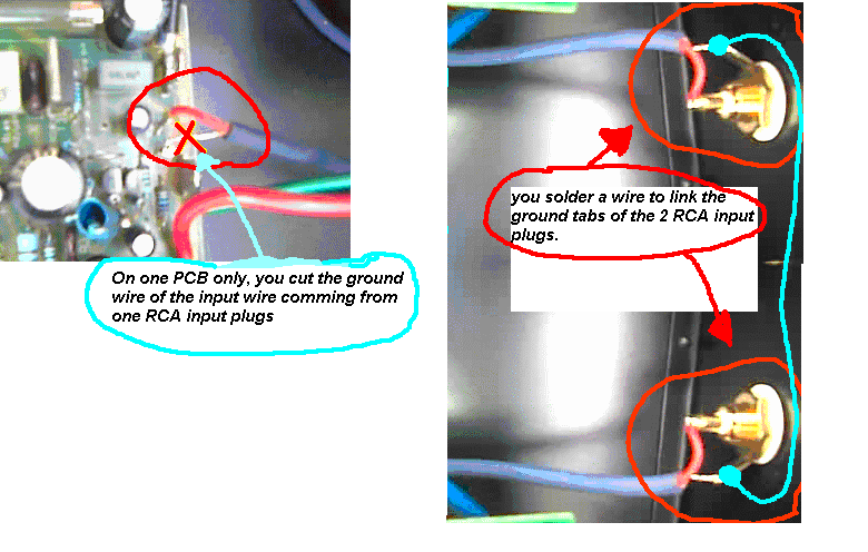

ok thanks for that. Can I ask if a groud loop existed and I were to connect just one input on the amp, would the hum disappear?
Gaetan,
Many thanks, you have done Kenji (and other Aspen owners!) a great service.
Kenji,
If you connect just one channel to the preamp, and all is quiet, and hum appears when you connect the second channel, then yes, you have a ground loop through the preamp.
In this situation you need only disconnect the signal ground at the pcb on ONE channel.
If this works, you have identified and solved the problem.
Again, thanks to Gaetan!
Hugh
Hello Kenji
Do as Hugh suggested. "If you connect just one channel to the preamp, and all is quiet, and hum appears when you connect the second channel, then yes, you have a ground loop through the preamp."
Now, if it is a ground loop, since a ground link on the 2 RCA input plugs
would be good and made your amp work good and quiet with any preamp connected to the amp, you need to do as I describe on the photo I've done.
On one PCB only, you cut the ground wire of the input wire comming from one RCA input plugs, after that you solder a wire to link the ground tabs of the 2 RCA input plugs.
After those mods, you can check again with the preamp connected to your amp to ear if all is quiet and there is no hum.
I'm french speaking, so I hope my english explanation are ok.
Bye
Gaetan

The standard way of connecting, as per instructions, work fine with my AKSAs. A single star earth with lift resistors on each PCB, but on your system could be different to normal.
When I have my AKSA connected directly to my source (no preamp) it is very quite. Conecting a tube preamp introduces a very small amount of hum that is not usually noticeable. I have tried a couple of cheap DVDs (double insulated) as sources and these caused servere hum when not playing music. Luckily my CD player and Transporter are very quite.
When looking for ground loops you need to look at your entire system not only each piece of equipment. Remember the safety earths are usually connecting all your eqipment's earths together back at the GPO. Look for any equipment that is connected to a different earth potential.
What you say is the same thing I've experienced, where some sources are dead quiet and others hum badly. Does this suggest it is something to do with the design?
Why do the instructions tell me to connect both channel pcbs to the rca ground yet Gaetan advises me to disconnect one and link the rcas together? I am confused.

Hello again Kenji
Not all preamps and cd players do have the same types of grounds connections, so some will do a ground loop with your Aksa amp.
You need to disconnect one input wire ground on the pcboard because it will break the ground loop, and you need link the rcas plugs together because somes preamps and cd players will not have the ground connection link the way it need to have both channel playing.
Look at my post #43
PLEASE Kenji, will you have some confidence in us, since me, Hugh, Bigun, Nico, and AndrewT, we have lot of experience in diy projects, why would we want to confuse you, we just want to help you !!
If you still turn arround like that, allmost nobody will want to help you again !!!
Bye
Gaetan
