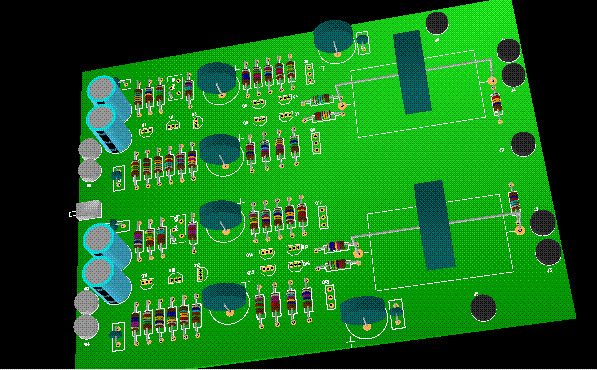

Hello!
Here is my version of dispre PCB😀 😀 😀
Any comments? Every suggestion will be welcomed!!!!
PMA said:
I am thinking about building a new preamp. The concept is shown in the attached image.
It is of interest, perhaps, that, contrary to popular opinion, your preamplifier's second stage is a severely unbalanced differential amplifier and not the common-base element of a complementary cascode.
This imbalance is responsible for the relatively poor forward gain obtained with this arrangement.
Re: Re: Preamp concept
Michael,
you are absolutely right. And you are also right that it is not much of interest for me, i.e. I am not going to modify it at all. This preamp had covered a kind of "social demand" 😉
Pavel
