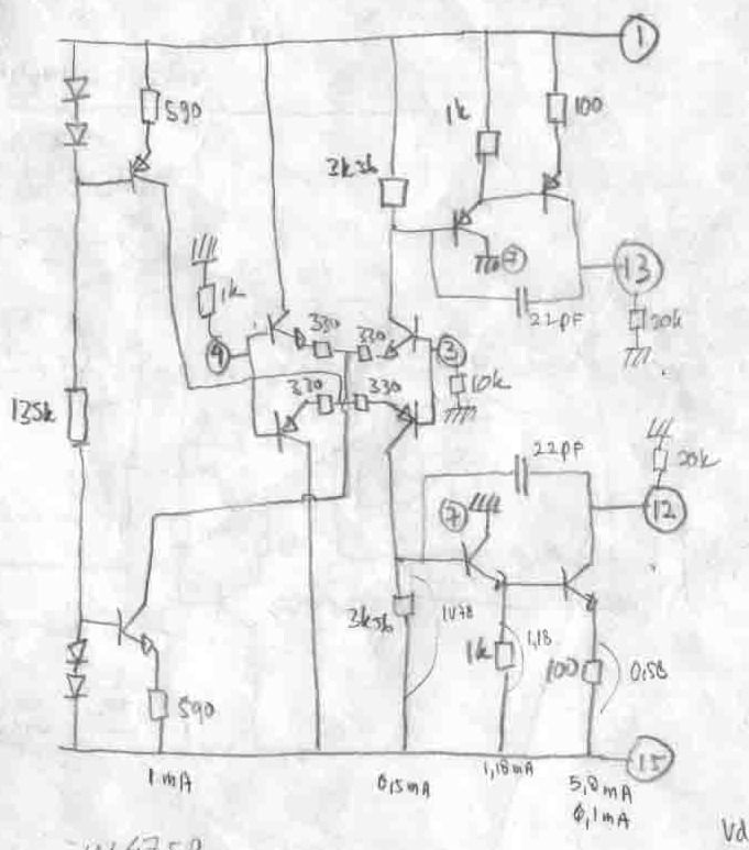

A600
Hi: Can someone help me out with the schematics of the PP A600? U7, an integrated circuit on a ceramic board has been damaged because the ceramic board cracked. I plan to repair this by making another circuit board but I don't have the resistor and capacitor values. I emailed PP about this but they replied that the design is proprietary and that they only do servicing of their units in-house. Such a pity, considering that Soundstream Technologies readily gave me a copy of the schematics of their USA204 amp.
Re: A600
There are no schematics for those anyway. The best you can do is try and figure it out by probing the other board, or find a blown amp that still has a good hybrid board that you can replace your bad one with.
razirafi said:Hi: Can someone help me out with the schematics of the PP A600? U7, an integrated circuit on a ceramic board has been damaged because the ceramic board cracked. I plan to repair this by making another circuit board but I don't have the resistor and capacitor values. I emailed PP about this but they replied that the design is proprietary and that they only do servicing of their units in-house. Such a pity, considering that Soundstream Technologies readily gave me a copy of the schematics of their USA204 amp.
TO-3:
Thank you for the info. Since there is no schematic for this, I'll go about it the DIY way.
lumanauw:
Thank you for the diagram. It sure will help me get started quickly.

razirafi said:TO-3:
lumanauw:
justonemoreamp:
I can't send you an email via your email link because my account is still under moderation.
If you cannot fix it, I would definately talk to justonemoreamp. He will be able to help you out.
