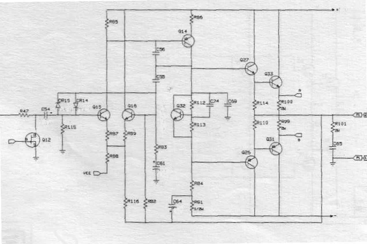

profuse007 said:for now, i dont care about signals right now, am just looking at the power switch source. what are the things i should be concerning besides replacing the mosfets?
the quote in bold, are you talkin about the physical drivers like subwoofers?
Here is a simple main and output section of an amplifier. Q26 and Q27 are the driver transitors. These are in a Darlington Pair with the output transistors. They are called drivers because they are current boosters for the outputs.
