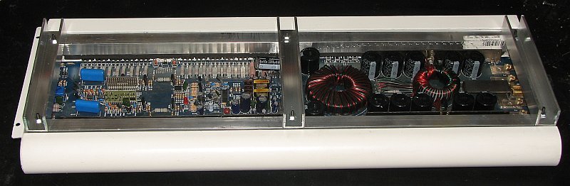

I have a 2150AM with blown power supply fets and all of my gate resistors read about 475 ohms each. That is .475 k ohms according to the meter. I see you talking about replacing them with 47 ohm resistors when swapping to the z44's, that seems kind of low for using on the gate of a mosfet, unless the switching IC is made to handle that load??? I just want to be sure of which gate resistors to use, since I plan on going with the plan of using the IRFZ44 mosfets..
No, 470 ohms is too high for a MosFet gate. There is no reason for these to be that high. MosFets draw nanomamperes on the gate pins - you're confusing them with regular bipolar transistors. You are most concerned with switching the FET on and off quickly. Even 47 ohms is high, but a good replacement, especially with the newer breed of MosFets. BTW, just move up to IRFZ48V and skip the Z44 - it has better peak current characteristics.
If I'm not mistaken, the 'AM' amplifiers used a transformer to drive the FETs. This would allow the use of a much higher value gate resistor. With a transformer, the gate drive of one bank will be at -3v before the others begin to turn on.
I'd try the new FETs with the original gate resistors but watch the temperature of the FETs. If they seem to be running hot, you may want to try reducing the value of the resistors. Unless someone with more experience can suggest a value, I'd go to 220 ohms (but only if there seems to be a problem).
Perry Babin said:If I'm not mistaken, the 'AM' amplifiers used a transformer to drive the FETs. This would allow the use of a much higher value gate resistor. With a transformer, the gate drive of one bank will be at -3v before the others begin to turn on.
Yes and no. While there is a transformer in the gate circuit, it is not a gate drive transformer. It is merely a common-mode filter (there is no secondary).
While your method seems OK for most amps, remember that the PPI amp bottom lid also serves as the transistor clamps. I don't recommend operating the amplifier without the lid attached unless you made a mechanical jig specifically for the purpose of troubleshooting of those amplifiers.
If that's the case and that's not a transformer, he definitely needs to go down to 100 ohms or less for the Z44s.
I assumed that he knew that he had to have the bottom cover in place (he's likely seen several of the other PPI repair threads). You can monitor the temperature through the heatsink. Generally, if the power supply end gets hot faster than the audio end, there's a serious problem. Some of the old Orions had a problem with the power supply heating up faster than the audio section.

I've learned (the hard way) that 100ohm is much too big for IRFZ44. It will make cross conduction, making the whole SMPS mosfets blows up the whole set again and again. Better use 47ohm for IRFZ44's Rg.
100 ohm resistors are used with Z44s in a very large percentage of amplifiers. I'd probably use ~68 ohm resistors but 100 ohm should work.

Wow, I really opened a can of worms with that question. Yeah Perry, I might just use the z48v's like the ones I had to replace in the audiobahn.
First off, the original gate resistors on the ppi are 475 ohms. They are yellow(4), purple(7), brown(0), and the tolerance band is gold (5%). I'm pretty sure I'm not confusing bipolars with fets. I understand how sensitive most fets are at the gate, what I don't understand is how I can drop from a 470-475 ohm resistor to a 47 or even 22. That is quite a large jump. What in the architecture of a z44 for example makes the gate lead different than the original 25no5e's?
Brown is 1. 🙂
They were 470 ohms. 475 ohms would have had another band (yellow, violet, green, black, brown).
I tried to find the datasheet for the 25n05 but wasn't successful. I'd guess that a very low input capacitance and a lot of dead time allowed them to work with the 470 ohm resistors. I've only seen one other amp use values over 100 ohms (as far as I can remember). 10-100 ohms are the most common.
If you use Z48s, you need to use 47 ohm resistors (that's my suggestion anyway).

The 25N05E is a 50V 25Ampere device. A direct replacement for this obsolete device is an IRFZ34N. It's possible that PPI was intentionally trying to slow the turn-on of these FETs to reduce dv/dt - but I can't state that with any sort of proof. Who knows - maybe that is what the manufacturer of the FET recommended? Remember, this was at a time when using MosFets in the power supply was new. Maybe their research led them to believe that was a good thing.
Looking at the schematic...the dead time resistor is indeed 100 ohms.

Yeah Perry, I was using the resistor color code wheel and it read 470, that is where I got the value from. The meter also read .470-.475k. (I wish it would just read 470 ohms but it doesn't have that range for some reason) The reason I said 470-475 ohms may be because my meter leads are crapping out, so sometimes it will fluctuate a little, but it could also be because of the 5% tolerance allowing the slight variance.
I still don't understand the reason for the metal can transistor guy saying the original gate resistors were 47 ohms..
Envision... where is the dead time resistor you're talking about located? And what is the exact reason they used the transformer/inductor between the two sets of gate resistors? Kind of interesting
I've also already ordered the z44 resistors, so which would be the optimum resistor to use at the gate now? Also, would it be a good idea to find some 1% tolerance resistors? Thanks for the help

The exact reason? I'd have to build their circuit to find out, but I think it's designed to reject common mode noise that might trigger both phases of the FET bank at the same time causing shoot-through. The schematic also shows a third winding connected to ground, bypassed with a 220uF cap to +12V to ostensibly reduce flux density in the core during dead time.
I have to admit - I've never seen this used before since the 3525 IC includes exclusive-OR logic lockouts to prevent double triggering of the outputs. Somebody must have thought it was a good idea, but it is obviously less of an issue that, say, transformer saturation or flux walking of a push-pull design; two mechanisms that definitely contribute to the cause of blown FETs.
The dead-time resistor is connected between pins 7 and 5 of the SG3525AN IC.

Hi, Perry,
You're right, I forgot to include the dead time factor of the PWM IC. If the dead time is adjusted, 100ohm may be OK. My bad experience with 100ohm Rg on IRFZ44 is not with SG3525, but with TL494 with 0V at pin4.
Long time ago, I calculated the optimum Rg for IRFZ44 (with the formula found in one SMPS handbook, it turns to be about 12ohm. But practically, the totempole curent of the driver will be too big.
It is the discharge when OFF that makes the problem with too big Rg. IRFZ48 has bigger gate charge than IRFZ44, it will have different optimum Rg than IRFZ44.

Well I have the irfz44s on the way and some 100 ohm 1% tolerance resistors. Hopefully that is the right combo
awesome
Okay, got all the z44's and gate resistors in. Double checked the outputs and found one bad 6490. Luckily I had a bag of them I ordered a couple of years ago and never used. Unfortunately I have no way to match them to the originals as far as hfe is concerned. Luckily, regular transistors are more forgiving than fets. I installed one of the new 6490's (central semi) and got it all regreased. So far, it works perfectly. I don't hear any unusual turn on or turn off noises either. The output section is getting warm at low power levels and the power supply fets aren't even making the sink warm to the touch. 😀 I'm currently running it at a 2 ohm mono load (yeah I know, not optimum) at a pretty low volume level to warm it up. If it can handle this stress test, it will surely do well at 2 ohms stereo. I'm glad the amps I love all have normal transistors for the output sections!
Thanks a lot for the help, guys! My friend is going to love this amp, he's never had a ppi and its going to make his four eclipse 6.5's shine like he's never heard. 🙂 I hope he can truly appreciate the improved sound.
Update: Now that the amp has been running a little while I've swapped it to a 4 ohm load and the heatsink is staying about 115 farenheit. Looking good so far.🙂
