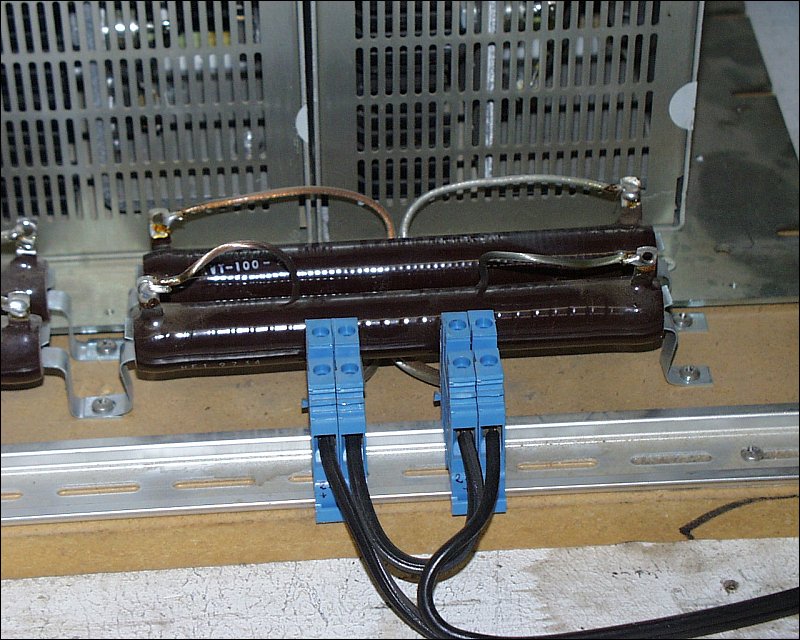

As a note, I use a 2A 12v laptop supply with a peddle and pulse the peddle to build rail voltage watching the scope closely. If there are any shorts anywhere in the amp it shuts down my supply. I can power up almost any amp with this method.
A 100w 2 ohm resistor (looks like the ones in the photo) on a full current power supply will give the most consistent results and won't shut down which allows low-voltage troubleshooting when an amp is struggling to power up. I have current limited supplies and after trying them over the resistor, I always went back to the resistor. The footswitch works well but I only use it in parallel with the remote switch on my power switching box.

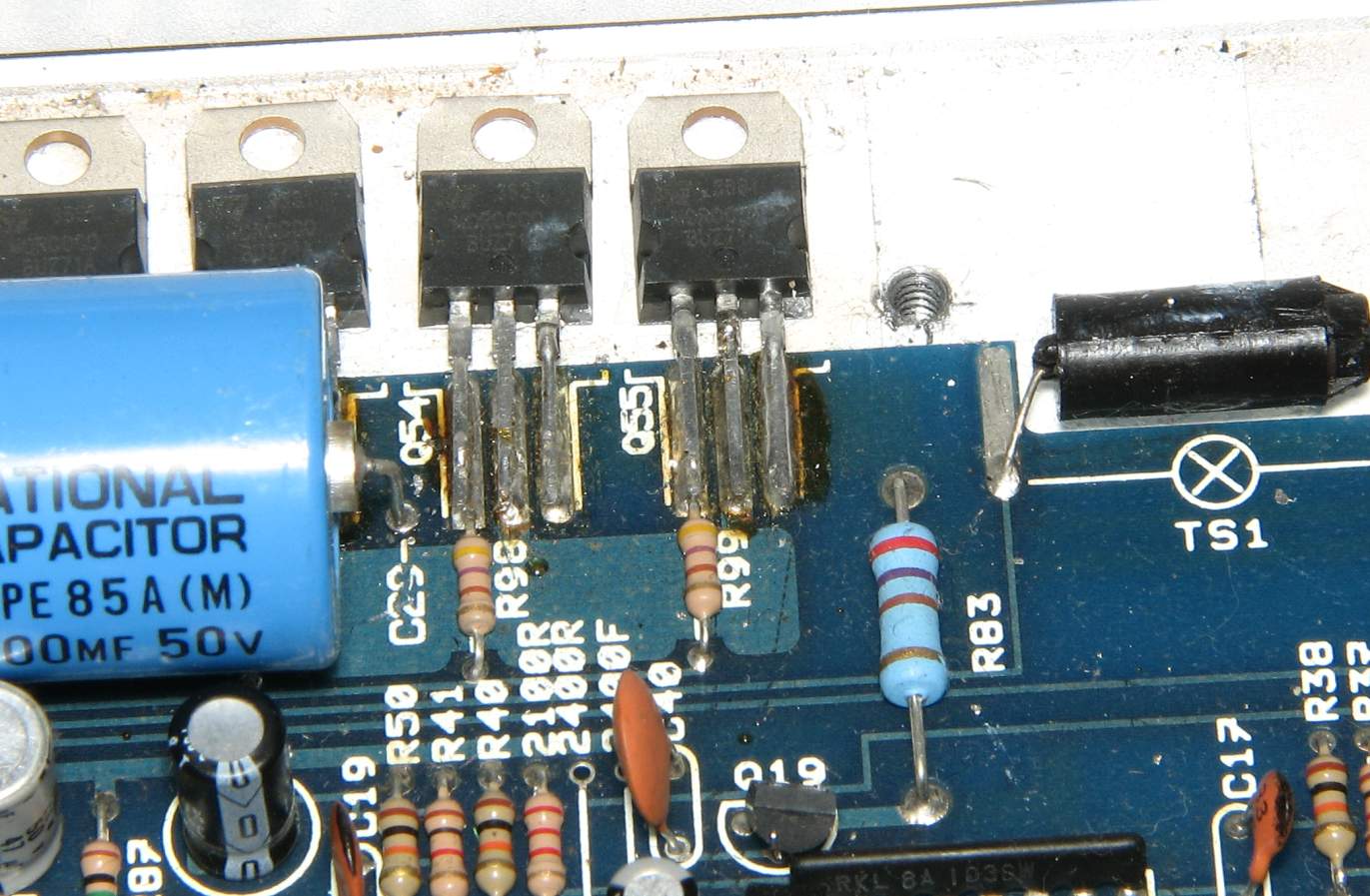

What's getting hot (of the heatsink mounted components) when you try to power up the amp?

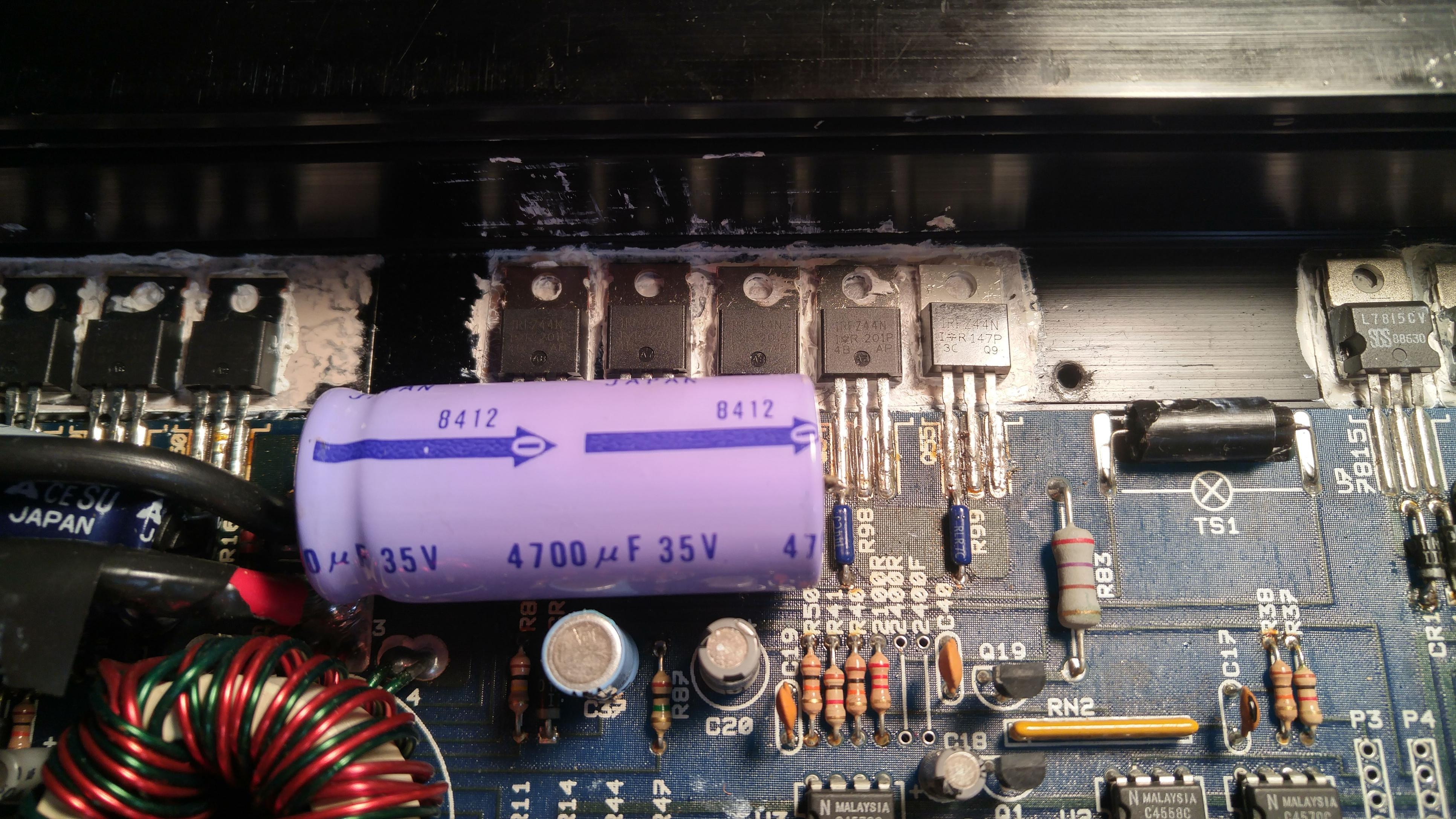

Just tried it again, left it on for about 15 seconds.. Feels like Q55 is what is getting hot.

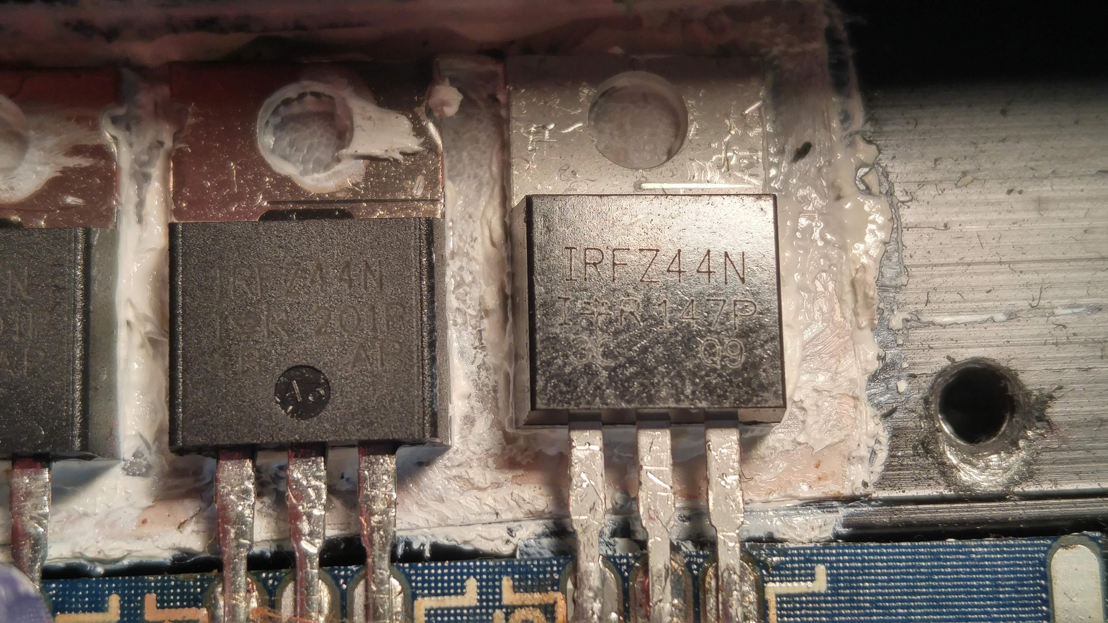

I think this is one of the parts I changed twice already.. It looks to be a different "batch" than the others. The (what I think is) the date code is different on that one.

You can remove this transistor for testing. Before you can return the amp to service, you have to change all 5 transistors in the bank with the odd FET. They have to be relatively closely matched. Having them all from the same production batch is close enough. The FETs in a single bank (two banks of 5 in this power supply) must match. The FETs from one bank don't have to match the other bank but you should not reuse FETs that were in the amp when any of the FETs fail.
