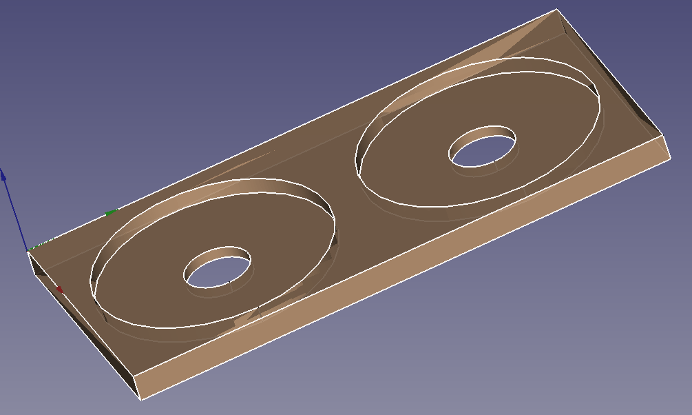

Screenprint attached.
(The design was modelled as shown simply so that the impedance, pressure and velocity results given in Post #51 could be readily found).

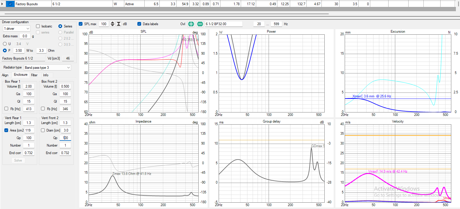

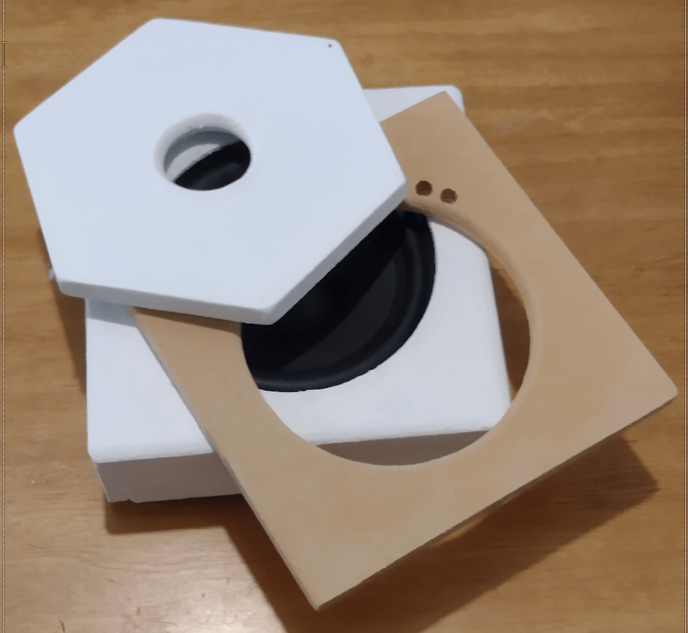

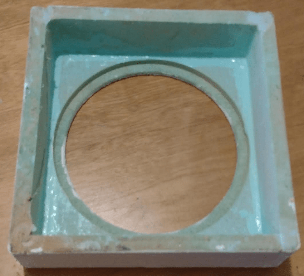

I have 4 6-1/2 speakers and I'd like to test them. I did a Ripole prototype with cardboard and I found it interesting that I liked it. So now I'll move to wood. This is for music.
I know the best way to simulate this is in Hornresp but I have to learn it. I'm using a 6th order band-pass simulation to get the max power for x-max and vent speed. I know this doesn't measure room response but I'll just copy the general shape, make it heavy and see what happens. I'll share the measurements.
I find it interesting that the front port can be just ⌀3cm (15m/s front port air velocity) or ⌀3.5cm (11m/s front port air velocity) according to this simulation.
Remember I know this doesn't measure room response... But I'm wondering how to interpret how the phase changes when I change port sizes, should optimize for a given phase for a target frequency? The data on top is what I measured for this driver and I'm attaching the measurements.

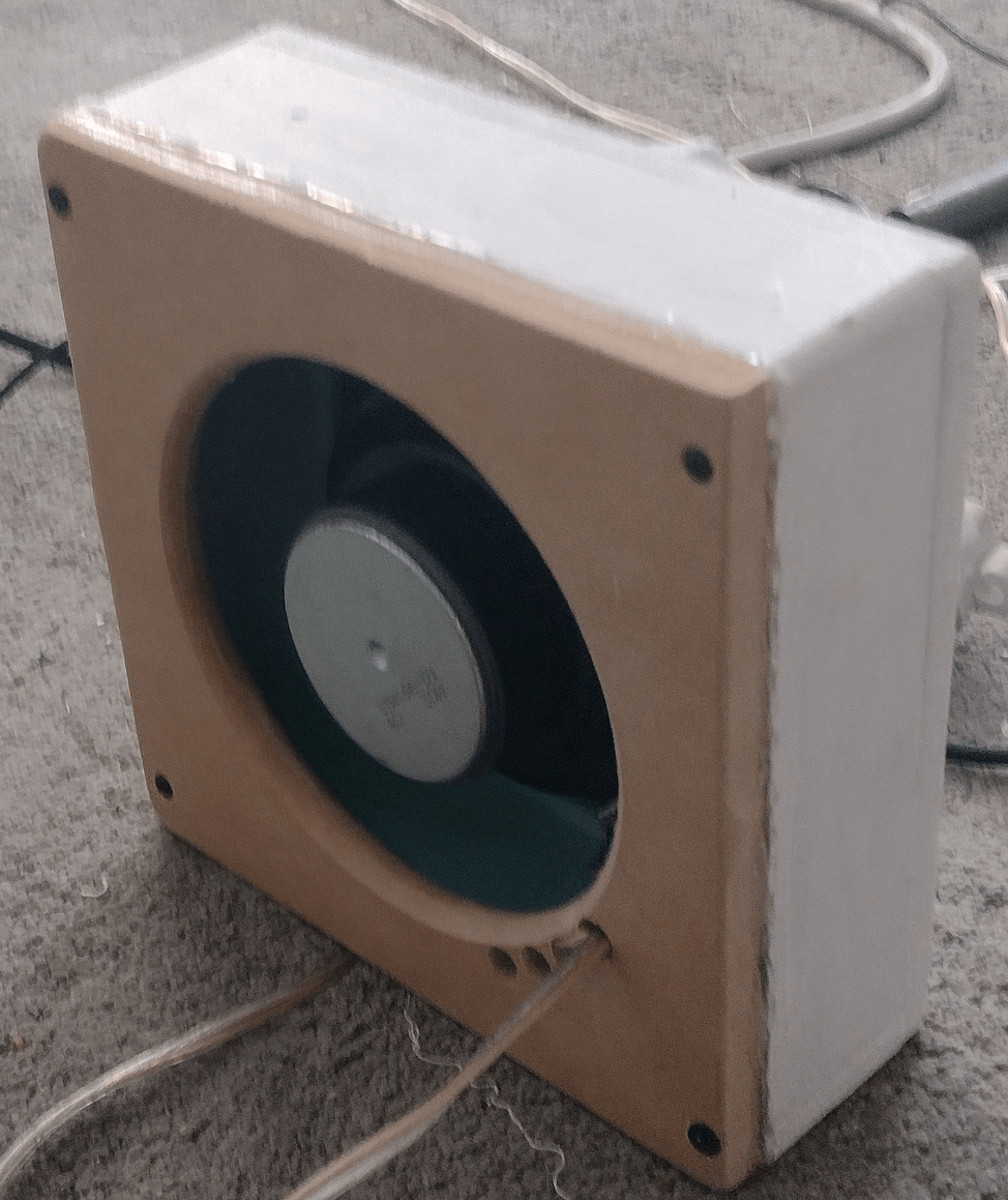

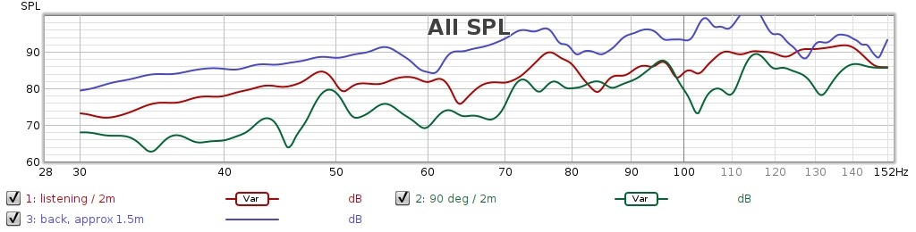

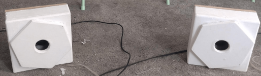

Hi there. I built them. I need to build the other two.

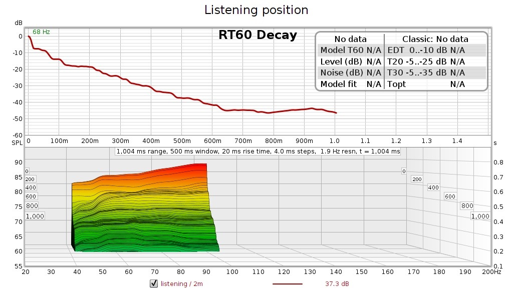

The measurements are from the two baffles. I could get better measurements later if needed.

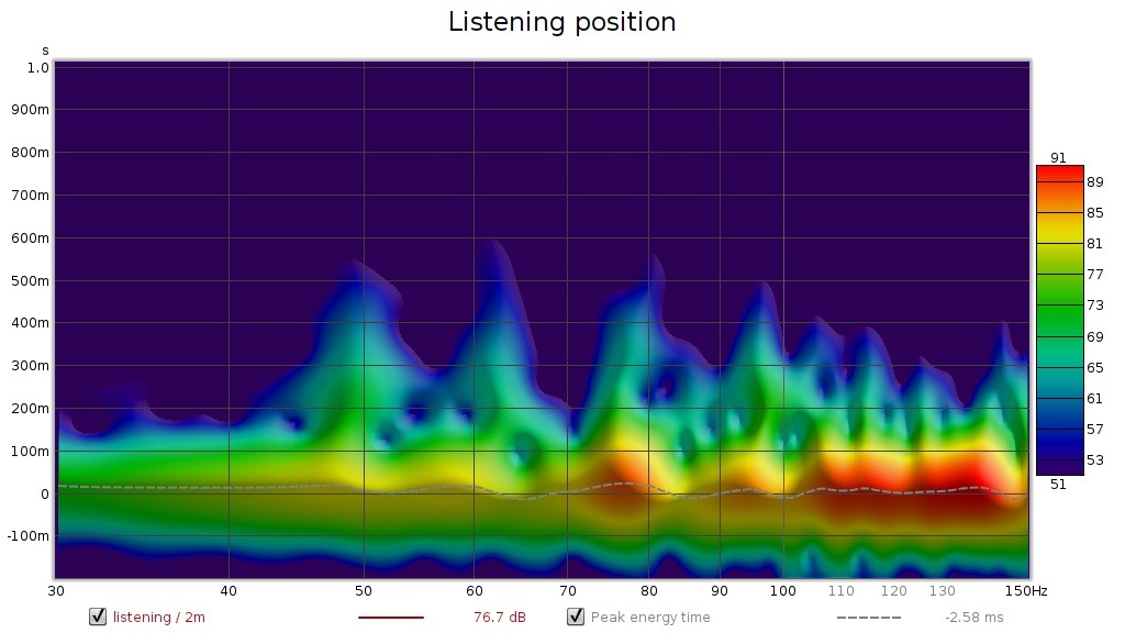

Red is from listening position, about 2m from them, 0 deg. Blue is from the back and it has more SPL, the mic was about 1m closer and also closer to the wall. I didn't want to move them for this quick measurement. Green is at 90 deg, 2m.
I don't listen loud, I'll see what I can get when I put the low pass. But I guess I'll build the other two and at some point move to bigger drivers.
