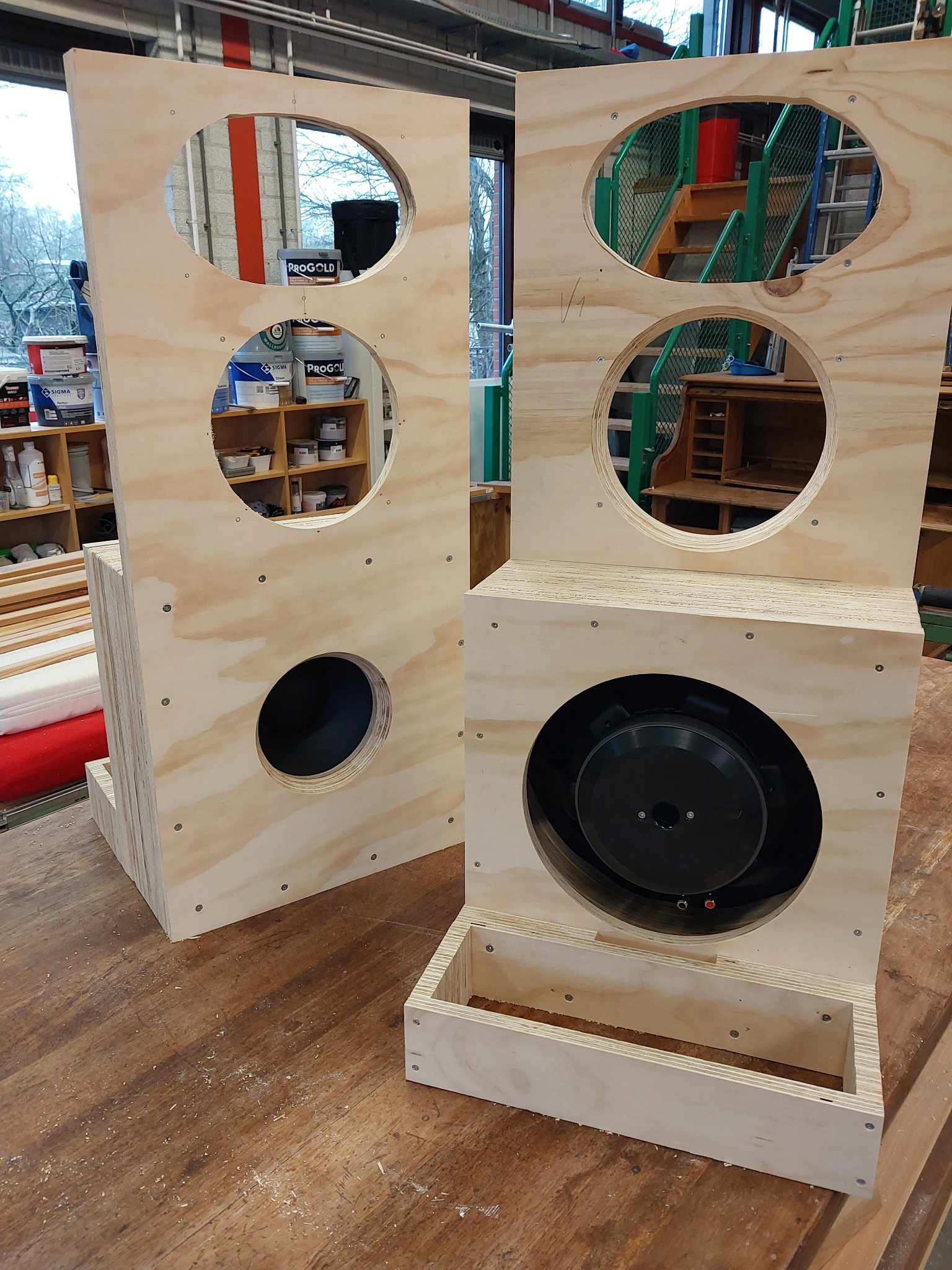

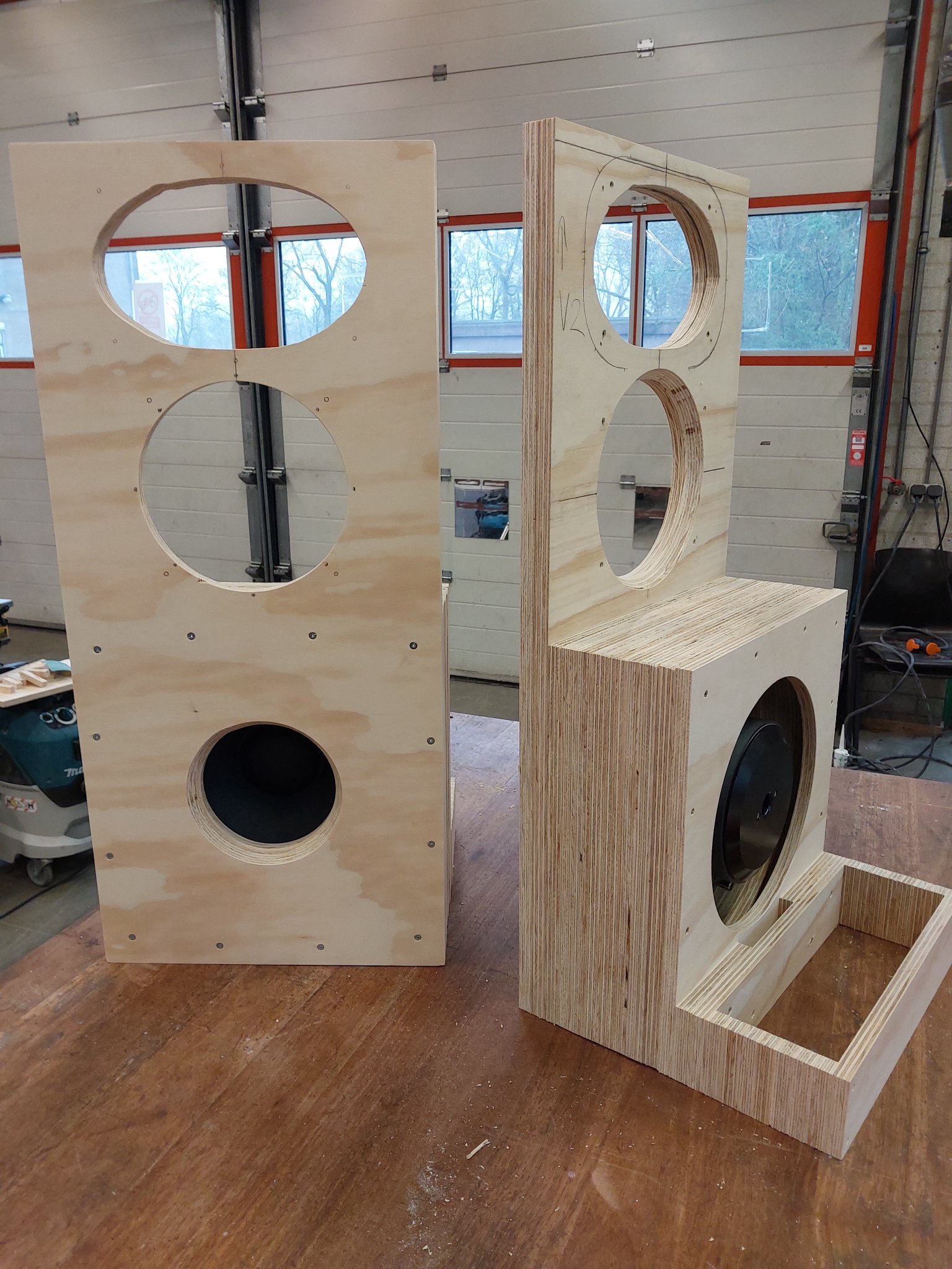

I have finished my test cabs for the PPD sub with integrated baffle for low-mid and horn.
In the bottem on the back the Hypex FA503 amps with dsp will be placed.
Next step is mounting the drivers and amps and have some measurements for crossover and tuning.
Woofer is Precision Devices PD.153C002
Mid 18 sound 10NMBA520
Horn with CD Beyma CP755ND Al

Any measurements / listening impressions yet?I have finished my test cabs for the PPD sub with integrated baffle for low-mid and horn.
Yes
Listening impressions are quite good.
As with open baffle woofers the PPD need boosting to keep up with mid and high, but that is normal.
There is more extended low-end (below 40hz). That was what i was hoping for. Although i am still tuning the system i am quitte happy with the results at this point.
I have made the PPD part of a 3way loudspeaker.
The midwoofer is open baffle. So it lacks some low end. I have the crossover between PPD and mid LR2 at 150hz. That works very well.
Bass is very good articulated. Fast, very good definition. You can hear the different tones very well apart. Also in the lowest regions.
Better than my Faital 15P400 in the OBL-15 open baffle.
I am considering to place the mid in a closed housing to improve the 80-150hz level. Not sure yet. The horn is next level... very very good.
Crossover from mid to horn is now LR2 1300Hz. Also used 850Hz. Both have different sonic signature. Not decided yet what is better.
Overall the speaker is very direct, fast with great dynamics.
Takes quite some time to implement DSP and have listening sessions for best results with family and kids. But no hurry.
