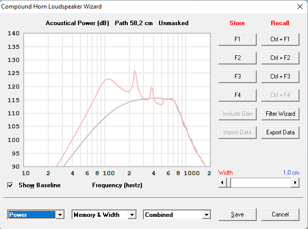

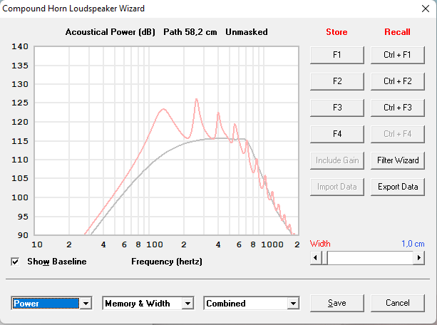

Differing vent phase due to differing compression ratio?
If that was the case then the simulation model would have taken it into account, but the results at 100 Hz in Post #51 suggest that the phases are not being affected.
Front port output phase = 43.2463 deg
Rear port output phase = -136.8685 deg
Phase difference = Front phase - Rear phase = 43.2463 - (-136.8685) = 180.1148 deg

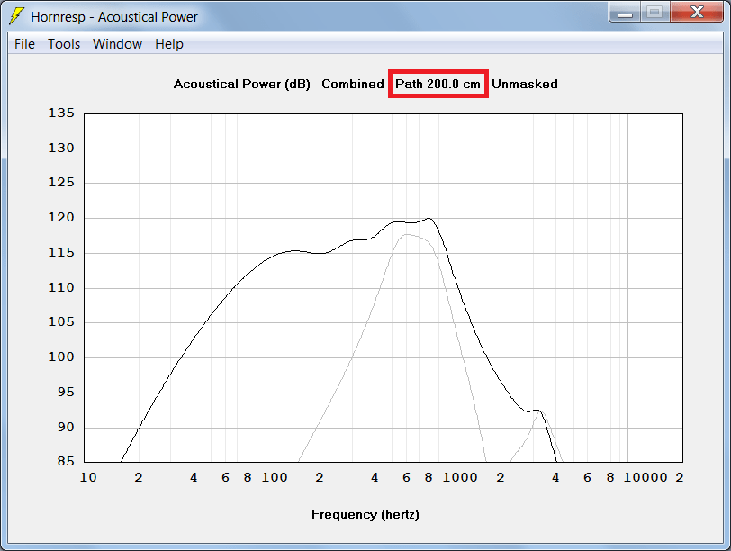

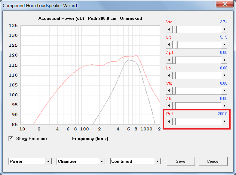

So there's little sidewall/ceiling/floor reflection, and the rear reflection off the wall is phase-delayed by ~2m becoming constructive ~28-140hz (any wavelength 1.2-6X the path length).
Increasing the effective acoustic path length between the two outputs by utilising a rear reflection surface would certainly improve things, as shown in the attachment, but presumably there are no reflections occurring under the conditions below, and the measured performance is reported to be even better.
On the street, all measurements remain valid and look even better than indoors.

Below is my simulation with increasing port spacing to one meterIncreasing the effective acoustic path length between the two outputs by utilising a rear reflection surface would certainly improve things,

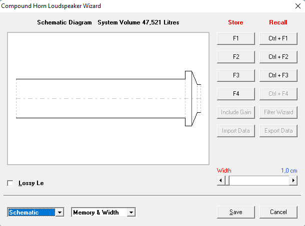

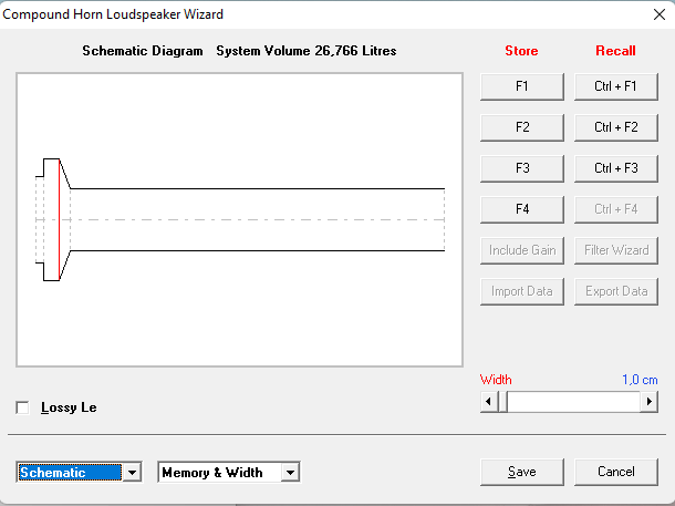

And question to David - what is the virtual mic distance and orientation in Hornresp sims? Is distance taken from driver's surface ( I suppose it is planar)

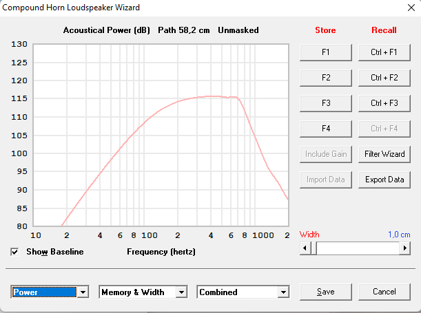

It is is not necessary extend the actual port length - just set the path length parameter value to the desired value.
Because power response is being calculated, orientation of the system does not matter. The acoustic output power is assumed to radiate uniformly in all directions from a point source and the resulting pressure at the surface of a virtual 1 metre radius sphere, centred on the source, is used to calculate the SPL.
SPL values are adjusted accordingly if radiating into less than 4Pi free space.
See the post linked below for further details:
https://www.diyaudio.com/community/threads/hornresp.119854/page-523#post-6069923

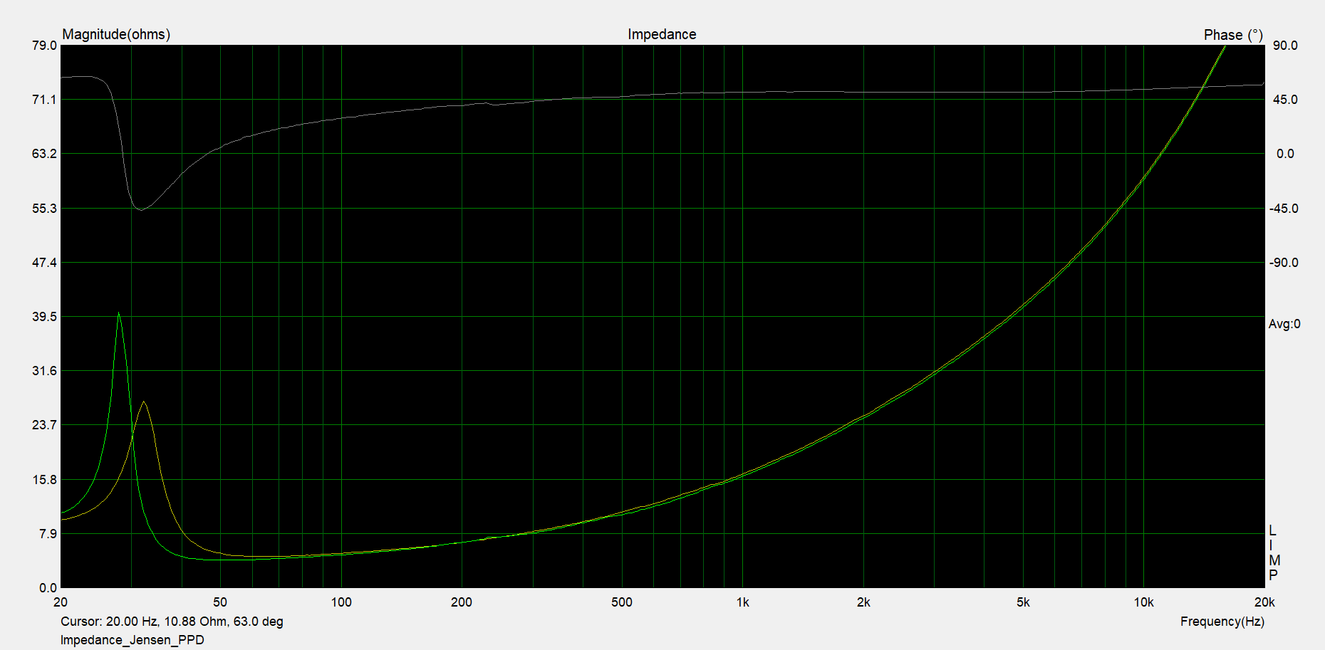

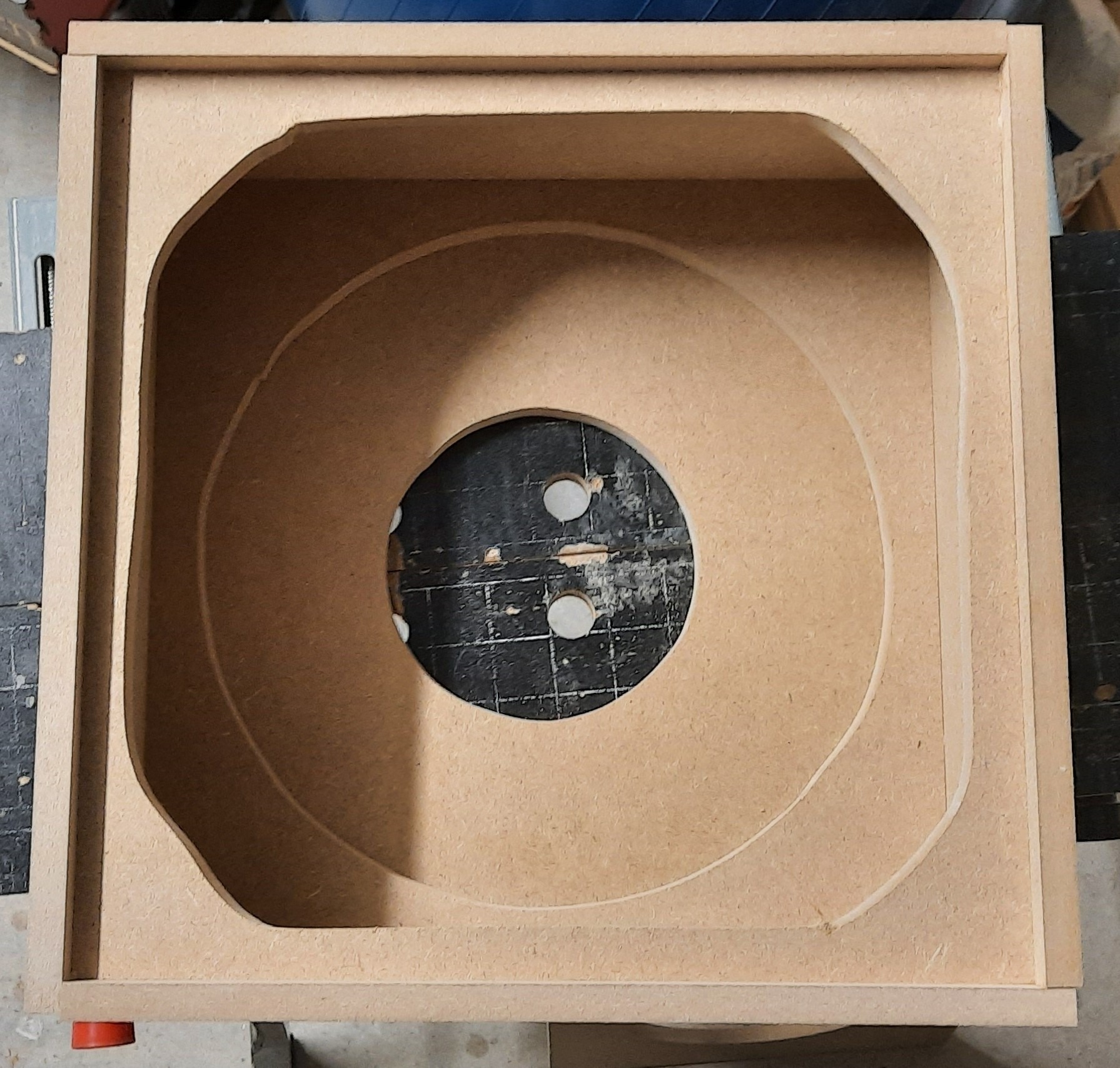

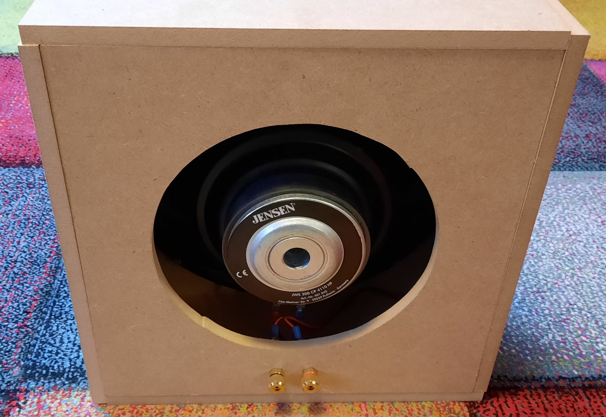

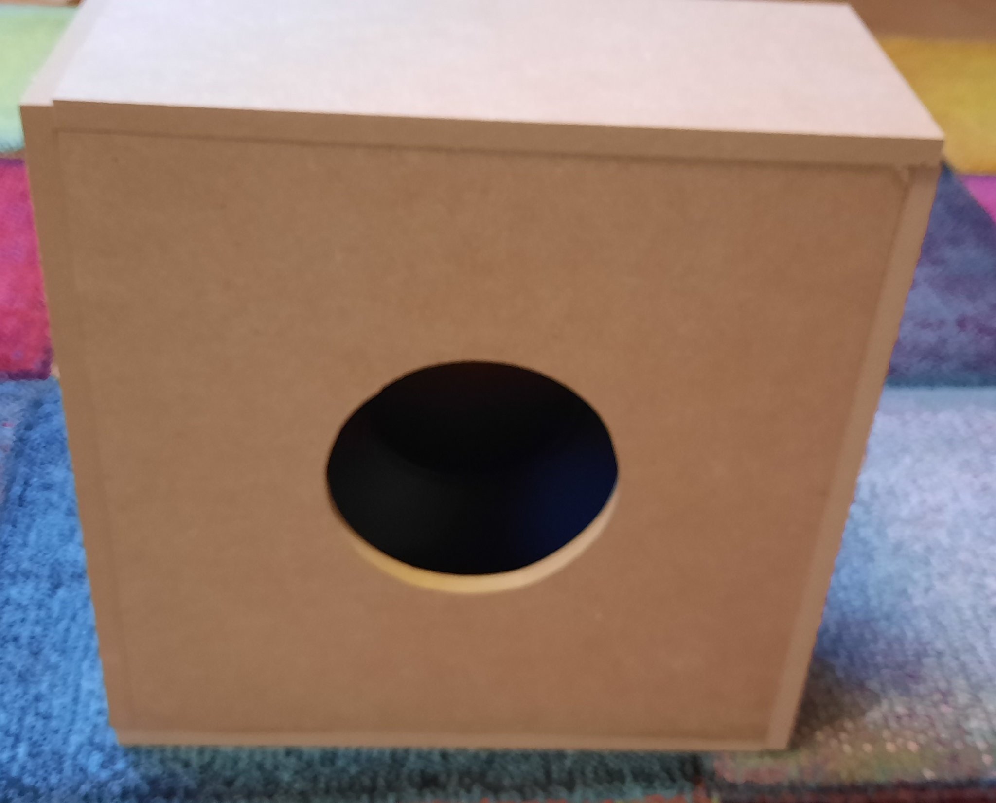

I did just build a PPD subwoofer using a Jensen JWS 300 CP subwoofer driver.
I ordered them some time ago to build such a Ripol:
https://www.diyaudio.com/community/threads/killer-dipole-bass-dirt-cheap.377255/#post-6800320
But I never built it, so I try this one now in a PPD subwoofer.
I measured the TSP for that woofer with LIMP:

I measured the impedance of the driver alone (yellow) and in the box (green) with LIMP, just in the empty box.
Let's see if I can get more measurements, it's been a long time using Arta.
