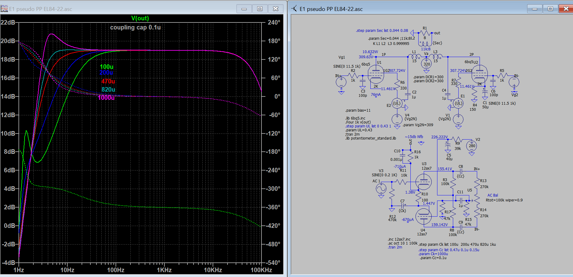

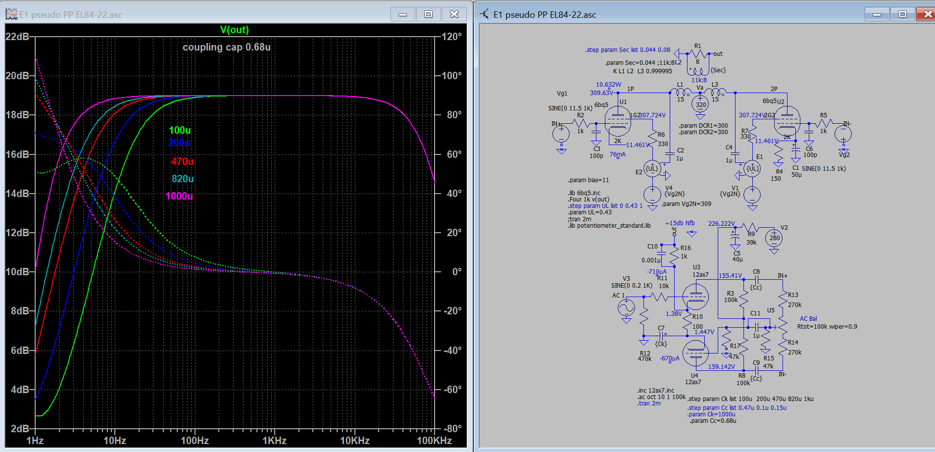

I suggest 200uF or bigger whatever you have to hand. I only suggest it as its what the simulation suggests is a fix - and I find its best to go with the science. You have a much better output transformer at the bass end but its also the source of your wows. Normally its the HF that goes unstable - so your lucky.
Last try I replaced 0.1u with 0.42u (0.1//0.1//0.22) an the result it's very fine, the cone it's absolutely freeze.
So in summary, the decrease of 0.1u caps aren't effect. In fact it shifts the resonance a few hz forward but with the same amplitude.
The increasing, instead it has good effect specially with 0.42uF. Seems to agree with the simulation at post #37.
I forgot to tell you that it sounds very good with a bass I didn't expect from 10W and very natural voices. I am very happy with this result.
While this may make you happy, you didn't actually fix the problem. This is the same as running your car heater with the windows down to keep the motor from overheating. Are you going to leave the higher value cap in place when you build the final version on a real chassis?

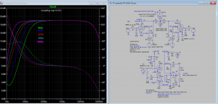

The bottom end response can only be extended when cathode cap and coupling cap are increased at the same time. Since you have now 0.47u coupling cap in circuit, with 200u the bottom end response at 50Hz is increased by at least1.5db hence your hear the buzz (50/60Hz) or hum. In doing so the sim shows that the phase shift is much reduced which is a good thing if the oscillation is due to the phase shift of para-phase inverter. As the oscillation is about 1Hz, so if I set the sim stop frequency to 2 Hz, all values cap gives zero phase shift. And if I use another phase inverter, no such phase shifts occur. So that is something about paraphrase inverter it is known to have greater phase shift at the freq extreme.
So it's phase shift at 1 Hz that matter, and coupling is coming from OT, so how OT passed 1 Hz (even at very low level, possible? or due capacitance coupling?).
PS: I disable Nfb, the phase shifts still present.

At the risk of going down another blind path stick with the .47uF if it works for you. If the cone is frozen that good enough for you. I not sure I can give you a complete fix without sicking the whole thing on LTspice and looking for myself. Enjoy the improved bass.
