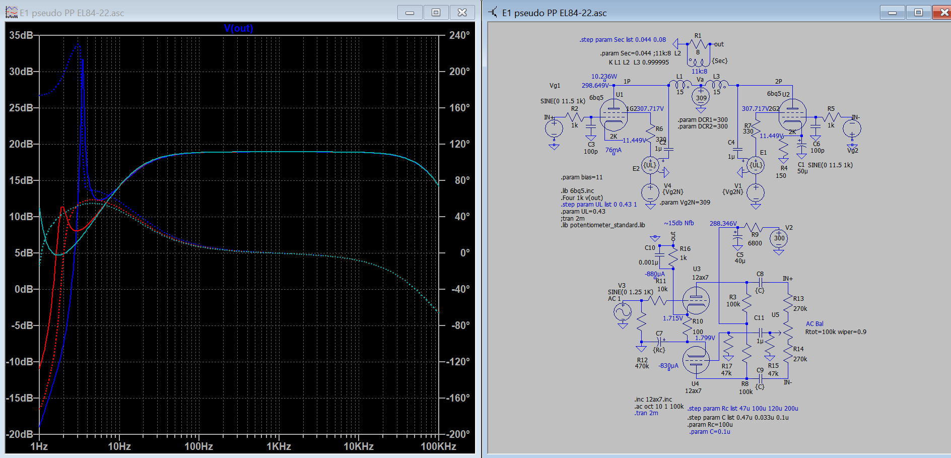

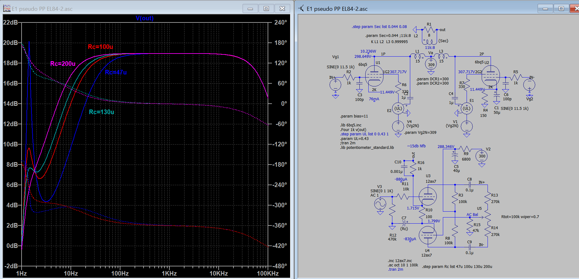

Here are snapshot of effect of cathode coupling capacitor from 47u to 200u where other capacitor values no change. Noted the phase shift (need more comment here). I also add a AC balance control as the two phase splitter level is about 2 dbs difference even after 15 Nfb being applied. The value of Nfb resistor will cause the bottom response and also phase shift to shift the same way as if cathode cap is being varied. If there is a phase shift then oscillation is likely too.

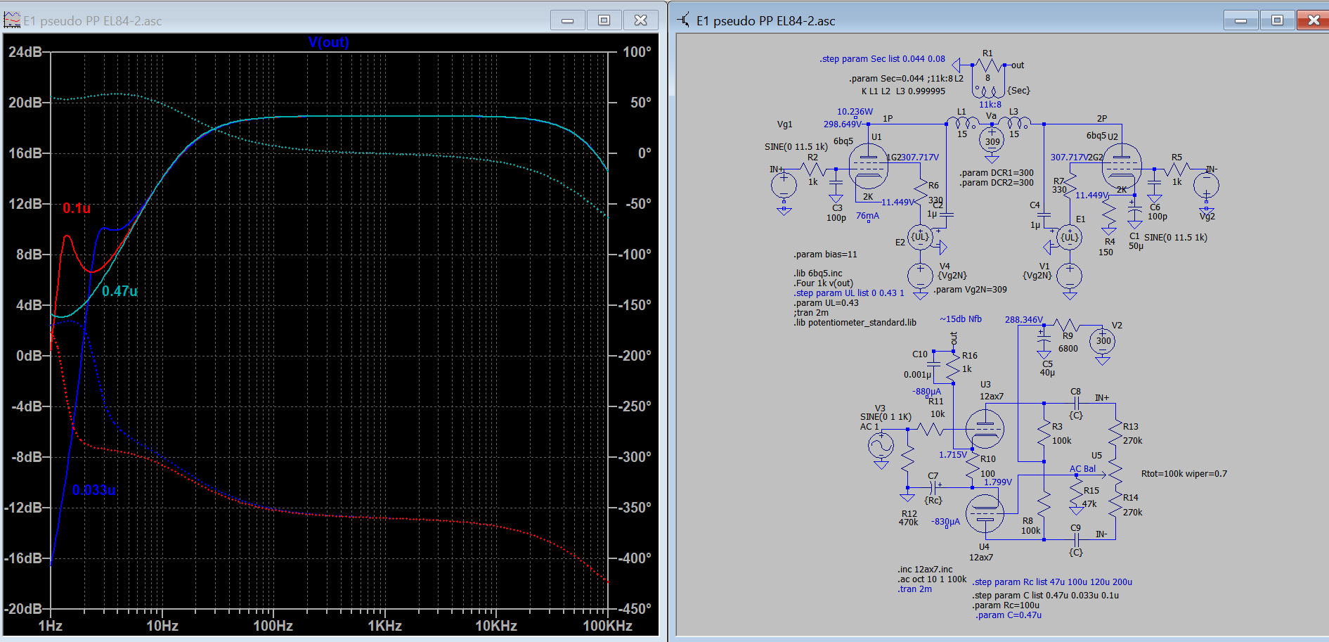

That shows the problem up nicely I guess you took the transformer values off the Hammond web site. I don't think Dr F tried increasing the output cathode caps. Could you also try .47uF coupling caps and PPR suggesting of .033uF. Mona suggested the output cathode caps.

Hammond 1608a bottom response is down to 30Hz, the sim transformer has primary 60H should be well covered for the bottom range. Here are plots you requested.
