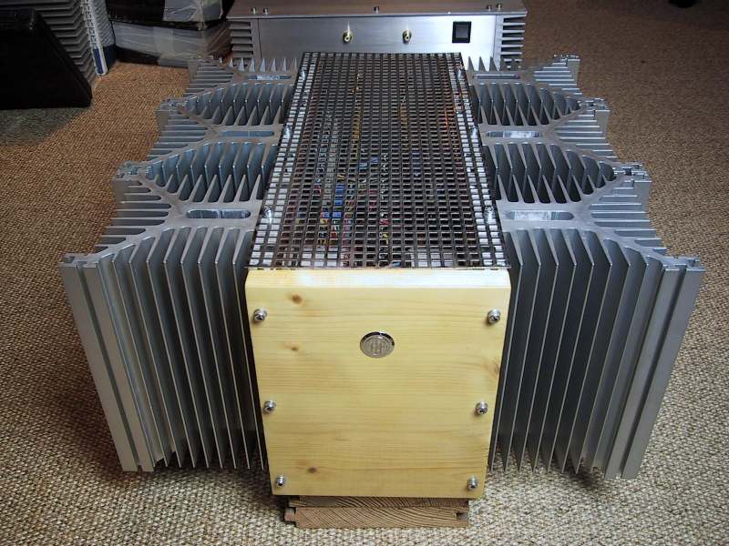

Pedro,
Your amp looks great but how can you build Aleph 5 without Balanced input?! At least I don't see it in the picture that you posted. You will eventually build a BOSOZ (with balanced output) if you don't have it already, right?
Pedro,
nice looking amp!
Concerning the hot inner and cold outer heatsinks:
Why don´t you mount your transistors on a fat bar of aluminium (say 10x50 mm) that runs over all of the sinks? This way the heat transfer to the outer sinks will be a lot better and the whole amp will be cooler (or you can turn up the bias......)
william

U can build the Aleph 5 with balance inputs. Just buy a pair of female XLR plugs (with the IN - and gnd connected) and plug it in when u are using unbalance input (RCA). Remove the plugs when u are using the XLR input.

I use mostly TT source, and my preamp(AudioNote preamp kit) doesn't have xrl outputs, so...
I really don't need at this time balanced inputs on aleph.
wuffwaff,
now the amp is at 49ºC, and still in testings. If I like what I ear, I'll not change it. As for the bias increase, I dunno...
My other amps, SOZ and Audio Note Kit one, (the last I use for high freqs) have 5W and 8W, and I feel very confortable in those power range. this one has 60W.
Lets see what comes when I make a side by side test.

Hello Pedro,
your amp looks great ! I concur with wuffwaff and highly recommend to use some massive aluminum bar to connect your heatsinks to better distribute the heat.
For a platform I would recommend some nice stone. Btw,you could replace the top cover with a solid piece of aluminum that you mount with some spacers in order to get some ventilation. With a solid cover you prevent most dust problems.
Regards, Andreas
