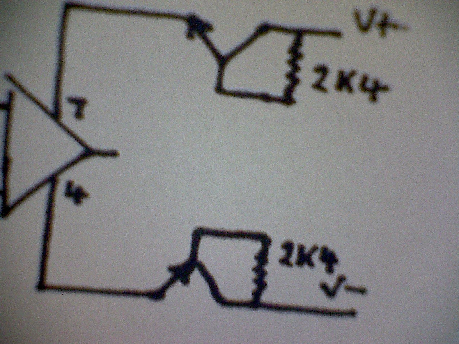

If that schematic is correct, analysis starts off being simple:
There is (15v-Vbe) / 2K2 base current, ~= 6mA
Op-amps generally draw a constant current apart from the load current which is signal/load dependent. Data sheet says ~=6mA
So with Ib = Ic = 6mA, transistor is hard saturated. Thus we have 0.1v - 0.2v drop on the supply lines, which will change according to the load current. this modulation will effect the output by 1/PSRR.
A waste of time, AFAICS.

Might I still persuade you to breadboard an opamp with these bypass transistors and listen? Then you could have heard that you have a little error in your analysis. Ib is as much as Iq / beta. Ib * Rb determines the actual voltage at the emitter, is Vpos - 0.65 - (Iq/Beta)*Rb.

That does mean the transistor isn't actually saturated as Vce will be about 0.7v, just above saturation voltage I expect.
That's about right, it's a little more. The simulation shows a drop of about 1V across the emitter/collector. If anything, it's a load driven supply modulation booster as seen from the opamp powerpin. This is also shown in the simulation; the voltage swing at the emitter is larger than the voltage swing on the power rail itself.

The emitter IS the power rail!
We are not talking about the same schematic.
Nonsense!
Ib is forced. Ohms law.
Yes, Ohm's law. It's just that now you have to apply it in a different direction. You are assuming the emitter sits at 0V (your 15V - Vbe across the resistor). But the emitter doesn't sit at 0V. It sits somewhere between 0V and 15V. You won't know at what voltage unless you start calculating from the opamp's idle current. It's this current that dictates, together with the transistor's hFE what the ultimate voltage drop is going to be.

However, using the OP cct in the first post, it is entirely a question of the transistor gain.
To a first order, the OA supply line is a constant current, so a simple model is the transistor with a 6ma source in its emitter.
Where it all goes depends on Hfe. i.e. it is ill defined.

In an op amp circuit there is no defined ground connection, you have therefore drawn the schematic wrongly. The resistor for each polarity connects between the collector and base
the emitter connects to the op amp power supply for each polarity. I have used this with BC846 and BC856 transistors, suiting surface mount application, and 0603 2k4 resistors
see my blog for construction help: opamp - opamp construction. If using TO92 then BC547 and BC556. recommend Voltage supply 12- 15v dual polarity, max voltage 17.5.
See attached diagram showing a single op amp. Next find your soldering iron and a op amp installed in an audio circuit,like a CD player or any other audio circuit- this is after all the DIY Audio Forum, modify the way it connects its power rails as per the diagram.

Yes, 15 Volts divided by 2400 Ohms = about 6mA.
However in your circuit there is not anywhere near 15V across the resistor, so the current won't be anywhere near 6mA, unless the circuit you're using is different to the drawing you posted.

Which asks the question how current is determined or defined in such a connection lacking ground. The op amp itself may pull, request, demand current. From my use with this circuit it expends current through the emitter to the op amp relative power supply pin.
