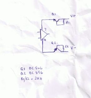

I consider to build simple OpAmp preamplifier and measure the same design with and without the mod (on perfboard) with RMAA. I'm just wondering should I place the bypass caps along with the mod or omit them.
Oops. Sine waves are for the output impedance measurement actually. 🙂
In the method I use of building transistors underneath the op amp there is no bypass cap, however a bypass with most op amp installations is on V+ and V- in, in this case on the collector with transistors... so won't hurt there.🙂
Cheers / Chris
Chris,
Out of interest, have you also tried this with:
1) 0.1uF Fim Capacitor between -V and +V of the OPA?
2) With really small size 100uF/16V or so cap's on the transistor bases's?
Ciao T
I tried suggestion (1) but differently between polarity of bases a 103 using just one capacitor and did not function in the marantz CD80,
and (2) an option may be a cap multiplier requiring a lead out for ground connection. In a single Pin 5 or Pin 8 could be cut on the adapter leaving 8 or 5 for the end user to connect gnd.
Cheers / Chris
