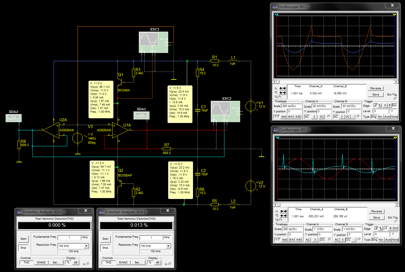

The difficulty of adding a capacitor in an op amp circuit is that ground is not defined ie there are probably 40% non inverting vs 60% inverting, population out there some using Pin 2 some using Pin 3, and then there is ground lift in some of that population, so what is an answer- given that an opposite polarity is available in terms of the other voltage rail a capacitance added to the base of each transistor as a cap multiplier might ... and a big might .. er ...function by instead of ground by connecting to this opposite polarity rail.... let me connect such a circuit up and report back.

First of, an emitter follower is a three port device, and its an amplifier, your circuit is niether.

In my book, that would be an emitter follower and very much in line with adding a capacitor to the base as DF96 has mentioned.

Yeah, though if Ic/hFE drops a decent voltage over the base resistor, it stops acting like an emitter follower. It still could be, though driven by an input (V+) with a high output impedance, causing the actual voltage on the base to vary with current load, which will happen when the opamp is 'working' on signals. Best to throw it in the sim, attach some scopes and see what's going on.
"The transistor monitors continuously Vdiff and adjusts its emitter voltage almost equal (less VBEO) to the input voltage by passing the according collector current through the emitter resistor RE. As a result, the output voltage follows the input voltage variations from VBEO up to V+; hence the name, emitter follower"

Except you forgot to quote something that is always a given, and that is 'the transistor is correctly biassed into the normal operating region'. I'll leave it to you to find out what that means.
That aside, since your signal to be followed comes from the power supply rail, then it follows the power supply rail, the very thing you do NOT want it to follow as you are trying to prevent electrical garbage from getting into the chip.
However, at some high frequency this does indeed work as a sort of cascode due to not so inconsiderable Cbe, given the transistor is near saturation for the resistor values given. This WILL actually isolate it from small amounts of HF hash, making the transistor look more like a current source in series with the power supply. It would work much better with the usual caps on the opamp side for decoupling, though, or, connected as a gyrator. In fact you could try to couple the bases through a capacitor.
Another possibility is nonlinear modulation of the substrate potential WRT inputs, but this would be chip dependent. Such a thing could in some cases provide a measure of distortion cancellation.

If someone took up the enormous challenge of Simming an Opamp and 2 BJTs 🙄, it would make sense to also look at the various claimed equivalents like 10-100R resistors as well.

It's simple enough to prove/disprove whether it makes any difference. You build one circuit with the 2 transistors added, and an identical one without them. Feed the same input signal to both (i.e. parallel the inputs), preferably using music as the signal. So, now you should have 2 identical outputs if the transistors make no difference, and different outputs if they do.
Treat these 2 outputs as one, i.e feed the 2 outputs to the input of an amplifier, preferably one with a balanced input, although an unbalanced one may be OK if the opamps are powered from an isolated supply. If there's no sound there's no difference between the 2 signals. A balance potentiometer may be needed in practice, set for a null at 1kHz before commencing music tests, due to feedback resistor tolerances affecting gains slightly. If the transistors work then I would expect to hear a signal that isn't just the original music, it should have a lot of 'extra'.
Well, decide for yourselves folks:

'Just a bit puzzled about IMhz shown in settings blocks but 1KHz shown on graph frequencies of the Sim. Scaling factor? Harmonic resolution?
'Not so sure I want to fudge a broader sound stage etc. that way, either. 😱
The light blue trace on the lower scope containing spikes as i read it is the output of the op amp without the transistors. The Red trace resolves a sine wave... interesting at 5ma or slightly less allowing for resistor and inductor in the sim ... try 6ma by stepping PSU up to 15v
