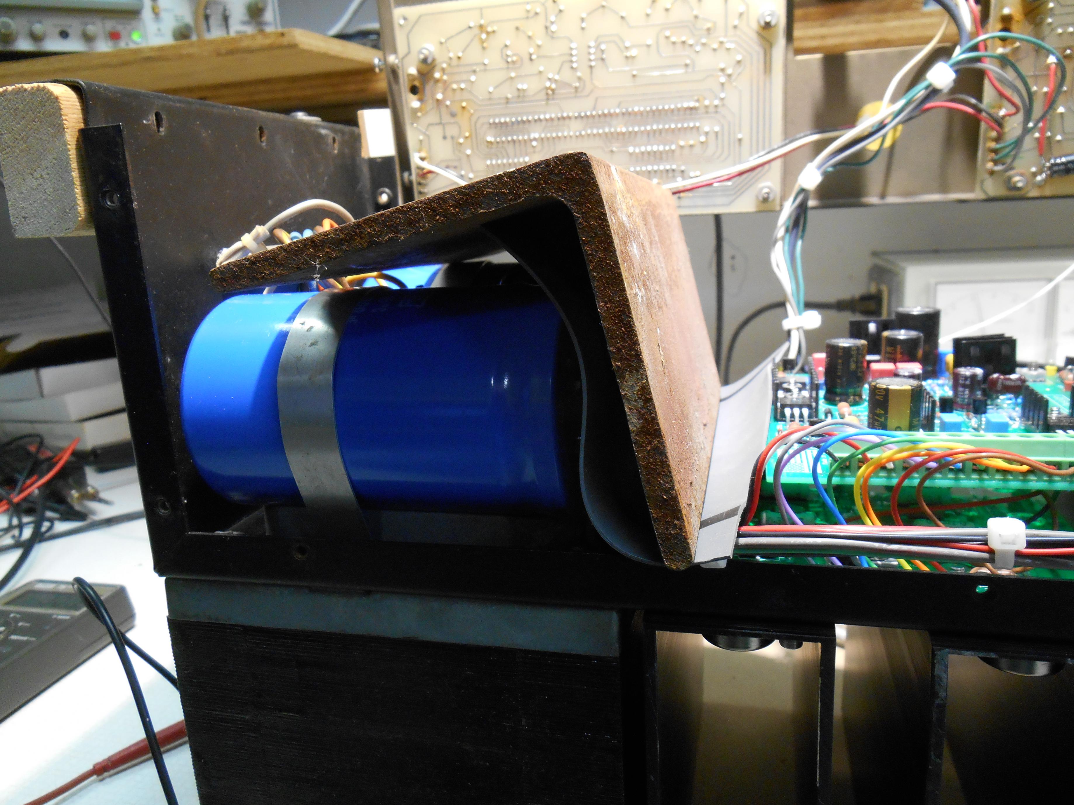

I am posting on a forum dedicated to Phase Linear and stray magnetic flux was suggested as a concern. I performed the test pictured and posted this comment;
"The steel angle had no effect on the hum/buzz. The ground wire that was connected to my IEC socket ( to the capacitor common buss ) is removed. When the amp chassis is free-floating (chassis about 62 VAC to neutral) and a 10 k resistors between pins 1 and 2 on the PL14_20; the hum/buzz increases as my finger approaches the resistors. Buzz also increases as my finger got within 1/4" or so of the op/amp IC's on the PL14_20.
This effect from my finger did not happen when I alligator clipped the chassis to the wall outlet ground. I assume the capacitive effect of the amp having 62 VAC compared to my finger causes hum. But should the PL14_20 be so sensitive to capacitive influences of is there a possible (wiring) issue?"

Yes you will get hum/buzz with the chassis floating. The chassis must only connect to the secondary 0V where the two main filter caps join and there must absolutely not be any other connection to the chassis otherwise you will have a ground loop.

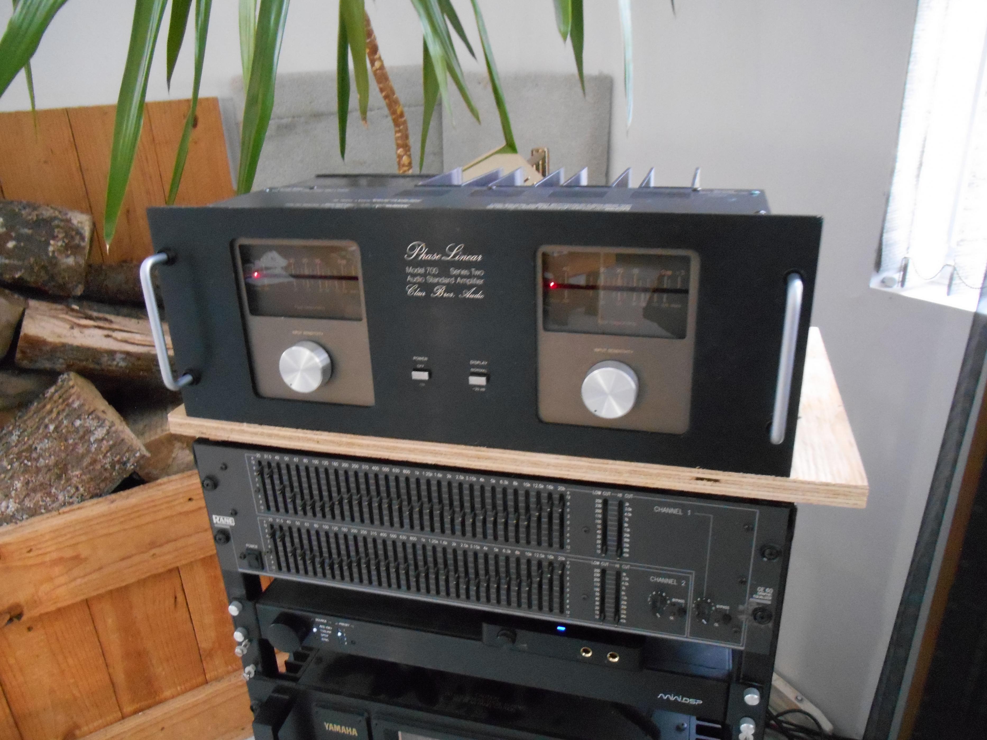

Hi Folks;
Just thought I would update you on the PL700 II. Amazingly the amp is performing beautifully after the following changes; (that were suggested to me, I just didn't follow them exactly, apparently)
-Chassis floating, no mains ground connection.
-amp connected to signal source by Unbalanced Coax.
I just had concern about connecting the amp with 62 VAC on the chassis, to the fancy miniDSP source. But it works!---and is dead quiet.

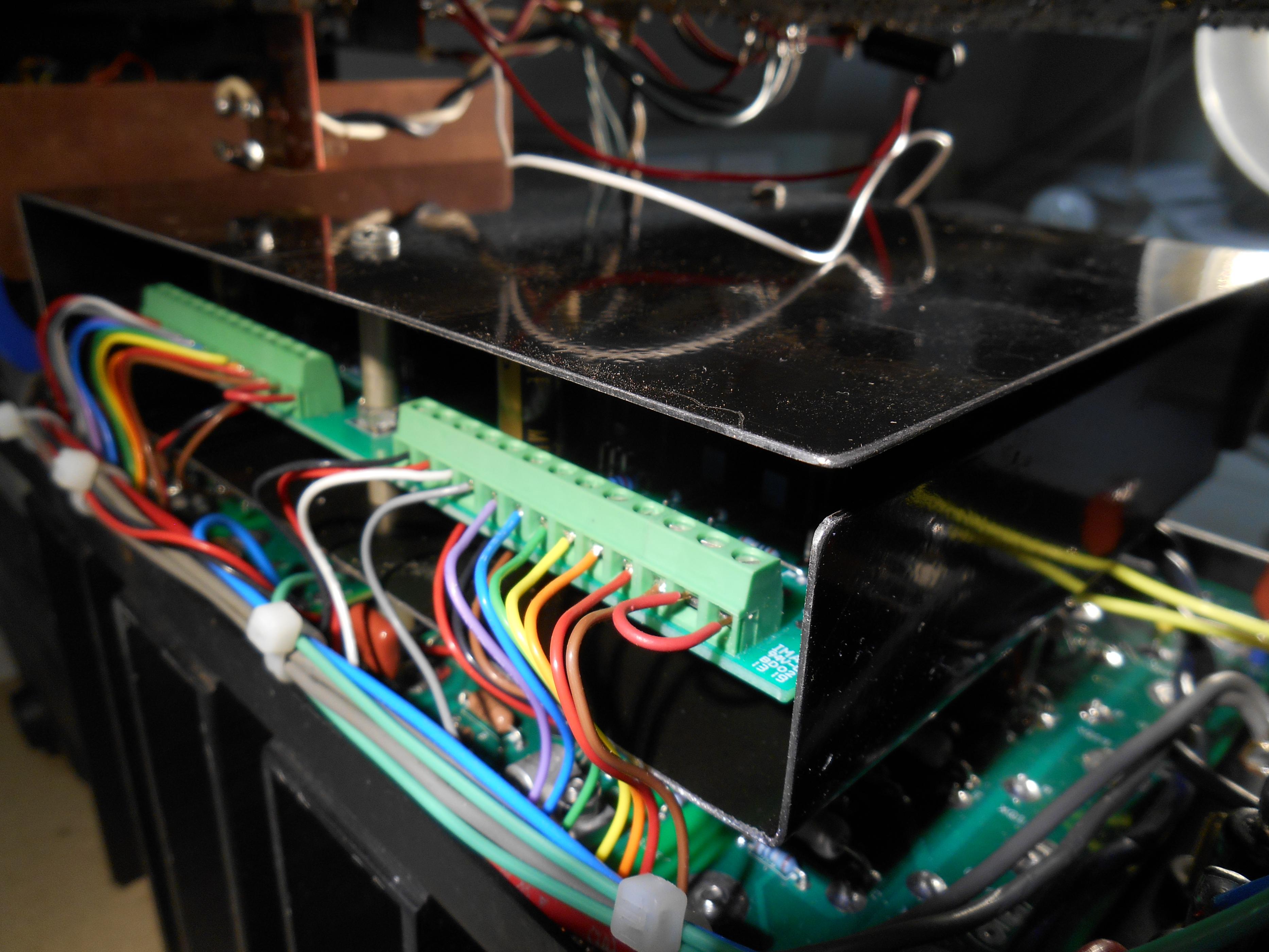

I must confess that there was about 3 mV RMS of hum/noise on an 8 ohm speaker. This was reduced to 1 mV by the addition of a steel clam-shell shield installed above and below the control board. I discovered that lifting the board away from the AC hot wire, reduced the hum. I am convinced that the interference is capacitively coupled rather than inductively, as the phenomenon was present even when power was fed from the other side. Never the less, the shield was fabricated in steel.
I am starting a rebuild of a second PL700 II and will verify the necessity of the shield.

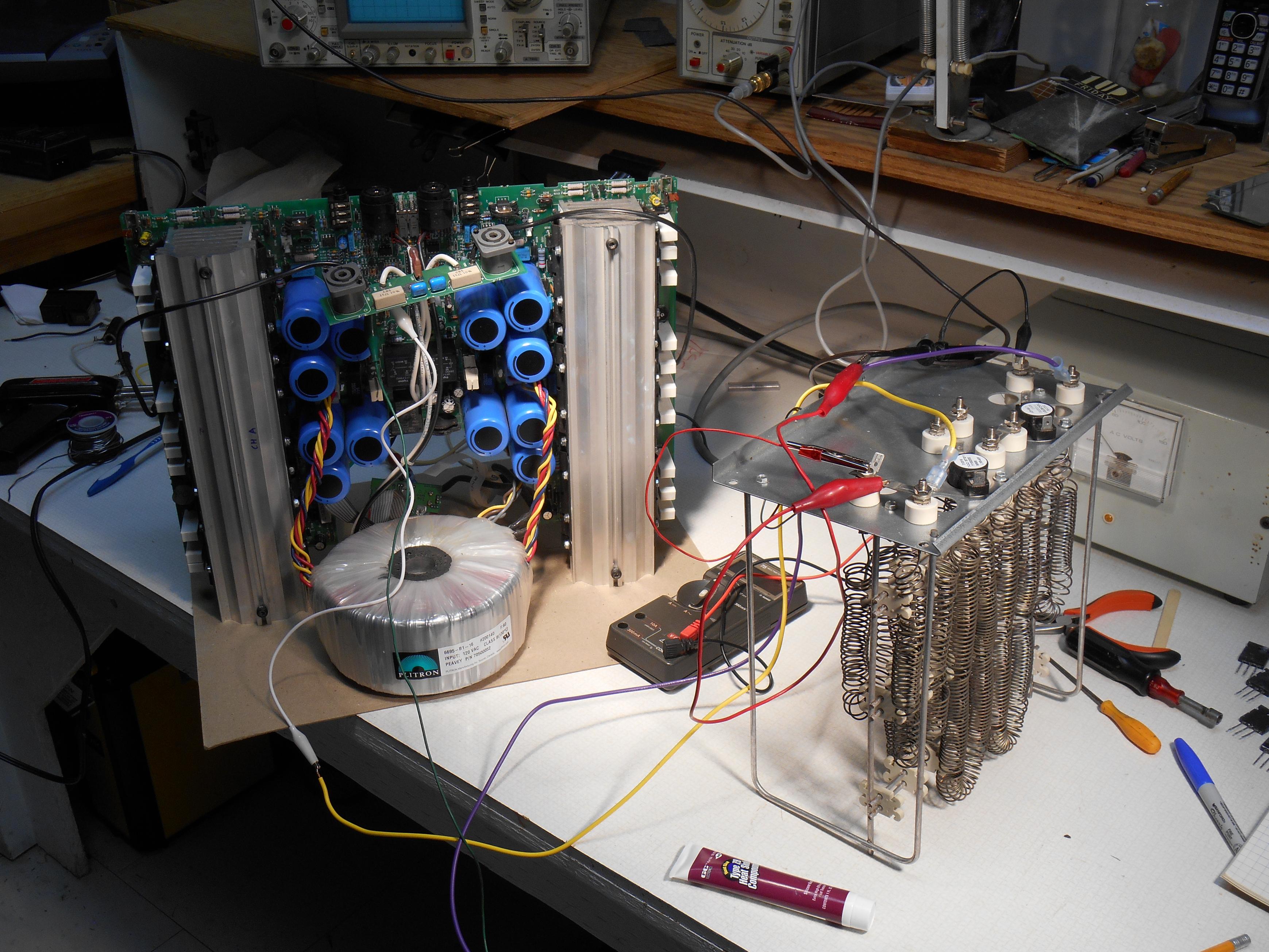

On to a side issue; it has pointed out that my dummy load (pictured below, ex electric furnace ) may have some inductive properties. The elements were reconfigured to be 8 ohms.
This may be basic electronics, but could I test this by connecting it in series with an 8 or 10 ohm carbon resistor, then measure the voltage at the centre point with my scope? If the voltage does not shift with frequency, would this confirm the suitability of the dummy load?
