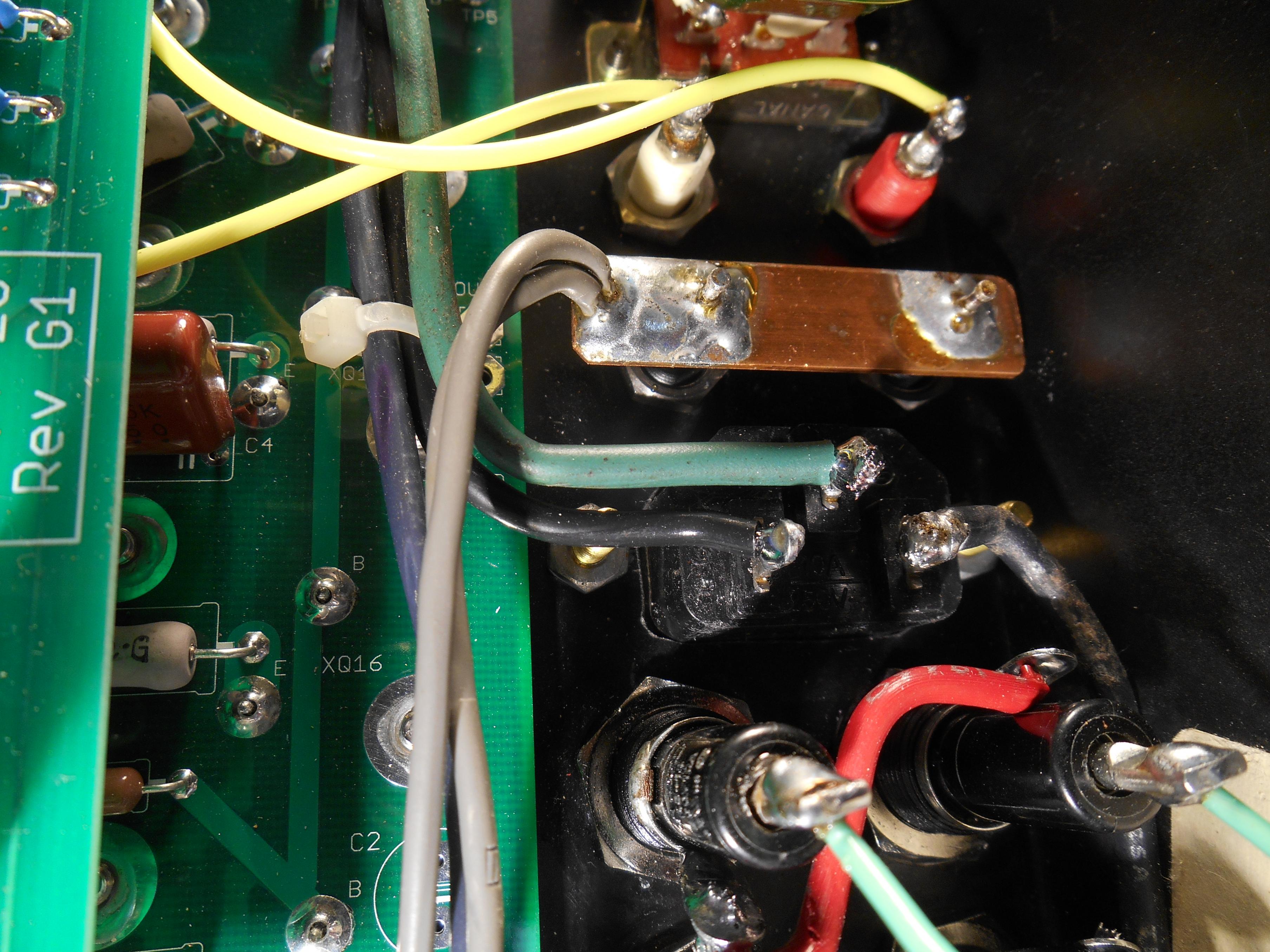

All seems fine again! Pictured is an IEC socket installed to replace the old permanently attached line cord. I was planning to leave the ground pin open but a 14 GA wire to the secondary centre tap bus seems to have solved the hum problem completely.

I fully rebuilt a PL700b for a friend several years ago. I built the amp in one of the new 700 chassis that White Oak offered but I chose to revise the stock pcb's. The new White Oak chassis used a 3 pin IEC socket but I tied the AC mains ground to chassis ground. Then I tied the xfrmr secondary center tap (star ground) to the same chassis ground point with a 7 - 10ohm NTC inrush protector for isolation between the two grounds. That amp was completely silent.

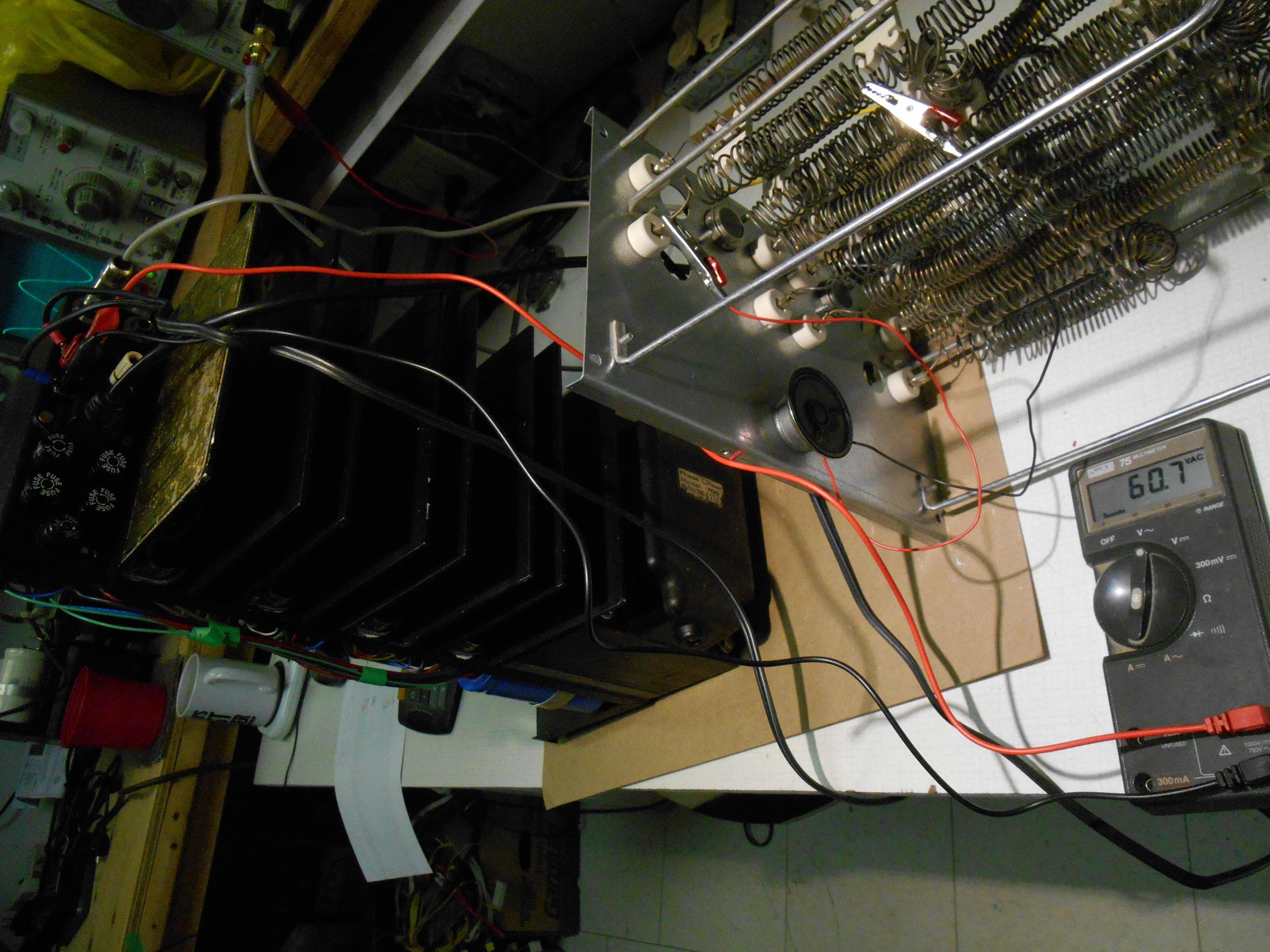

Put the amp on the 8 Ohm dummy load; 60.7 VAC at 1 kHz, (460 Watts) Left of Right, just before clipping. Both channels still measure 0 mV DC offset.

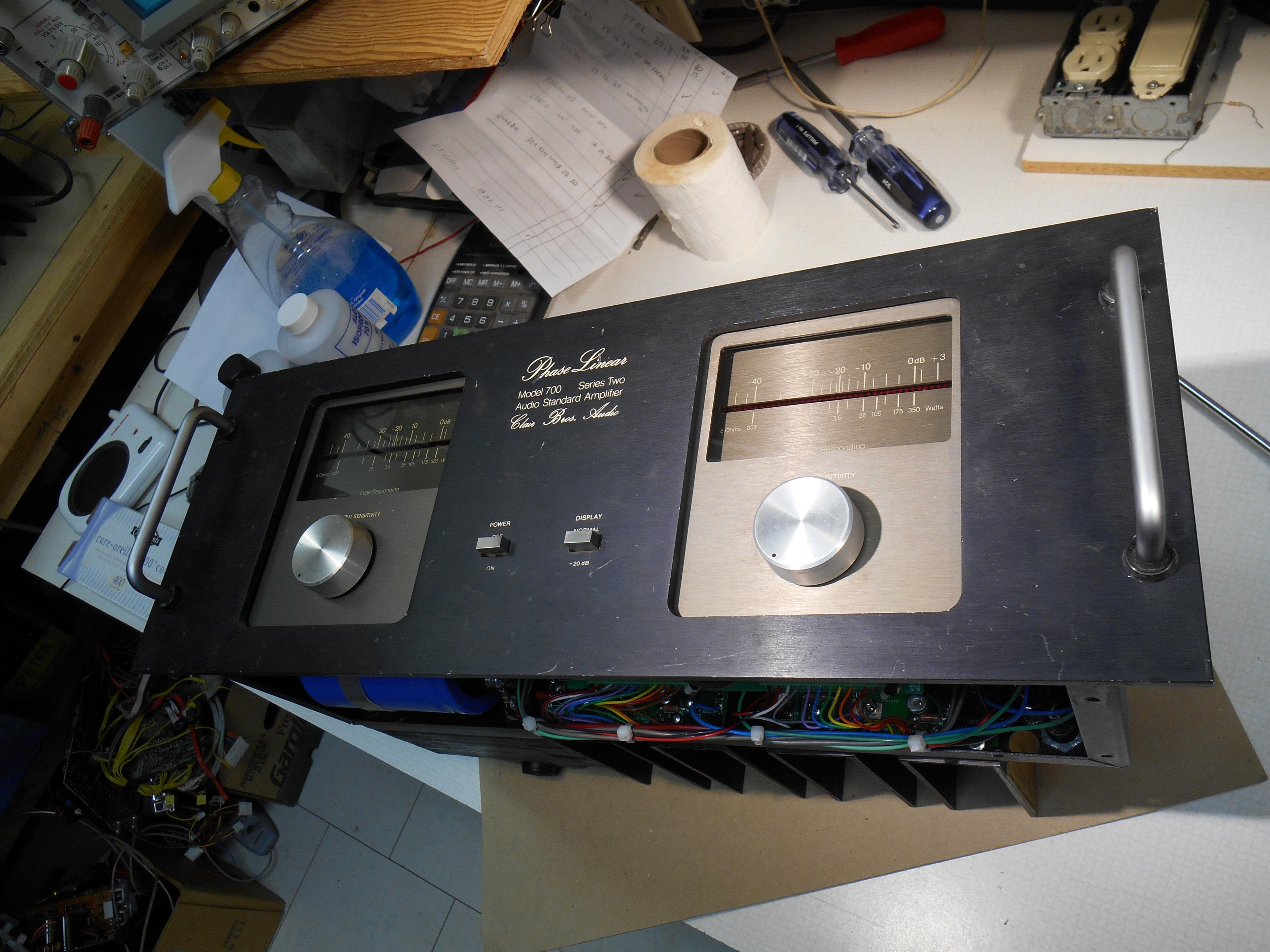

..............Wow.........Can't wait to put this amp in my rack. Cleaned the meters, face-plate still needs work but I had to get a sneak-peek. The handle were from Home Depot, $3 ea.

I think my celebrations were a little premature... There is a low level hum when the volume pots are opened. Dead quiet when pots are closed. Obviously the 'leaky' power transformer has got something to do with it but the amp. I am still hoping that this is a solvable problem.
if i didn't know better (and i usually don't) i would think you may have cracked pots, the phenolic backplane is cracked as well as the carbon track but at a position that the wiper still see's ground when rotated fully counter clockwise.

This is not the first time I have been accused of being a 'crackpot'. I was just puzzled that the noise was less with the pots wide open. The 1 mVAC was measured across an 8 ohm speaker connected to the amp output.

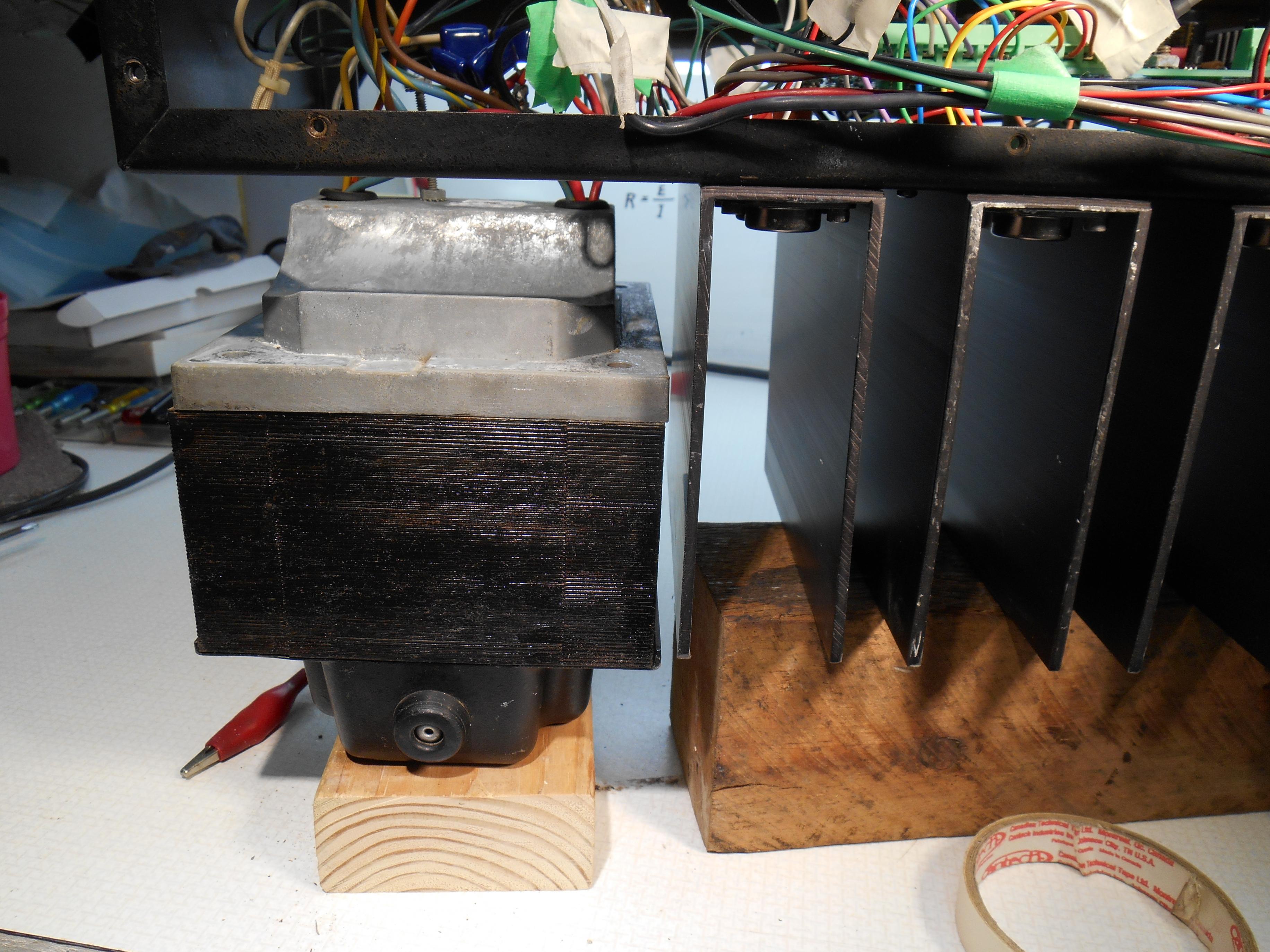

Hi Chris; My 60 VAC 'leakage' is not on the core. It is from the primary winding neutral side to the secondary centre tap. I will measure this voltage with a 1 k shunt. I measured 60 or 62 with Fluke only, 42 VAC through 1 meg, I believe it dropped to millivolts with 10K

Thanks for the link, I will study it asap. I had the problem even with the transformer physically separated from the chassis. My 60 VAC leakage is between the primary and secondary windings, not the lamination core

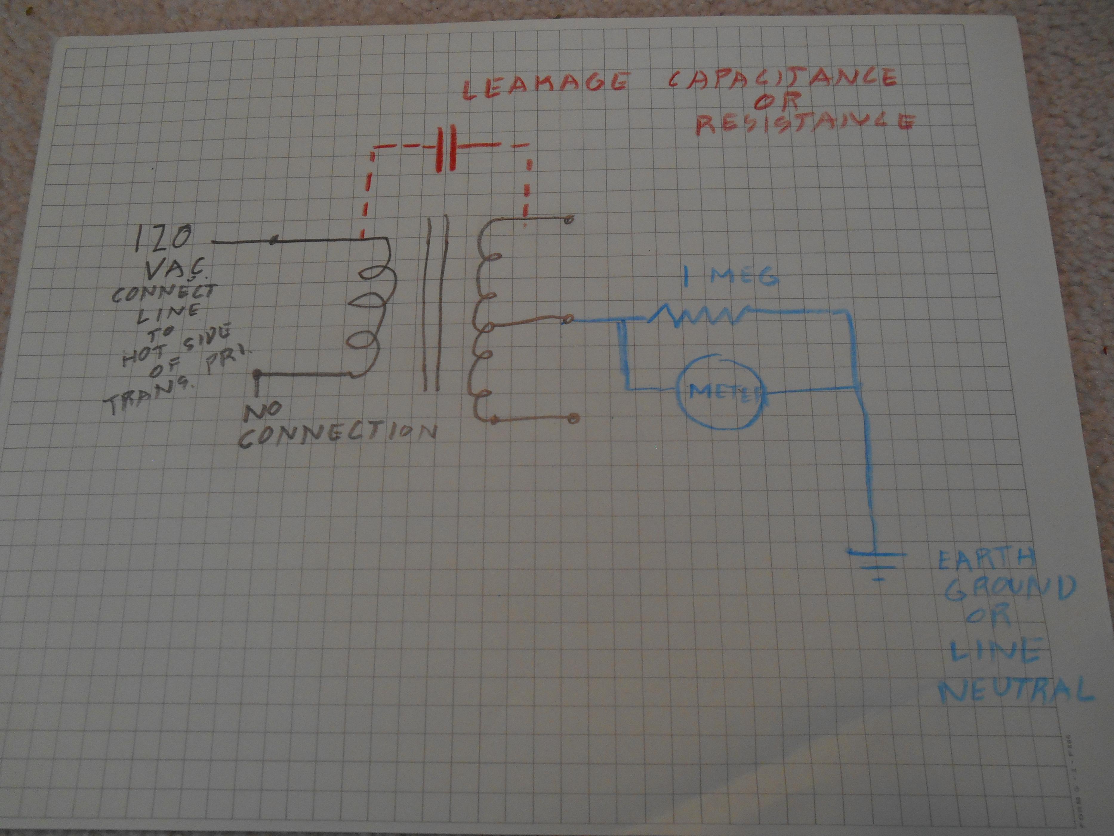

I am going to perform the following test, asap, on the transformer of my second amplifier, which is exhibiting the leakage.
If the leakage is due to inter-winding capacitance, I should measure leakage even with only one leg of the primary connected (?)

Hi Peter,
I have never measured a transformer like that. I do tend to think that your leakage is real, and also within safety limits.
Sometimes your circuit common has to be isolated from the earth ground with a 10R to 100R resistor. The earth is still bonded to the chassis, so nothing that could possibly risk a shock or run afoul of the electrical code. All you are doing is lessening any current to ground while maintaining the potential. The core of the transformer needs to be well grounded to the chassis or it may radiate hum. I have greatly reduced the hum on several audio devices by cleaning up that transformer core connection to the chassis. If you have it shock mounted you will need a heavy wire (to carry any fault current possible in case the primary insulation breaks down).

Hope to do some testing on the transformer of the second amplifier today. Megger testing would certainly yield some worthwhile info but both transformers are presenting issues under normal line voltage conditions.

The leakage in the transformers seems completely normal. The only way to get less with a transformer that large is to use a split-bobbin unit. Which would have terrible voltage regulation, and convert your amp from 350 watts per channel to around 200. Most amps this size just cover it up by using a grounded power cord, which would make your ground loop problems even worse. Try the trick of isolating the audio ground from earth with the 100 ohm resistor and hopefully it helps. In smaller installations with only a handful of pieces of equipment in the rack it often is.
