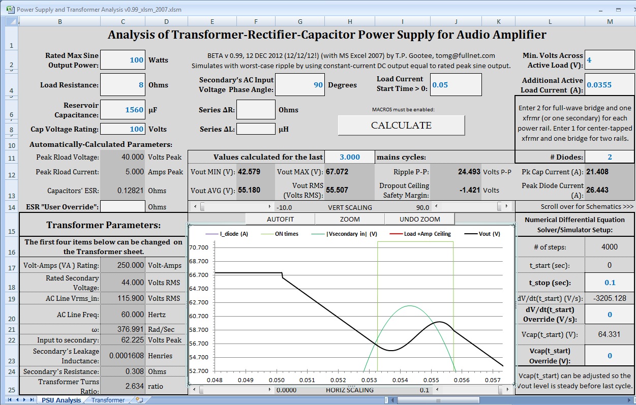

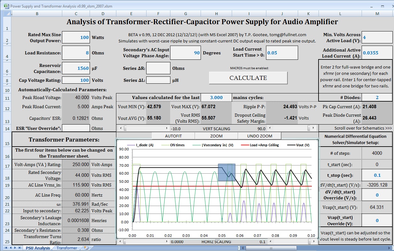

I got the mouse-drag "ZOOM" functionality working, in the spreadsheet's plot, and thought it should be shared. Attached is beta version 0.99.
I am hoping that someone will let me know if it works in any version of Excel other than 2007.
I included an Excel 97-2003 xls file version, and the 2007 xlsm file, both in zipped folders.
I attached two screen images. In the first one, you can see the rectangle that I just dragged with my mouse, on the plot. The next screen image shows what happened when I released the mouse button.
Notice the three new buttons, just above the plot area. They are "AUTOFIT", "ZOOM", and "UNDO ZOOM".
The AUTOFIT button rescales the plot so that the axes will show every part of the plots. The ZOOM button makes it wait for you to drag a rectangle in the plot area, and then zooms-in so that rectangle fills the plot area, with correctly-scaled axes. The UNDO ZOOM button makes the plot go back to the previous zoomed state. It can handle multiple levels of zoom-undo.
I didn't write the code for those button actions, thankfully. But I did adapt it to use buttons instead of a menu bar (since CommandBars objects are obsolete in Excel 2007.) However, I have noticed that if you click and drag OUTSIDE of the plot area, which the code does NOT prevent, it will cause weird things to happen. So please avoid clicking outside of the plot area, just after pressing the ZOOM button.
Tom
