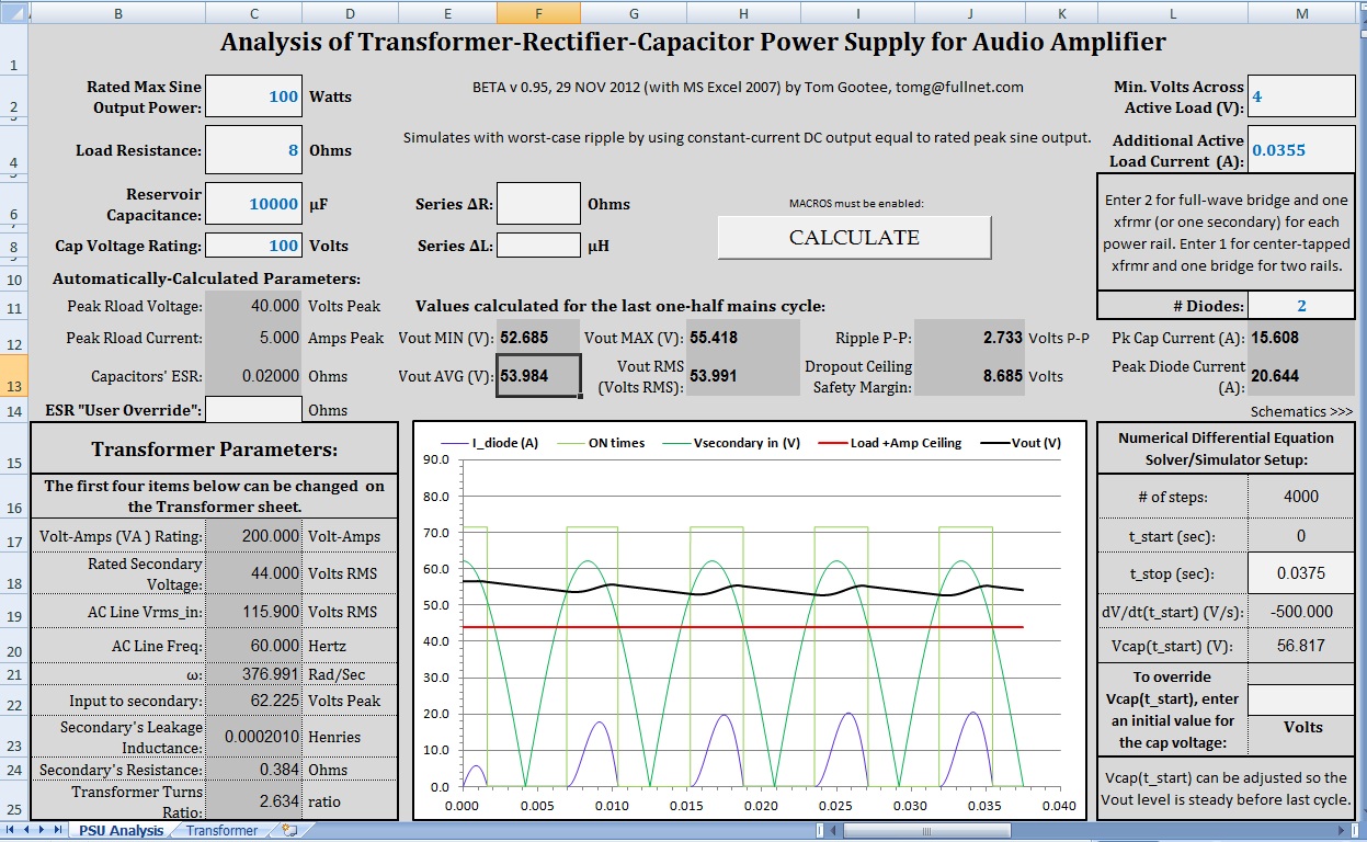

This version looks pretty good, finally (attached). And now it runs in about 5 seconds instead of 40, on my machine.
I think that the "# of diodes" functionality works OK, now. I was also finally able to get the equation version of the diode Rdiode(i) model to work.
I changed the optional series resistance and inductance fields to be DELTA R and DELTA L, so that users can also SUBTRACT resistance and inductance, as long as it doesn't make the resistance or inductance that represent the secondary's R and L go below zero.

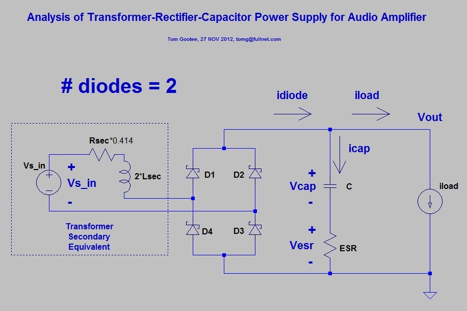

I changed the names and meanings of the peak output voltage and current fields, to avoid further confusion. They are now named "Peak Rload Voltage" and "Peak Rload Current". The additional current drawn by the amplifier or other active load is entered in a separate field, and adds to the "iload" that is used in the calculations, iload being the power supply's output current, not the active load's resistive load's current.
A screen image of the main screen and an image of the schematic of what is simulated for ndiodes = 2 are also attached. (The schematic is one of the ones included in the spreadsheet.)

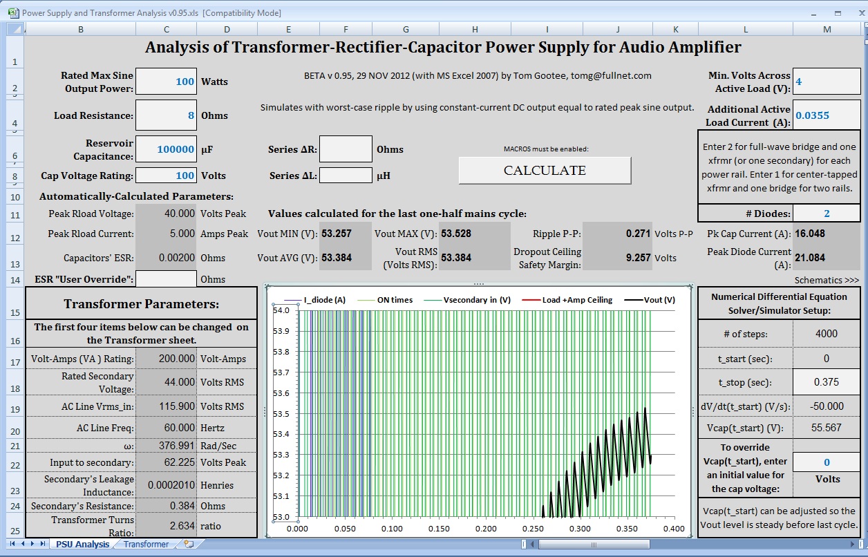

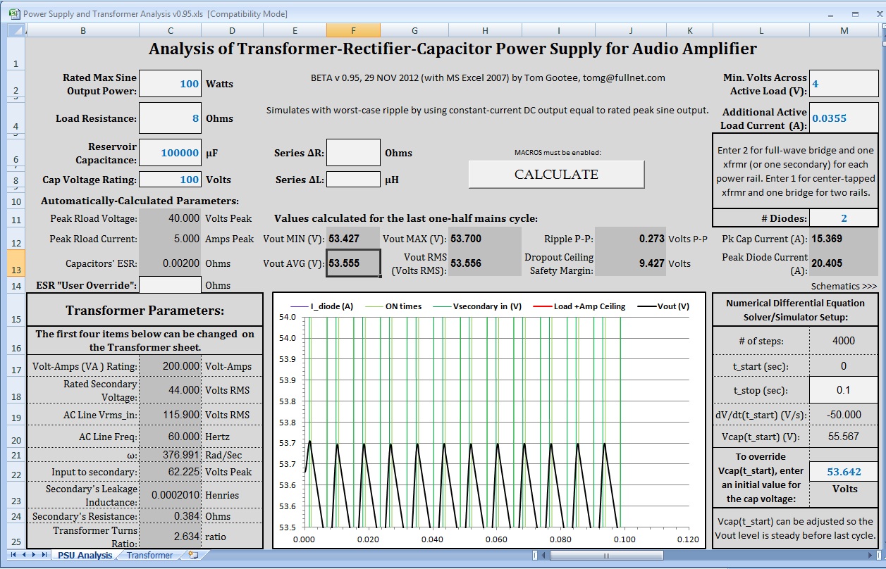

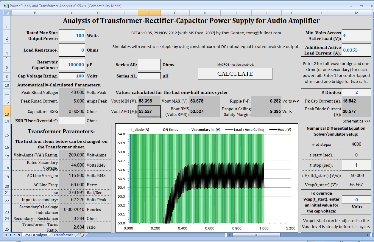

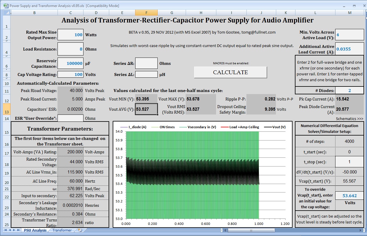

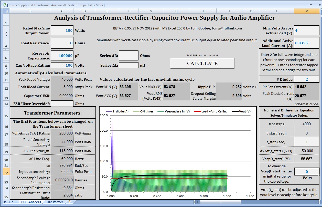

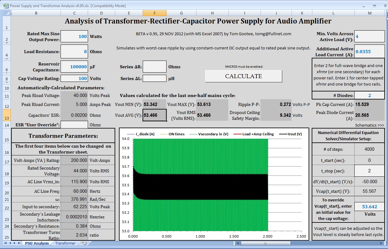

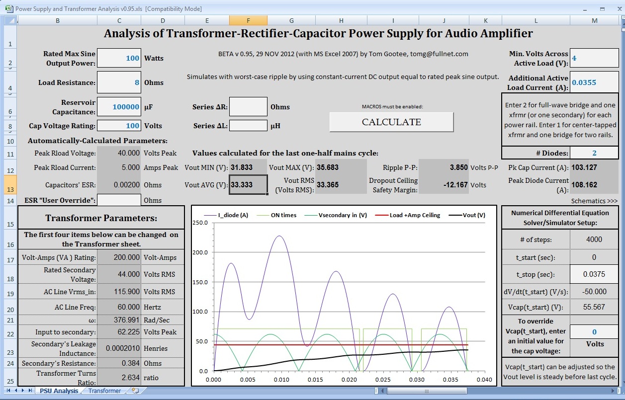

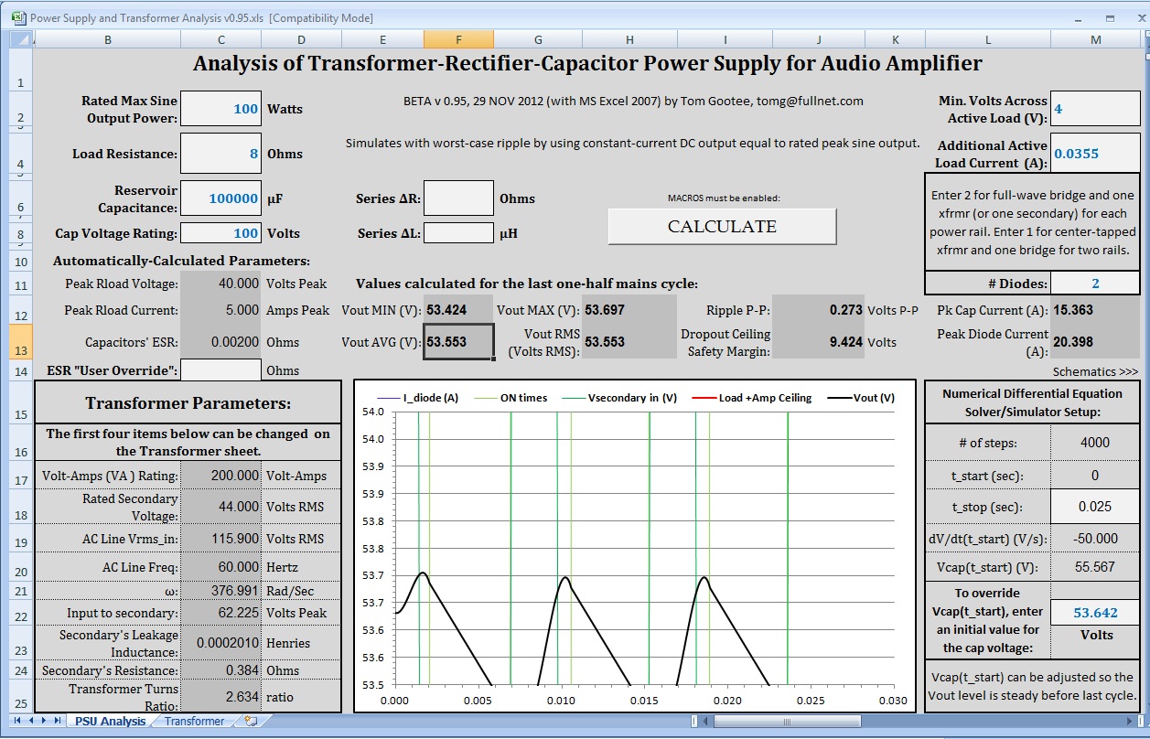

I was curious about how the accuracy of the spreadsheet's waveforms would be affected by stretching out the run time. Since that makes the time-steps larger, it should eventually make the results inaccurate to the point where they are unusable. (We could always just increase the number of steps, to keep it accurate for any longer run times. But that would be a little more involved, because then each plot's row-range settings would need to be adjusted, to use the extra rows of data that would result.)
Anyway, it's not nearly as bad as I thought it might be. I was able to increase the run time from .0375 sec to 0.1 sec with no significant change in the waveforms of the results. Although slight oscillations of the peak output voltage start to appear at durations of around 0.2 seconds, with 4000 time steps, the reported peak value is still at 99.8% of the correct value even out to 2.0 seconds.
Below are some screen shots that show the progression, with 100000 uF of capacitance.
Overall, I am amazed at how much this simple little numerical solver can do. It looks like this tool will also be useful for investigating power supply startup behavior, after all, even with relatively-large reservoir capacitance values.

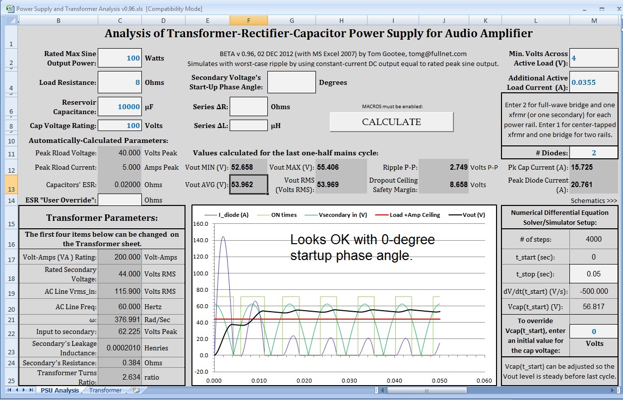

Added Variable AC Line Phase Angle
I should have thought of this sooner.
There is now a user-entry field for the phase angle of the secondary winding's AC input voltage. It can be varied from -90 degress to +90 degrees.
The secondary's AC input voltage is modeled with cos(wt+p). So with the phase angle p = 0, or missing as it was until now, the AC input voltage was at its maximum, at startup. Now it can be varied to be anywhere from zero to its maximum, on either the up-slope or down-slope side of the sinusoid.
Version 0.96 is attached.
Tom

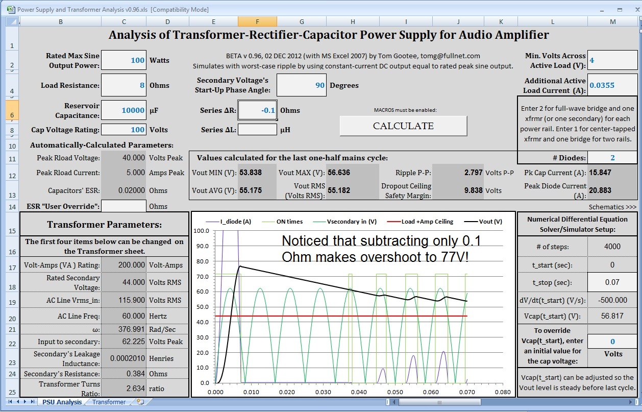

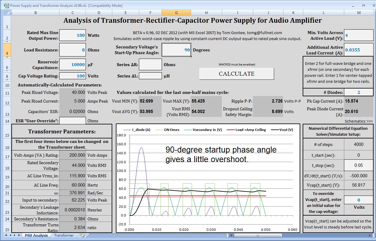

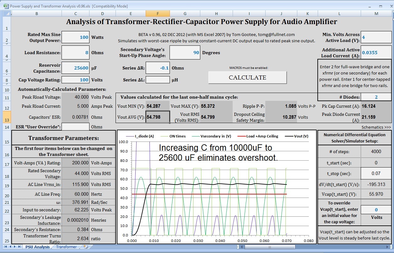

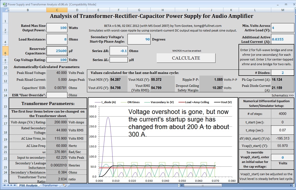

AC Input's Phase Angle Setting Looks Useful
I was just playing around with the new phase angle setting and it looks like it could be very useful.
The following is just an example, from me just playing with the phase angle setting for the first time, but it might illustrate some of the potential utility of the power supply simulation spreadsheet, and the newly-added phase angle setting for the AC input voltage:
I started out with 10000uF, 100 Watts, 8 Ohms, with a 200VA/44V transformer, with the AC input phase angle at the default zero degrees. (See attached plot.)
I changed the phase angle to 90 degrees, so that the cosine looks like a sine, i.e. it starts at zero. I noticed a much faster rise-time and some overshoot. (See attached plot.)
I wondered if the overshoot would be larger if there was less resistance in the transformer or wiring so I added a "negative 0.1-Ohm" delta-R, to subtract 0.1 Ohm from the series resistance. Wow. The overshoot increased to almost 77 V (versus the nominal 55V or so), i.e. almost to 40%!
I decided to see if adding capacitance could tame the overshoot. I found that by tweaking the C value I could get either overshoot or undershoot. Just for fun, I tuned the C value to 25600 uF, to get no overshoot or undershoot.
For our much-earlier discussion: This looks like it might sometimes be another possible consideration or reason to increase or decrease the C value.
Unfortunately, there is a trade-off, as always, and we can see that in order to eliminate the large voltage overshoot by (in this case) raising C, it would increase the startup current surge by about 50%, in this particular case. Adding 0.1 Ohm to such a circuit might be a better option.
Later,
Tom

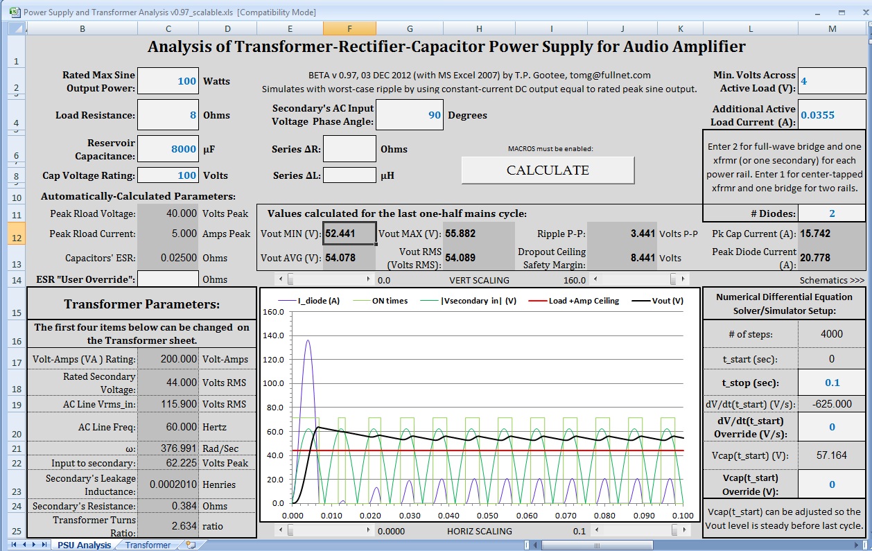

I'll look forward to any suggestions you have. An image of the latest (unreleased) version's user interface screen is attached.
Tom

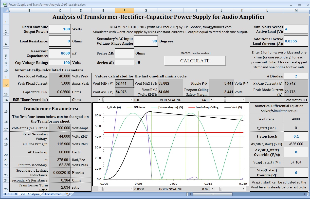

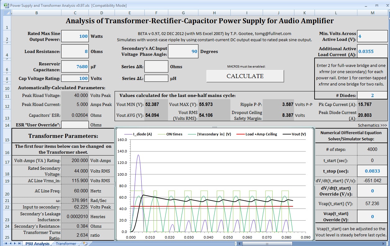

I didn't want to post new versions so often. But the new scalable plot axes in this one are very nice (or maybe I'm just amazed that I got them working). And I probably won't be adding anything else, extremely soon.
I was able to figure out how to add a "slider" control for the minimum and maximum value for each axis. So now you can zoom in on any part of a plot, very easily and quickly.
As I already mentioned, I have also added a "user override" for the initial value of the rate of change of the capacitor voltage.
I have also attached in inage of the main screen.
Enjoy.
Tom

Attached screen image shows the two "axis max" sliders used to zoom in near the origin of the plot.
I made it so that the maximum and minimum axis values are printed right next to the sliders, which makes them fairly easy to use. Maybe someday I'll figure out how to do the same thing by dragging a rectangle arond the area you want to zoom to. That would be excellent. And apparently the code I already have for the sliders would work almost directly, since it uses the four "corner values". I just don't know how to get the plot coordinates for the corners of the rectangle from a mouse click-and-drag on a plot. I did see something online that looked like it told how to do that, though.
Tom
