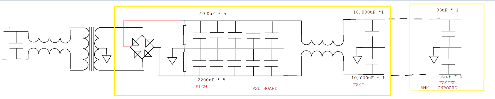

Is that a common-mode or differential-mode choke? Either would be inappropriate in that position. CM-mode would fail because you have grounds either side of it, thus removing any small benefit from it. DM-mode would fail because you can't assume that the two ripple currents/voltages will be the same.
Two separate chokes would work, but for some strange reason CM-mode chokes have suddenly become popular and so get sprinkled around circuits like magic dust.
Thanks for making it easy for me, by asking a question and answering it in the same thread. Now that's team work 🙂

I didn't answer my own question. I just pointed out why either answer would be wrong. Of course it could be that the apparent coupled chokes in your PSU circuit are not coupled at all but merely drawn badly. Separate chokes in the two lines would work, but one of them would be unnecessary.OnAudio said:Thanks for making it easy for me, by asking a question and answering it in the same thread. Now that's team work
Despite the abuse of the choke symbol, they are all necessary. The conceptual model is correct in relation to the theory behind it as well as supporting field studies. The first set of chokes make up the line filter. In most PSU the chokes between the caps are replaced by a resistor or a pi filter, the purpose is the same.
My apologies. I should have made it clear that I was talking about the second choke. The first choke may do some good. Sorry for any confusion.

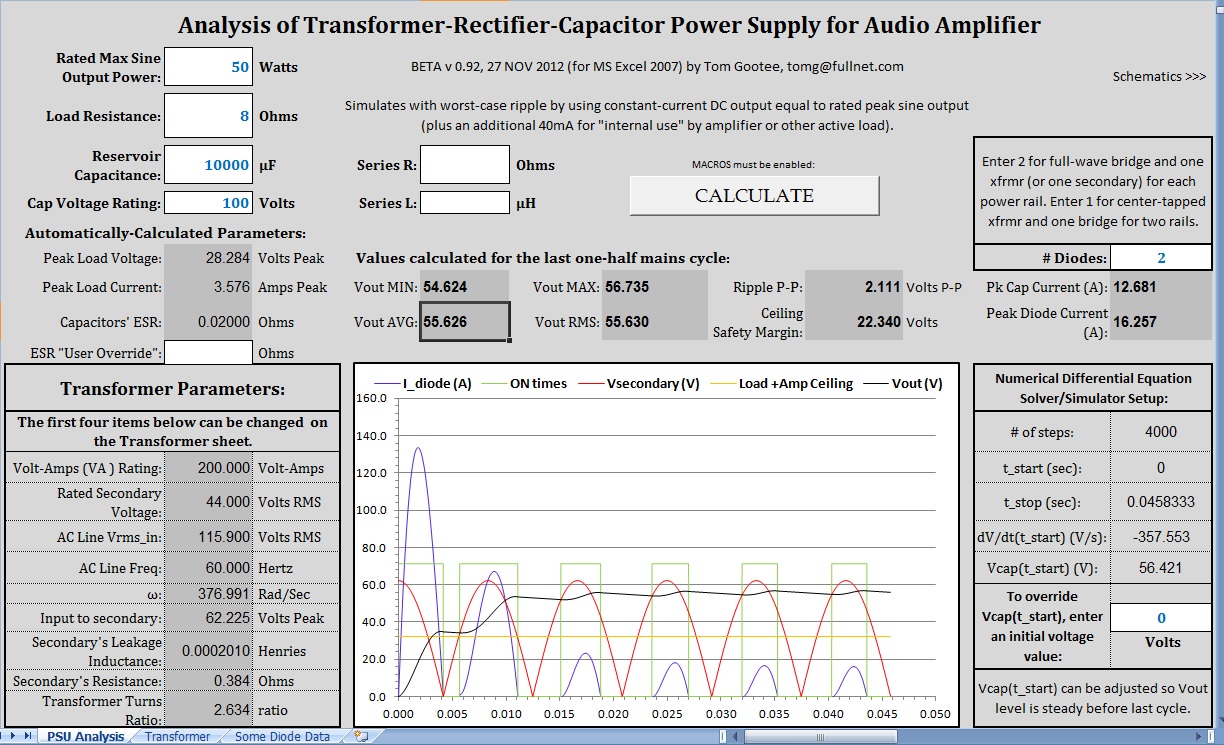

Who wants to be a beta-tester, for my spreadsheet? It's attached. I did it with Excel 2007 but saved it as a plain .xls file, so it might work with older versions of Excel.
It actually emulates the second-order differential equation for a transformer-rectifier-capacitor circuit, including leakage inductance and resistance of the transformer windings, and uses a non-linear model of diode resistance vs current. It uses a fourth-order Runge-Kutta iteration algorithm.
It automatically switches back and forth between the full second-order equation and a first-order one, depending on whether or not a charging pulse is occurring. So it can accurately plot the output waveforms versus time.
It also includes the scalable transformer modeling from measurements. So you can change the transformer size and ratings at will, and can use any transformer you can measure.
You get to enter some parameters and it calculates everything else, and plots some of it. It also has provisions for overriding the calculated capacitor ESR value. And you can enter an additional series resistance and an additional series inductance, if you want. I've attached a jpeg image of the main screen.
It works really well but there are a few things I'm still not certain are correct, such as the diode modeling for different circuit topologies, and the way the transformer parameters are used. But it closely matches my LT-Spice simulations for "normal" cases.
It does NOT yet let you specify a ripple amplitude and pick a capacitance for you. I'm just trying to get the basic analysis correct, with this one. But it's still a very useful tool.
Also, it's very slow. It evaluates the differential equation 4000 times, to produce a few tens of milliseconds of output. So it takes about 40 seconds to calculate, on my little computer. But it also provides things like min and max output voltage, rms and avg output voltage, ripple amplitude, peak diode and capacitor currents, et al.
I think it should be quite useful.
Note that you have to enable macros, in Excel, for the Calculate button to work.
Let me know what you find wrong with its current capabilities.
Tom

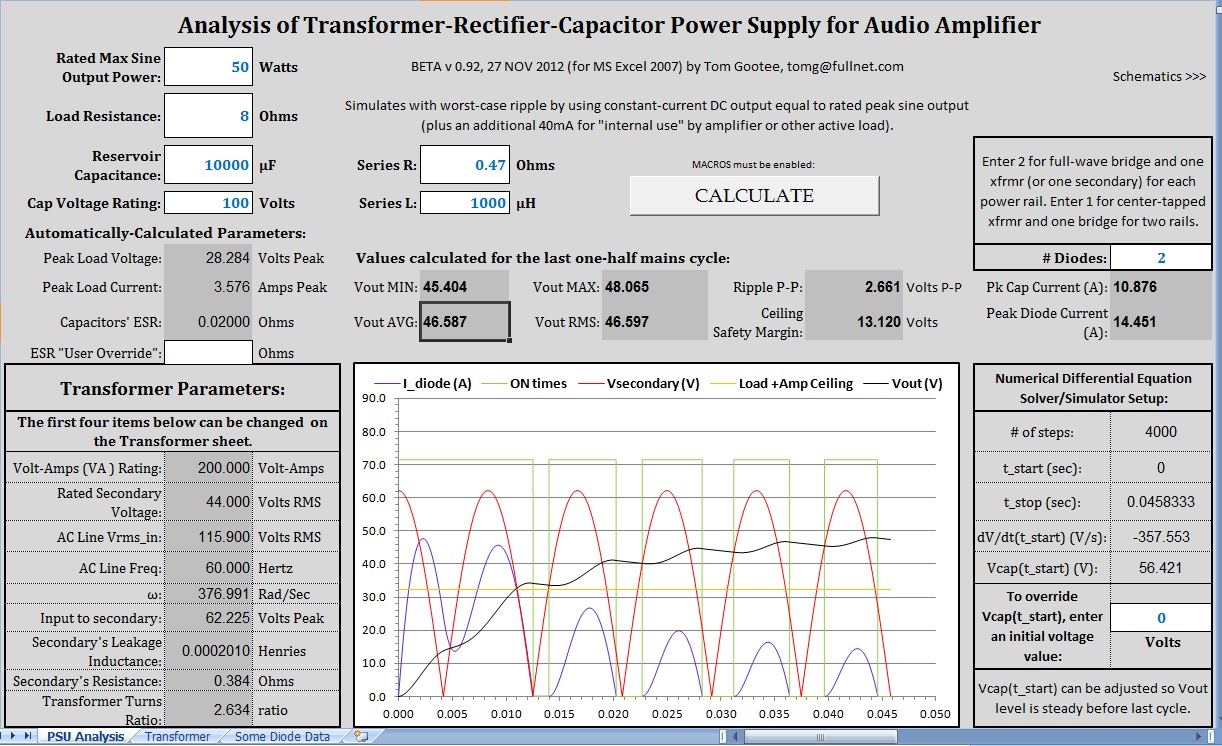

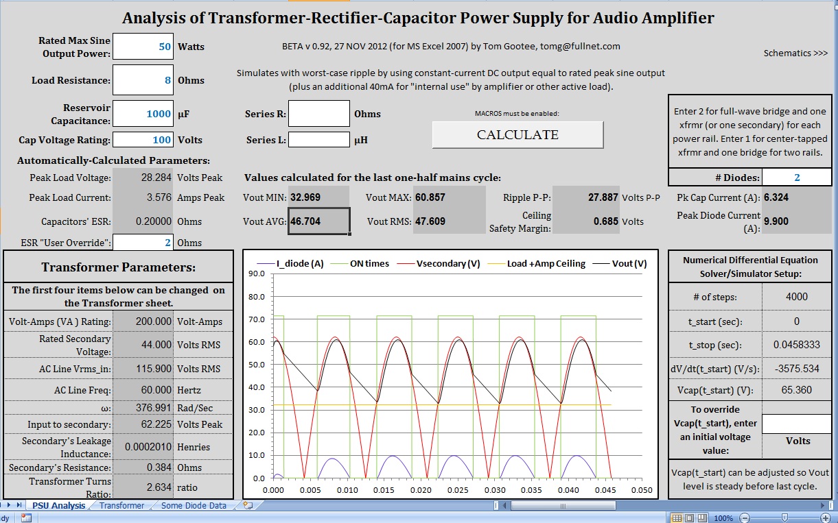

Here's one with a plot of startup from zero volts with a 10000uF cap drawing a 135 Amp current spike (althought spice gives closer to 150 Amps for this case).
And the second one shows what happened at startup after I inserted a randomly-chosen 0.47 Ohm resistor and 1 mH inductor in series in the power rail, before the cap.
The last two show what can happen when ESR is increased from 0.2 to 2.0 Ohms.

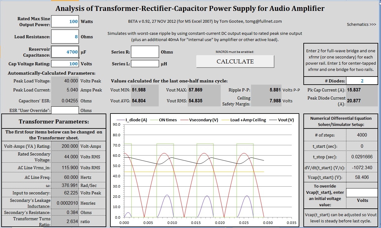

Hi, Nico!
It should be a pretty good tool. It's just a "what if" analyzer. You can put in your max rated power, load resistance, and the reservoir capacitance, and it will then show you what the power supply output voltage would look like, with a worst-case constant-current load.
And it also finds and displays the minimum and maximum of the output voltage, and its average and RMS values, and the ripple voltage amplitude, and the peak diode and capacitor currents.
It also shows an assumed "dropout" voltage level, which is just the maximum output signal voltage (PLUS 4 volts for the region where the amplifier lives), so you can see whenever the rail voltage (Vout) dips down into that forbidden zone.
With all of that, and since it also takes into account the transformer size (VA rating), and the transformer size and the other transformer ratings can also be changed, it should be quite useful.
I originally only meant for it to be able to give the steady-state output conditions. But it looks like it does the transient response (i.e. startup from zero volts) perfectly well, too.
However, for larger capacitance values, the displayed time duration won't be long-enough to see both the transient response and the final result. You could increase the t_stop time, to see more of the response, but unless the number of steps is also increased, the accuracy goes down as t_stop goes up. Changing the number of steps is also possible, but then you would need to right-click in each plot and use "Select Data" and go in and Edit each plot's data range, to increase the final row number for each y-axis range.
So, you can change the Vcap(t_start) initial voltage, on the lower right of the screen, to zero, to see the startup transient behavior, subject to the time-duration and #steps discussion above.
But also keep in mind that the Vcap(t_start) voltage might also need to be tweaked even when looking at only the final steady-state response, mainly for cases where the capacitance is very large. I chose an expression to try to determine the initial Vcap voltage so that it would be near the final steady-state output level but if that's not almost exactly right, then for a very large capacitance the output waveform might still be slewing toward another voltage level by the time t_stop is reached and then the displayed max, min, avg, rms, etc, will not be correct, since they are only looking at the last cycle of whatever is displayed. So if the plot hasn't become "flat" (steady) before the last cycle, then simply enter an override value for the Vcap(t_start) voltage, so that it starts closer to the correct final voltage level.
At the last minute, I also added the "Series R" and "Series L" entries. Using those, you can add a resistor and/or and inductor, in series with the voltage rail, before the capacitor. A lot of people here have discussed adding a resistor or a choke into a power supply circuit. Now they can see how it would affect the output voltage's characteristics. (If anyone wants to use multiple parallel reservoir caps, with an R and/or L in series between some of them: Use LT-Spice!)
I also added the "ESR Override" entry field, so that people could adjust the capacitor ESR value. That might be necessary if multiple paralleled caps are used, for example, and when a specific model of capacitor has been selected and its ESR is known, and when comparing specific capacitors with known ESR values, and, of course, just to investigate "what if" scenarios.
Last but not least, I added the "# of Diodes" entry field, which can be either 1 or 2. That is meant to enable the equations to be valid for multiple circuit topologies, depending on the #diodes entry. The "1" case should make the results valid for a center-tapped transformer with one bridge rectifier supplying two voltage rails, with the center tap as the ground between the rails. The "2" case should work for two transformers (or two non-connected secondaries of one transformer), each with a rectifier bridge supplying one rail, with the output ground ends of the two bridges both connected to the ground between the rails.
Here is what I am not certain about: The circuit equation that is used actually has only one diode resistance, as a function of the diode current. So for #diodes=2 the idea was to just double the diode resistance. But I haven't actually verified, mathematically, that it will work correctly, that way. I just need to draw out the schematic for that case and write down the voltages around the loop and see if the equation being used is still valid, but haven't done it yet. I would guess that it should be OK, as is, but need to verify it.
