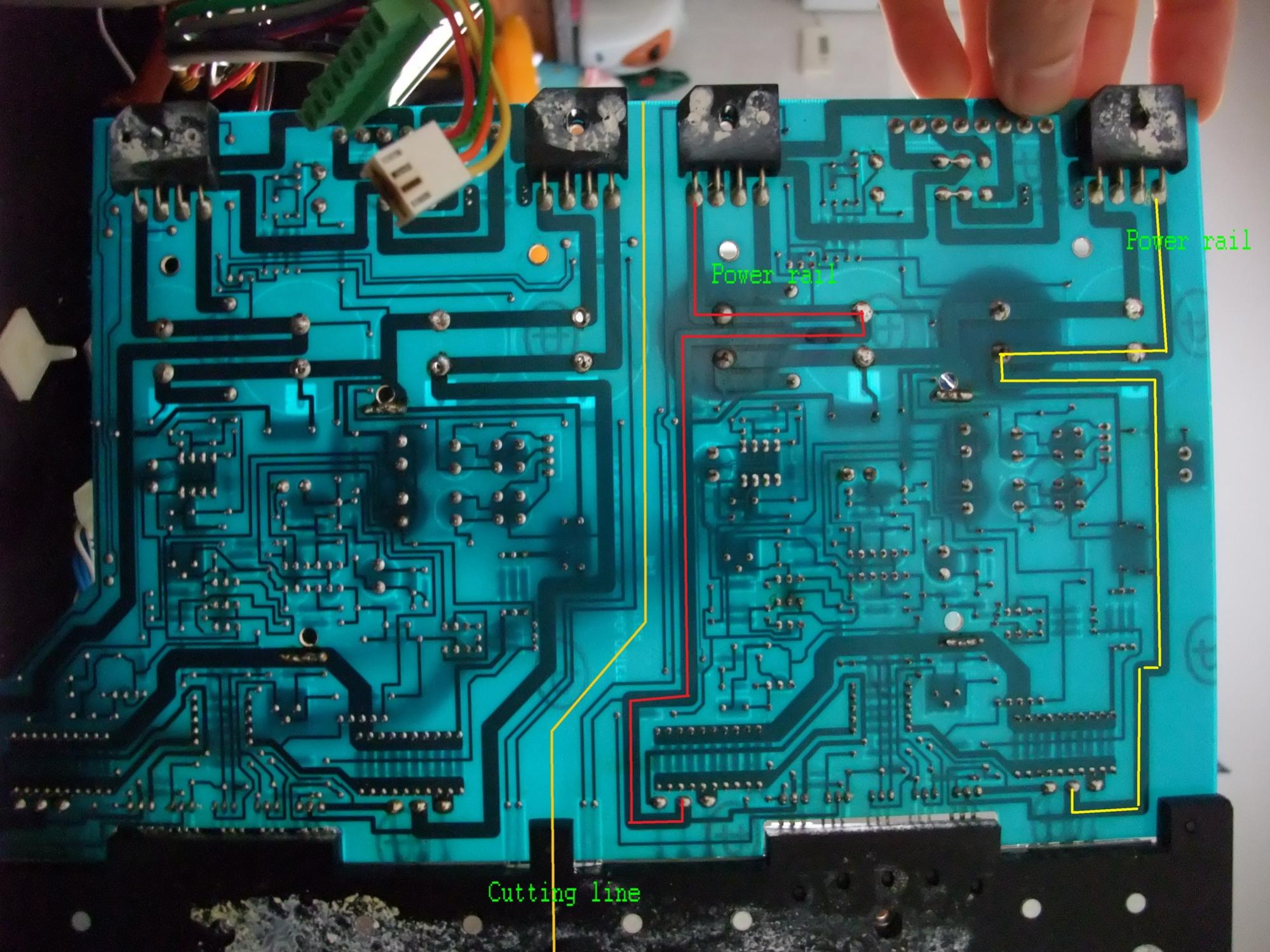

For example, the power amp I'm trying to fix has left and right speaker wires twisted together (where each pole of a channel made of a twisted pair, i.e. two wires of same polarity) and twisted with L and R input wires... this almost shocked me, since going from memory I would place L and R channels as far as possible (and the same between input and output)...
Stefano
twisting any differential pair together (eg + & - speaker wires) is a good thing. It reduces the loop inductance and adjacent loops face opposite directions so their magnetic fields tend to cancel out, making them much worse antennas. Its reciprocal too - externally imposed fields induce opposing currents in adjacent loops, which again tend to cancel out. Antennas are inherently reciprocal devices. an EMI engineers job is to make lousy antennas whereas an RF engineers job is to make good ones. all the same principles though.
So twisting the output leads together is good, as is twisting the input leads together.
It would be safe to say the output leads are a source of stray H fields (low output Z) whereas the input leads are good receptors (high Z), so twisting the outputs reduces the (internally emitted) stray H fields, and twisting the input leads reduces their ability to pick up stray H fields. IOW this reduces the source and stiffens up the receiver.
BUT.....and you knew there would be a but....
1. sticking the input and output leads in close proximity maximises what little magnetic coupling there is, so is a dumb idea - separation is almost always a good thing, but physical constraints mean it can only achieve so much, which is why twisting is so important. and after going to all that effort, bundling the twisted pairs together is just stupid.
2. twisting them together at the same time can negate any inductance-cancelling effects. if I have two twisted pairs with the exact same sized loops side-by-side, then the Rx loop is always in phase with the Tx loop (yeah this is highly unlikely in practice, which is why Cat5 cable works). But if I grab a bundle of wires and then twist them, I get the same effect - there is in effect no twisting between source and receiver. This is the worst way to do it!
3. thats just H fields. E fields are unaffected by twisting, they are capacitively coupled. sure dV/dt isnt going to be that high, but capacitance is inversely proportional to separation, so placing the input and output leads together maximises capacitive coupling, and is downright stupid.
So in conclusion: you are right to be shocked, that wiring harness is a good example of what not to do!
PS the really funny bit is the transformer wires are not twisted - and they carry the largest currents of all. Doh!

KindHornMan @ #821 - ye gods, you are indeed the worst-case scenario.
every single untwisted pair will generate a ton of DM noise. twist everything, and use combined DM/CM filters. You might also want to put EMI gaskets on your enclosures - or at least fold edges over to provide a barrier to plane waves (the longest dimension of a slot is the critical one - so for the junction between a lid and an enclosure thats the length of the side (or between adjacent screws), rather than the gap between lid and enclosure. returns are a simple way of getting extra attenuation. A flat plate for a lid might as well not be there at moderately high frequencies.

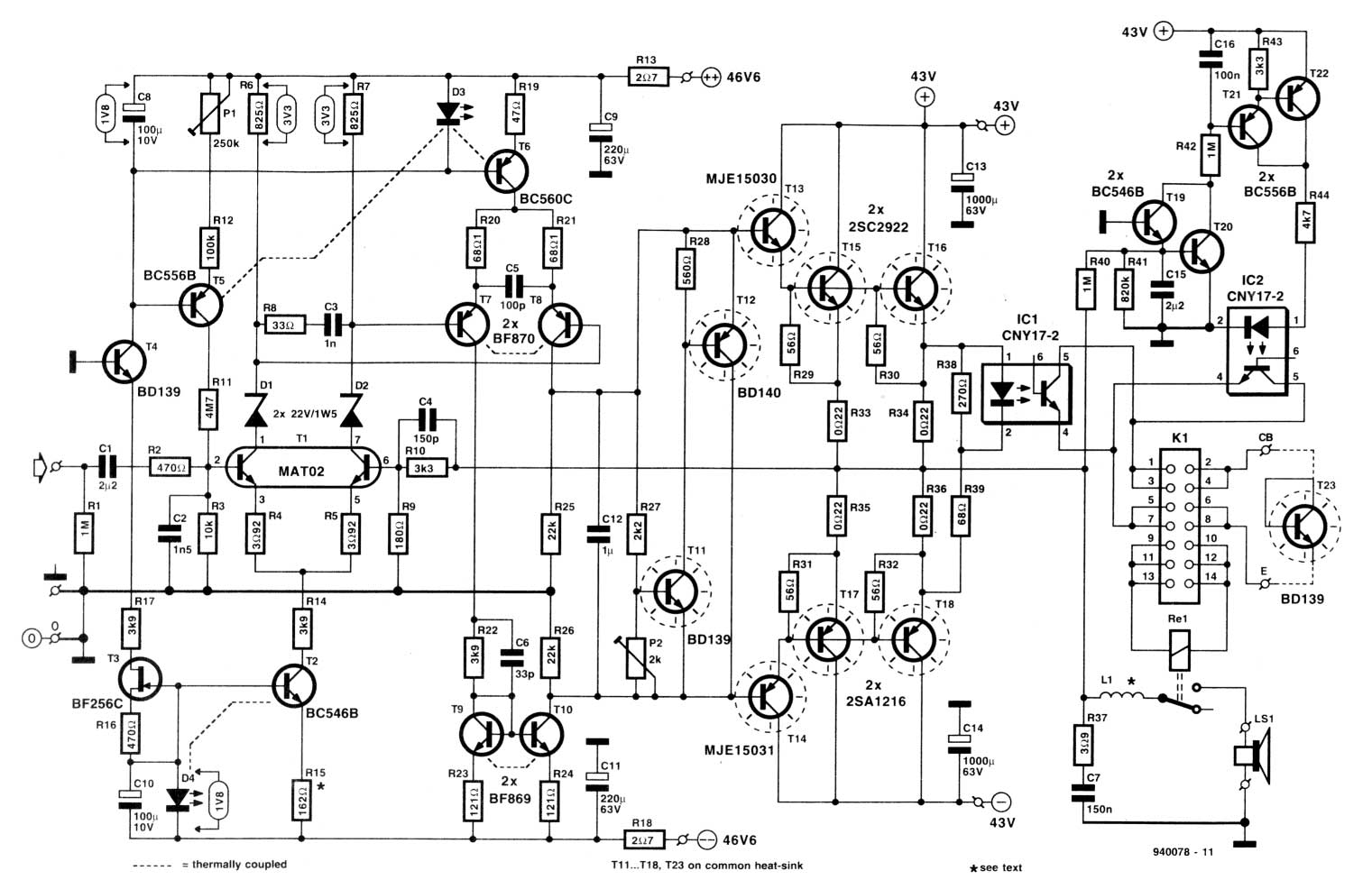

Thanks a lot Terry for your kind feedback,
I added the shots of trafos and their wire just for that purpose. It seems the manufacturer decided to squeeze in a single box two separable power amps, with a less than smart PCB and wiring topology. Toroids wire seems too short to allow twisting. But the two power amps seems really sharing only the power switch and the fuse, so I'm thinking (fool?) of cutting the PCB in order to have one L unit and one R unit and rewire by separating input and output (the best would perhaps be input on one side, output on the other side?).
Trying not to to stay too much off-topic, actual PSU has 40000uF per channel, yet rails are really much longer than a couple of inches, so for sure there's a high inductive component opposing current demand of the Sanken output pair (and I don't like the "S" made by the rails in order to reach the second cap of each rail). Forgive my dumbness, is the addictive "local" capacitance to be added like on the attached schema, downloaded from http://www.audiofanatic.it/Schemi/Tipo/Stato_solido/finali/pic_finaliSS/200W_2SC2922_2SA1216.jpg?? The schema sports only two elcos C13 and C14, while - as per your findings - I would add a parallel of more elcos, a film cap and a snubber.

not meant to enhance entropy, but do you think the local capacitance "effective" sizing is a function of output power (and or device Imax rating)? Finally I'm starting thinking that these capacitance is way more important than that one near the rectifiers and might end up being the larger one, although made of several paralleled units. If so, we might "save" on the caps nearer the rectifiers, just to have a voltage not too "jumpy" on the rails. Of course we have a similar reasoning for the VAS stage.
Nothing different from what you already showed, but I'd like to know if this "sounds" reasonable.
