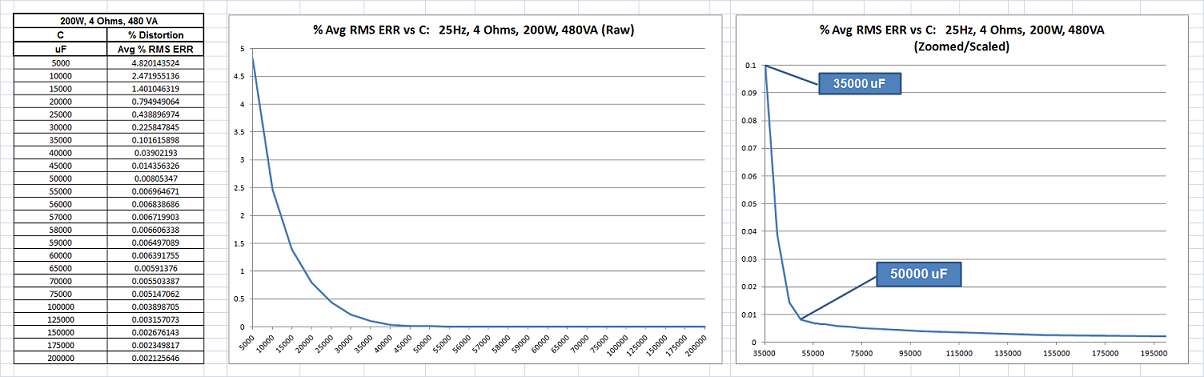

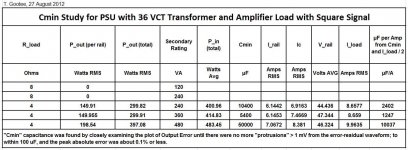

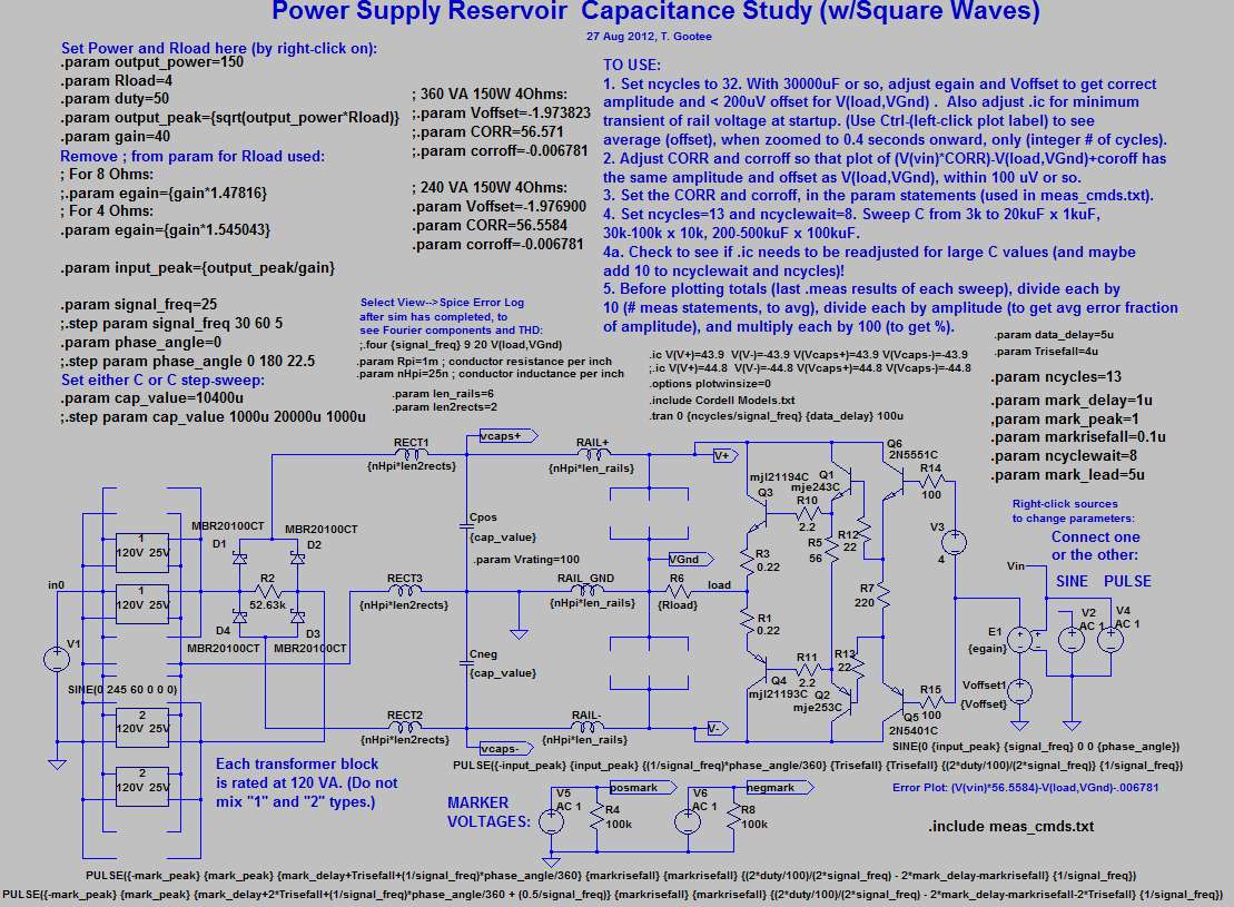

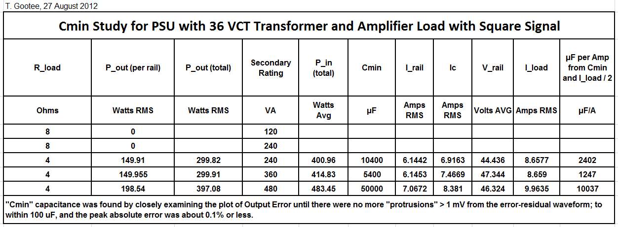

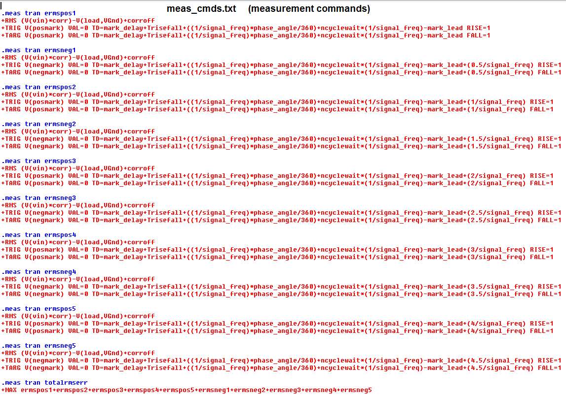

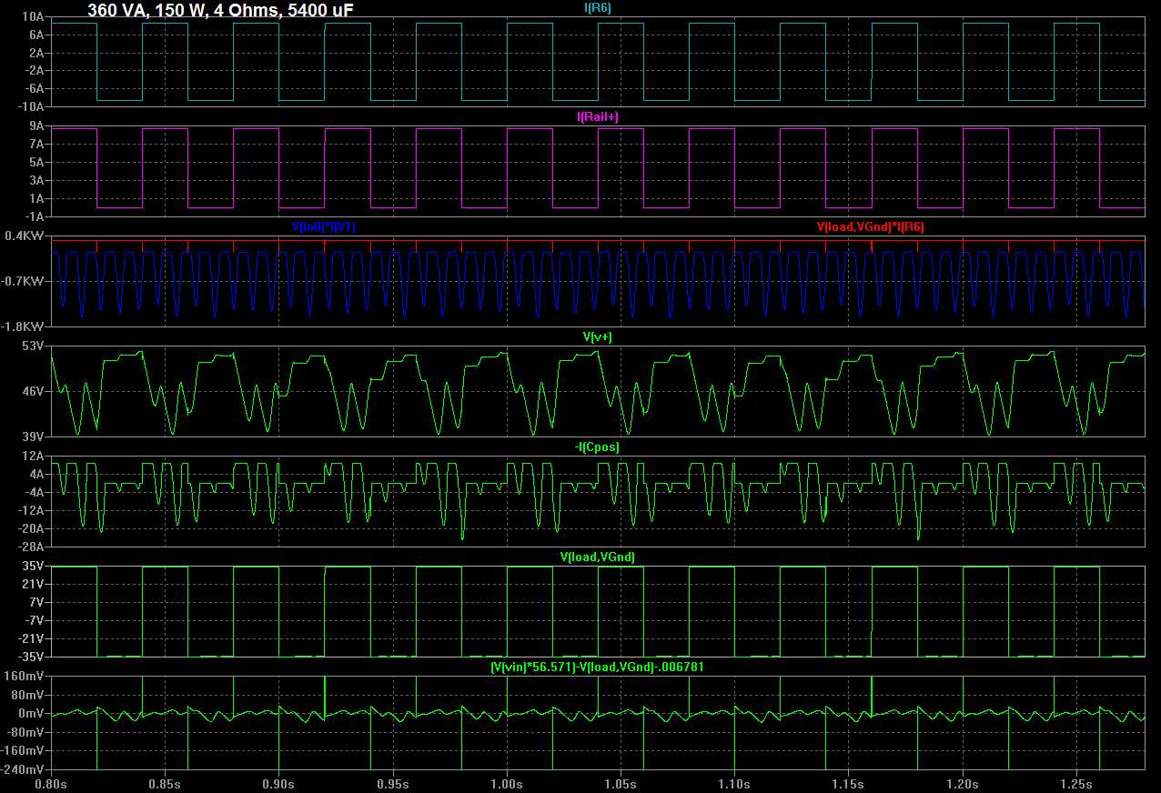

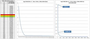

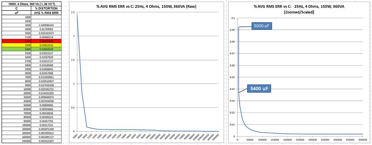

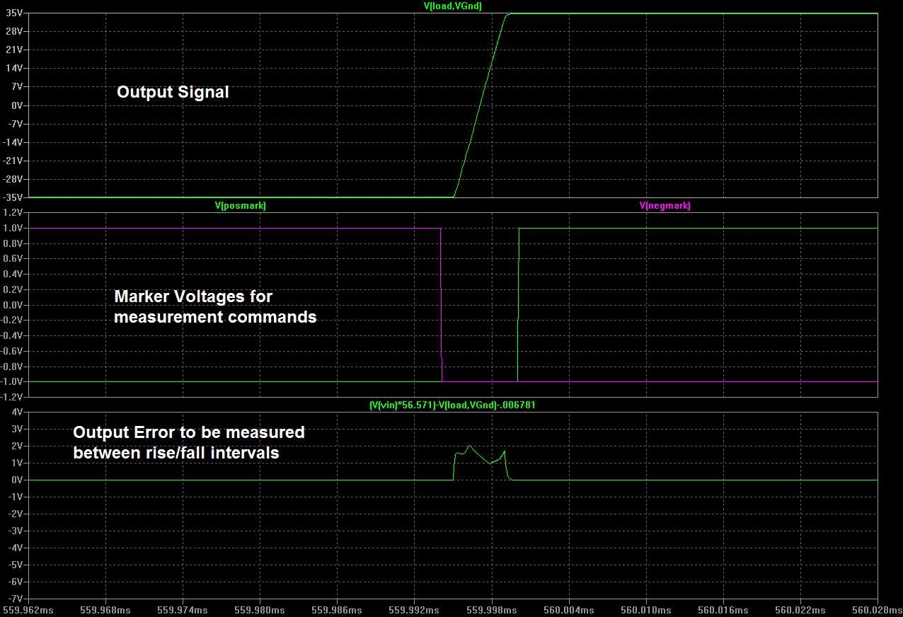

Attached are a few results for the Cmin reservoir capacitance, with square waves.
Not enough data for comparisons etc, yet, but:
The 360 VA-per-secondary case for 4 Ohms and 150 Watts looks reasonable.
It looks like 240 VA per secondary is either working hard to get 150 Watts into 4 Ohms, or, the 360VA secondaries finds it to be very easy.
And even 480 VA per secondary looks very close to not being enough for 200 Watts into 4 Ohms, with only a 36 Volt transformer output.
Tom
Tom,
I know that it isn't a 1 to 1 ratio but could you approximately double the values for an 8ohm load and have reasonable values? I was surprised how much higher the Cmin value was when you increased the power output from 150 to about 200 watts at 4 ohms. It looks like a steep gain in capacitance value for a 30% increase in power output.
Tom,
Yeah, but the transformer VOLTAGE is then apparently way too LOW, for that (200 Watts), so it needs a whole lot more C just to keep the voltage and current ripple in the right zones, otherwise the signal gets bashed. (Or, maybe the crappy transformer model has something to do with it. I haven't done the calculations for that case.)
Tom,
For an 8 Ohm load instead of 4 Ohms, you would divide them by two, rather than double them.
See the results for sine signals, which also include some 8-Ohm cases, in Post 740, at:
http://www.diyaudio.com/forums/solid-state/216409-power-supply-resevoir-size-74.html#post3134179
Tom
So, DF, Terry, Fas, and other experts: Square-wave testing, with peak values equal to the peak sine values previously used, as in post 846, should be comparable to using a sine load current's or voltage's peak value instead of its RMS value, as the DC load current or voltage when calculating ripple and the needed reservoir capacitance using the standard approximate formulas, correct?
So it's like using double the power as a worst-case design margin, and throwing in huge fast transients, too.
So something like a 600VA transformer would handle the ripple problem with half the capacitor value then?
Not sure what we're comparing to. But increasing the VA "can", sometimes, enable lowering the minimum capacitance while still not bashing the signal. But that only works well if you're in a comfortable operating area for the transformer output voltage.
You want enough headroom, with the transformer output voltage. Then you can use reasonable and predictable capacitance values, and a reasonable and predictable VA rating.
If I had cranked up the input voltage for the 200 Watt case, the minimum required capacitance would have dropped quickly. At some point, I might try to parameterize the secondary voltage and fix one or two of the other parameters and see what other types of plots might be useful or enlightening.

Actually, I already DID do that. I was merely asking about the relative equivalence to the calculations for sines.
Using the same average output power for the square wave as for the sine wave was discussed and tried already. It results in nothing interesting being learned, since the voltage peaks are then too low to challenge the power supply.
The idea behind using the full-peak square waves as the test signal was to find something close to the worst-possible case that the reservoir caps and power supply would ever have to be able to handle, such that if the worst case could be handled without the possibility of any distortion that was due to the power supply "choking on it", then maybe one could "truly" be CERTAIN that any and all music that did not exceed that peak voltage could also be handled without any PSU-induced problem.
Also, conveniently, the square waveform covers half of the total time during which a sine peak could have occurred, requiring testing of only two phase angle cases, i.e. 0 and 180 degrees, whereas with a sine as the test signal we would need to test at many, many phase angles, to try to ensure that the worst-case alignment of the test peak with the PSU's charging pulses and ripple voltage waveform's troughs had actually gotten tested.
A single sine seems to obviously not be the worst case for testing the PSU's robustness. All we would have to do to make it worse would be to play more than one sine at a time, so that there were more peaks in each unit of time. If we had enough tones playing at once, with different relative phase angles, then the peak level would be completely filled with sine peaks and would look like the top of a square wave.
Actually, it could be much worse than that, and far worse than even the square wave, whenever there were multiple tones and their peaks happened to line up with each other in time and all overlap, i.e. all be in phase, even if just for an instant. Then their peak values would be SUMMED, and the resultant peak voltage could try to be MUCH higher than we anticipated, very possibly far above the transformer output voltage. But I guess we are allowed to assume that the volume control will be set at an appropriate level, to avoid such problems.
At any rate, any particular frequency of square wave is only about HALF as bad as it could very-easily get. All we'd need, to make it immediately almost twice (2X) as difficult for the reservoir caps would be a square wave of half the frequency, which would draw from the caps for twice as long at a time.
We should also expect that a fixed maximum-peak-value DC signal voltage could be applied. But I don't think we'd be worrying about the PSU distorting its sound, if that happened.
So very-low-frequency square waves with peaks at the expected peak sine voltage seem like a pretty good test. The lowest frequency of square waves that can be handled gracefully might even be a good additional general "figure of merit" to use, for a PSU.
For a particular transformer voltage and V-A rating, it looks like we should be able to literally "assume", with high confidence, that we should never need to use more than the Cmin value that worked during the peak-level square-wave testing.
I will also note that this type of test seems like it might be relatively easy and practical to implement on our test benches, with a square wave small-signal source and an oscilloscope: Just add capacitance until the amplifier's output square wave looks good-enough. Then it should be "guaranteed bullet-proof" for real music signals.
Of course we still need to figure out and agree on what frequency of square wave is "low-enough", for this type of test, and what is an acceptable maximum amount of distortion of the square wave.
In my most-recent (square wave) testing, I more-or-less tried to keep any individual instant's peak deviation (i.e. the max error) of the output voltage (versus the theoretical ideal output voltage) to less than 0.1% of the expected ideal peak output voltage, while also rejecting any PSU-induced "gouging" of the output voltage waveform that further-deviated by more than 1 mV (while still also keeping the maximum error within 0.1% of the ideal peak output voltage, including the 1 mV or less).
The only "problem" I still perceive, throughout the above discussion, is the uncertainty of the degree of "overkill" in the Cmin values obtained with the square-wave method described. (i.e. "A Cmin that's too large is not the real Cmin.")
