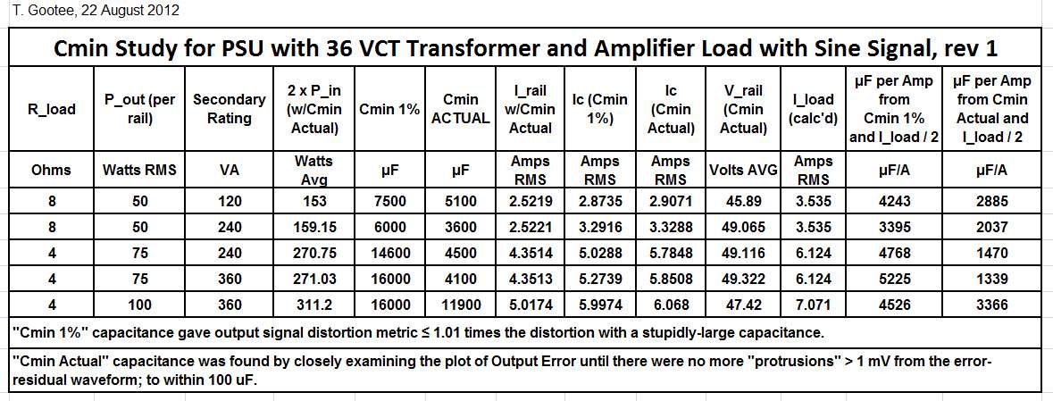

Speaker (frequency response) support: AndrewT's post at #759 "amplifier must be able to perform well down to ~ 2Hz to 3Hz"
Conflicts with: 8 ohm speaker, 50 watts, 240 va, Cmin Actual of 3600uF.
That chart has a narrow sample range.

"With such a broad range, a minimum required capacitance line graph will be fascinating (and an easy read if capacitance per watt). I'm sure that yours will be much more accurate than mine".
If the case for this argument could be taken to be realistic could not there be a chart showing two lines. One line showing the minimum transformer size and matching large capacitor requirement and a second line with maximized transformer size and the minimum capacitor values given a stated load impedance at the loudspeaker and power output maximum with 0.1% distortion requirement? This would seem to give a min/max SOA area of choice for the two components.
I will look into expanding the table I made, Daniel.
