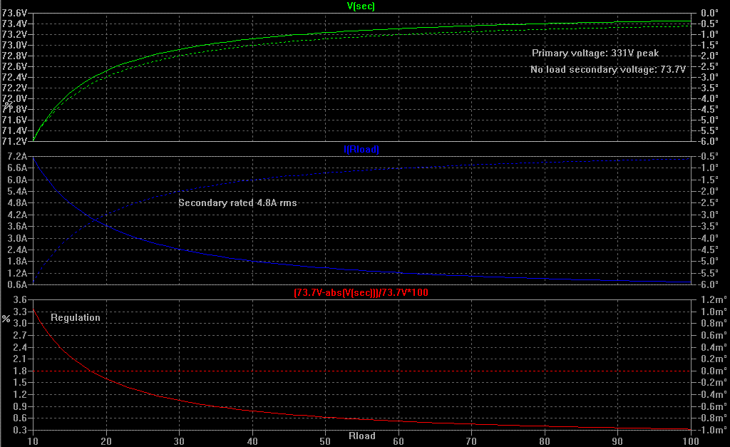

Gootee, or anyone else,
can you simulate a simple resistor as a load for the transformer model.
Adjust the resistor value and determine the output voltage for that new load.
This will allow a plot of regulation vs load current.
From that we can estimate what size of real transformer roughly matches the model performance.

Andrew, will something like this do the job?Gootee, or anyone else,
This matches the model I've been using so far; unrealistically high primary, and hence secondary, voltages but it's just a tool to explore what's going on in this PS/amp interaction ...

Am I reading the plots correctly?Andrew, will something like this do the job?
Frank
At infinite load resistance: Vout = 73.7Vpk
At 10r load resistance: Vout = 71.2Vpk
At 10r load resistance: Iout = 7.12Apk
VA @ 10r loading = 253
regulation @ 253VA = 3.5%
This would seem to indicate that the transformer model is probably equivalent to a toroid that is quite a bit larger than 253VA, 25.1+25.1Vac
This actual toroid would normally have a 5% to 7% regulation.
