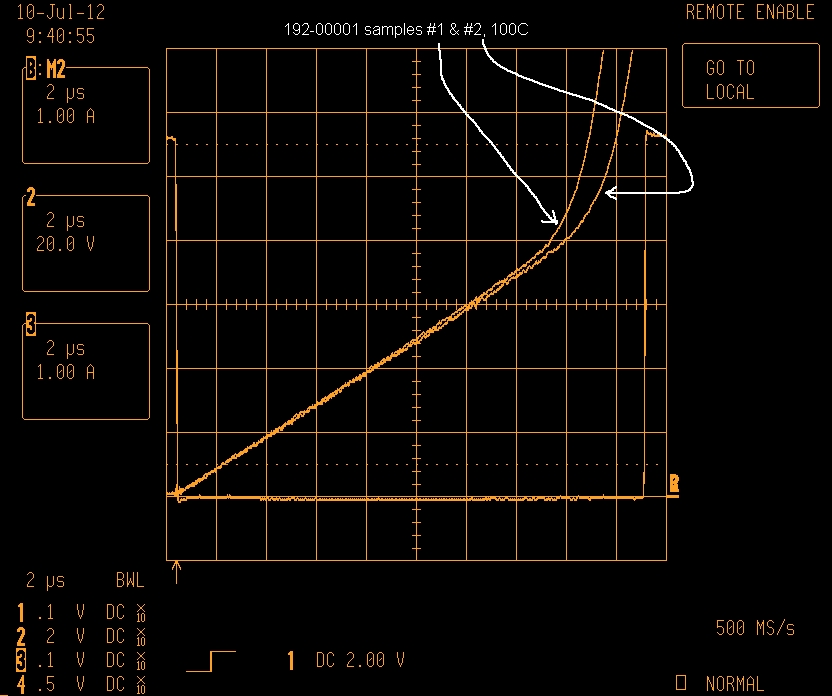

here's the thing though: core materials are non-linear, and typical steels (and ferrites) dont have a sharply defined Bsat (square-loop materials do, but we'll ignore mag-amps here). I like to measure L using a "splat" test - charge a bloody great cap bank to some voltage V, then splat a choke across it and measure Ichoke & Vcap. Vcap = L*dI/dt. assuming C is really big, Vcap ~ constant and for nicely linear materials (eg ferrites) a very straight line results, and L = Vcap*dT/dI
with a ferrite you then get a fairly sharp knee at Bsat, at which point dI/dt skyrockets. as shown in the attachment (PQ26/20 flyback transformer). for less linear materials eg (powdered-)iron, the slope is curvy, but small segments are still pretty straight. and the shift into saturation is much more gradual than shown here - so gradual in fact that it becomes a bit arbitrary. (I do a prestidigitative curve-fit by holding a bit of paper up to the scope, and noting where the trace curves up "too much").
recall the transformer equation: sqrt(2)*Vrms = N*Bmax*Ae*2*pi*Fac

for a given core cross-sectional area Ae, the higher you choose Bmax the lower N becomes. so Lmag gets lower and Imag gets higher, BUT as you move further into saturation, Lmag drops FASTER than expected. this is what gives rise to the strange spiky peaks in the primary current of most unloaded transformers - the core is often saturating quite hard. but it does reduce leakage inductance and copper losses, and save both Cu and Iron. Microwave Oven Transformers push this to absolutely stupid extremes - the first time I repaired a microwave I thought the transformer was faulty, Imag = 6A @ 230V IIRC.
