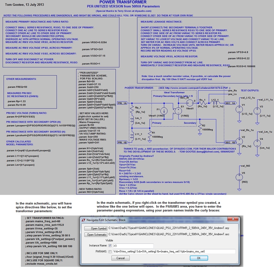

Attached is an image of my original spice transformer simulation circuit, which contains all of the transformer measurement instructions.
But the much better model that I created, after that, with the help of Terry Given, is SCALABLE, i.e. you can change the output voltage, the Volt-Amps rating, the mains voltage, and the mains frequency, and the model parameters are all scaled automatically to reflect the changes! An image of that LT-Spice model is also attached. (Note: I am not sure how the accuracy varies, as the model is scaled.)
Besides using the model in LT-Spice, I also implemented the scalable transformer model in MS Excel, as part of the power supply simulation I created. If you download the spreadsheet and open it, click on the Transformer tab at the bottom, to get to the transformer model. It, too, includes the transformer schematic and the measurement instructions.
MS Excel 2007 version:

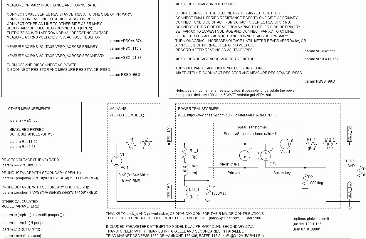

I asked because I wondered if Rp is taken into account, but that was the version linked to from another thread, and now I'm disoriented 😕
Anyway, AFAIK the primary resistance should be in series with the primary current, so that it is effectively reflected to the secondary, as is primary capacitance. Measuring the secondary with DC doesn't take this into account, and your model appears wrong in this respect. I might be missing something though.

Did you also see all of the AC measurements that were made?
Anyway, it's not my model. There is a link to an OnSemi appnote PDF file, right on the schematic. Christophe Basso justifies the model fairly well, in the appnote, in my opinion.

The preparation of the model was with the assistance of Terry Given, who is an experienced professional magnetics expert.
The model includes the primary and secondary resistances and leakage inductances, and the primary magnetizing inductance.
I believe that it is sufficiently accurate for simulation of linear power supplies for audio power amplifiers, as long as it isn't scaled too far away from the initially-measured parameters.
But it is always the user's responsibility to validate and verify any model they choose to use.

My point is simply that the primary winding resistance should be in series with the magnetising current, and as far as I can see in gootee's simulations, it isn't. The significance of this depends on judgement and the particular application of the model, as always.
I have tried to explain the implications. Being not especially knowledgeable or clever, I may not have been clear. I might have missed something in the model so I might not be entirely correct. I just spotted what seems like a mistake and wished to engage with the issue, thanks.
The application to which the model is put here is related to regulation, i.e. the extent to which loading reduces voltage. That in turn relates to winding resistance. The effective AC resistance of a transformer winding is not just the static resistance of that winding, as might be measured at DC with an ohmmeter, but also includes the reflected resistances of the other windings, in parallel or series as appropriate.
For a simple mains transformer, assuming mains resistance to be insignificant, the effective resistance of the secondary is equal to
Rs + Rp/A²
where A is the turns ratio. The model in question looks to me like it would give just Rs. Numerically the difference may or may not be significant, but conceptually it is of crucial importance to understanding how transformers work.
Intuitively, considering a transformer is reversible, a model would treat Rp and Rs in exactly the same way, but the model in question treats them very differently. That may work for some purposes but not others, and certainly confuses the issue conceptually.
The objection more serious to my mind is that the mistake promulgates the myth that bigger is better when specifying transformers, and possibly that toroids are better than EI, simply because regulation is lower, so there is less droop at peak demand. This ignores the perils of under-loading.
A commercial general-purpose mains transformer is likely to be close to saturation when unloaded or lightly loaded. This is especially significant for toroids because of their relatively sharp saturation characteristics. If mains voltage is higher than rated, the condition is exacerbated. This is not generally important because the rated load current will move its operation along the BH curve to its linear region.
One consequence is that an under-loaded transformer is likely to distort more than one at its rated load. Distortion results in mains harmonics which, as they get higher in frequency, may be less well removed by subsequent filtering and more intrusive into the audio. Class A, or shunt regulation, removes the problem by drawing a more constant current from the transformer. The simulation in question however concentrates on the effects of varying current demand.
Now, the mechanism that moves the operation of the transformer from its saturation to its linear region is the voltage drop across the primary inductance, produced by the primary resistance as a result of current drawn from the secondary. Put another way, magnetising current is reduced by the primary resistance in proportion to current drawn from the secondary. If the model does not place primary resistance in series with magnetising current, then this effect disappears.
In summary, the model underestimates regulation and is conceptually misleading. I think both are significant, but others may think otherwise. Genuine engagement with the issue is welcome.

The Basso/OnSemi model that I used is correct, as far as it goes, even if it is difficult for some to understand.
The reference to the paper from which it came was given. Here it is again, in ready-to-click link form:
http://www.onsemi.com/pub_link/Collateral/AN1679-D.PDF
The complete model was also posted, for anyone to simulate, if there were doubts.
If you have a model that also models the core, et al, then why not test both models with the power amplifier that was also modeled, earlier in this thread, to see if there are any significant differences, and let everyone know the results?

was intended for modelling transformers in switch-mode power supplies. Further, its main interest is leakage inductance. An SMPS transformer typically has windings of very low resistance. Leakage is much more important. They work at high frequencies, and core characteristics are very different from mains transformers.
Early in the ramble, the author puts the primary resistance in series with the primary, but later switches it to parallel with no explanation of why, AFAICS. He gets the behaviour near enough, perhaps, because the regulation due to resistance is negligible, and the relationship between Cp, Ll, and Rp is maintained, so filter characteristics may be correct or near enough.
As it stands, it is not appropriate for modelling a mains transformer, where for nearly all purposes leakage is insignificant and resistance is important. It has very limited value as a design tool even for SMPS, because flux is crucial there and it isn't included.
