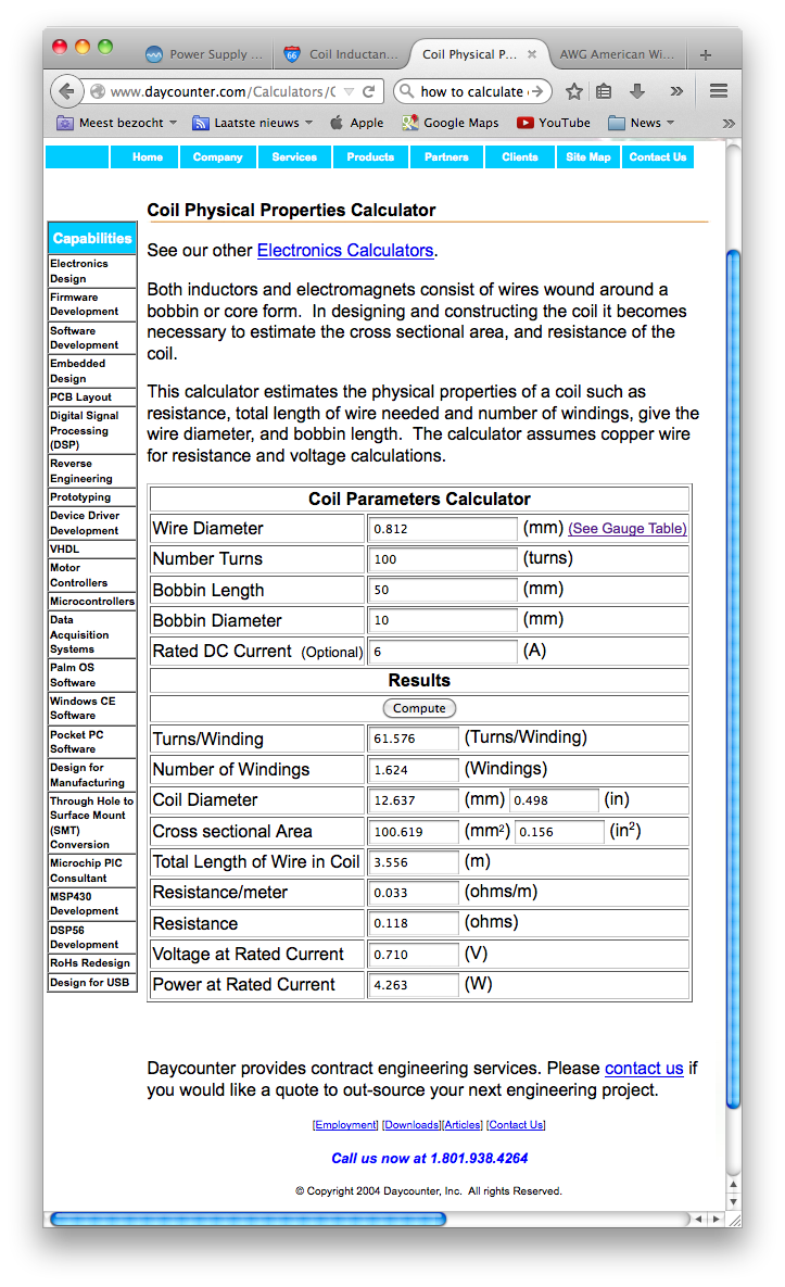

Just to be complete:
Using this calculator for air-cored coil inductance, I found for a 150 turn, 2 winding coil with 0.9mm wire and inductance of 269uH.
Inputting that into f = 1/(2*PI()*SQRT(L*C)) and Z = SQRT(L/C) with my known capacitance of 80mF, I get f=34.4Hz and Z=0.058 Ohms.
PS: After looking a bit harder, I found this coil properties calculator. Is it of any use in this case? [see attached image] This one also allow for inducance calculation on one of it's tabs.
