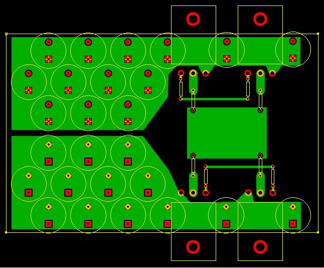

Attached is the drafted design of the output stage PCB.
I guess that the inductance should be low enough for 20kHz.
Each of the capacitors is a Rubycon ZLH 680uF 100V with Z=0.027 at 100kHz.
The ground plane is on the other side of the PCB and is not shown.

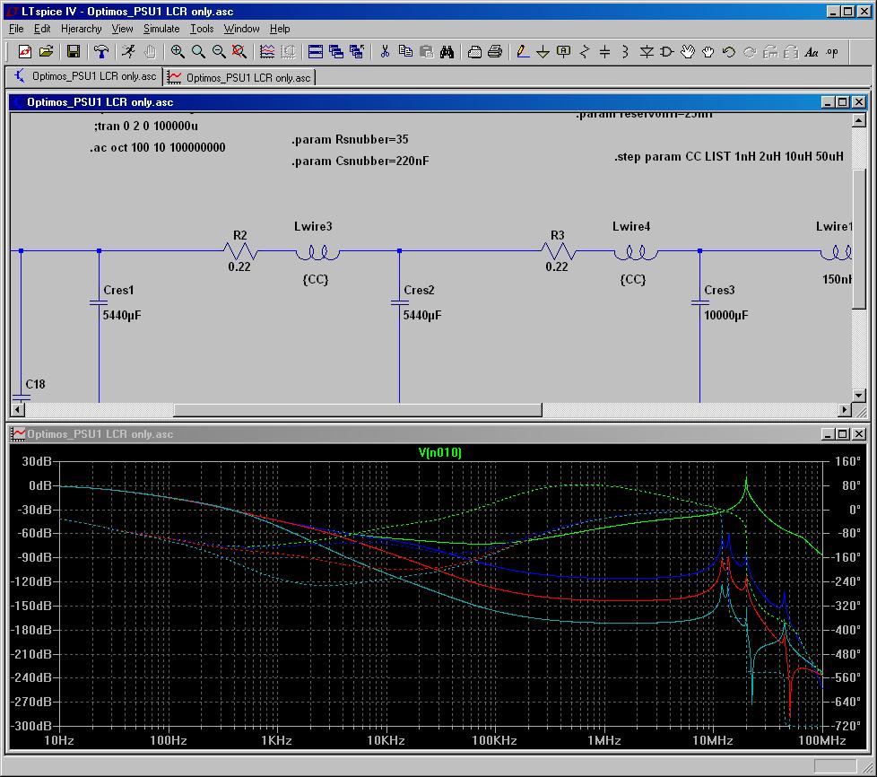

In the attached simulation, the green curve is for no inductors. The blue one is for 2uH. Only this small inductance makes filtering above 50kHz an order of a magnitude better. 10uH (red) and 50uH (cyan) are much better. But there is no reason to go beyond 10-50uH, really.
Without inductors, high frequencies are only attenuated slightly. Note that I have already made the inductance of the capacitors very small (4nH) as they are made up from a large number of small low ESL capacitors in a power / ground plane. If not, the high frequency filtering would be a lot worse.
If I failed with ferrite toroids due to saturation, I may have to use 2uH air core as the last resort.
PSUs really need some low capaictance inductors.
