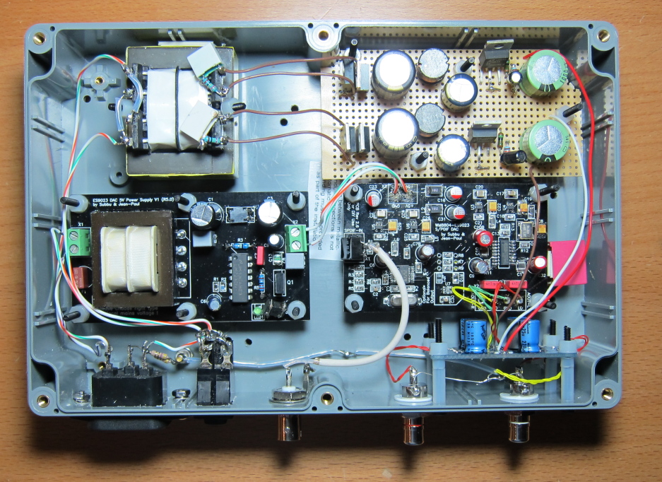

Hi Tome, no measured or even heard humm from the 230 V wiring crossing the output section of the DAC ? Unshielded L + R wiring and 230 V wiring is a big no no in general. You could use 4 extra standoffs and mount an iron sheet connected to PE between the DAC PCB and the wiring.
Advice: I would turn the DAC PCB 180 degrees to the right and also turn the output cover 180 degrees. That way 230 V wiring is centimeters away from the outputs. Then swap the SPDIF and 230 V inputs. So SPDIF (then required) shielded coax wiring will be going over the DAC PCB "ïn the air". That way you will have a technically better performing and measuring device. Very likely also better sounding because of that. Nice looking work though. You see that the designs were meant for wide cases and not narrow and deep cases, sorry for that. In narrow and deep cases probably the power switch is best placed at the backside of the case. Unconvenient but electrically better.

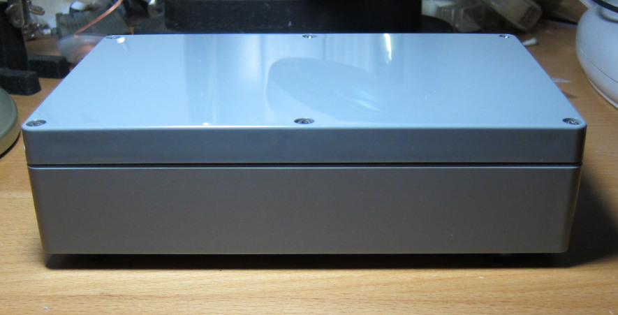

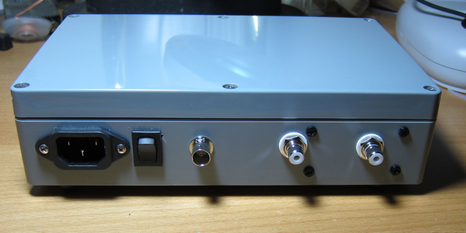

Yes i built one and here is pics for my near finished DAC. I use Hammond aluminium case and I'm very happy with results.

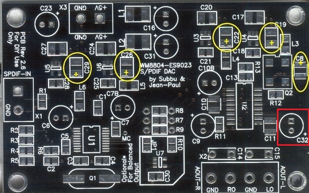

It looks like you missed the discussion about the correct polarity of C32. It should be opposite of what you've done, as shown in the attached picture. I borrowed the picture from the DAC build thread and don't recall who made the excellent diagram, but all credit for the picture goes to him.

Sharp eyes Gary ! Gary is absolutely right. I dont see the error as I am used to using bipolar BG N series.

Thanks. By the way, I took your advice and rewired my DAC to shorten the AC wiring length and get it further away from the DC output. It looks nicer but to be honest I can't tell any difference in the sound. With trepidation, I've attached a few more pictures. You'll frown at the exposed 120v terminals, but I only run this with the cover on, so I'm willing to run that risk.

It looks a lot better. More organised and safer within the given situation. I think if A-B comparison would be possible you would have heard the results.

Shielding still is recommended with regard to the 50 MHz XO etc. You can experiment with shielding of just the DAC board. A metal case within the plastic case so to speak. Conductive shielding spray painting the inside of the plastic casing also is a solution but then exposed wiring might cause unexpected surprises 😉

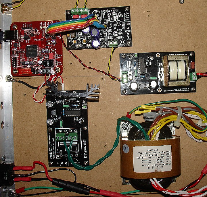

Here's the build I was going to put in a case, but since V3 is coming, I'll wait to put it in the case.
I'm using my spare Jean-Paul ps to power the waveio. Current limit set to 500mA. The heatsink stays at about 45C in the open.
I don't own any hi-end dacs, so I can only compare it to an Endler modfied Behringer DQ2496, a tweaked QNKTC audio widget 1.1 and an Eastern Electric MiniMax (loaned for an extended time). This buid to me sound better than any of the these, deeper more defined bass, more extended and clearer highs. Voices come out clearer, no sibilance.
Thanks again JP and Subbu.
