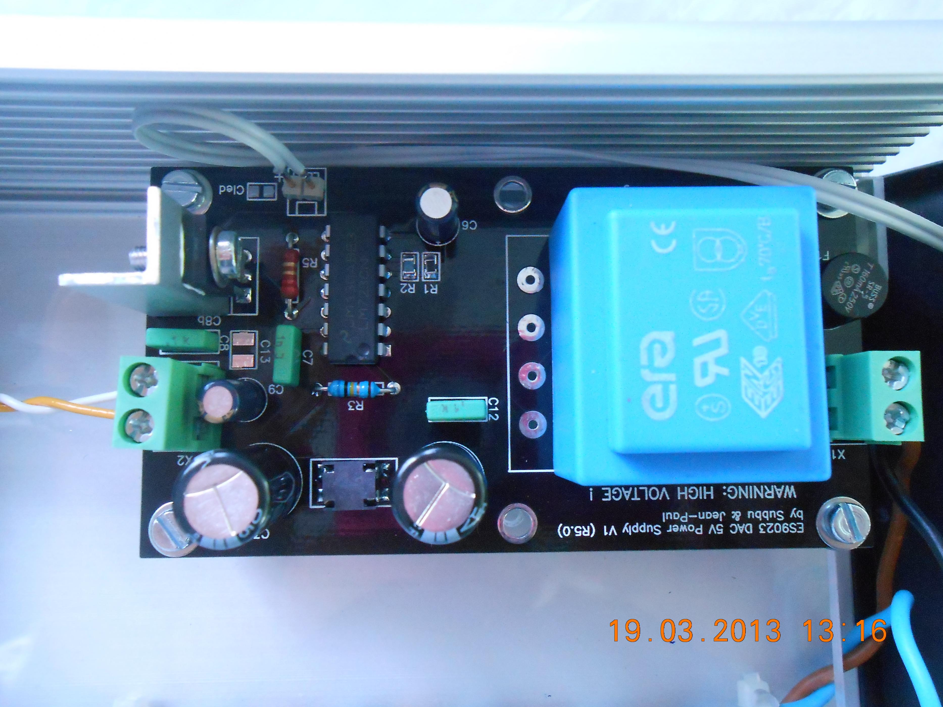

I want to use one of my PS boards to supply 0.5mA. I looked at the LM723N datasheet and it indicates to use the formula
Ilimit = Vsense / Rsc for the 2-7v output level
R5 is Rsc, but what is Vsense ? Please pardon my complete ignorance, I just want to figure out what size current limiting resistor to use to get a 0.5mA PS. I got a slightly over-sized 0.8mA 9v potted transformer mounted externally to power the PS.
Thanks.
Hi I think you mean 800 mA or 0.8 A. Vsense is 0.6 V.
Please be aware that you definitely will need a large heatsink and that this power supply was not meant for more than 0.5 A current nor was it tested for more than 0.5 A current. We made it exclusively for the DAC.
I will make the next version more versatile like with an onboard heatsink (if there will be a next revision). I just finalized 2 of the PSUs this weekend and the results are so good that I wish there would be a negative version of LM723.
Oh BTW LM723 is finally out of production now. Just found out when I ordered some.
Yes! Thanks.
I will get the smaller transformer, I can always use the .8A for something else!
And compact! A next version for higher current supply would be most welcomed... 😉
Yes, when I went to Mouser to get the datasheet it was marked obsolete...

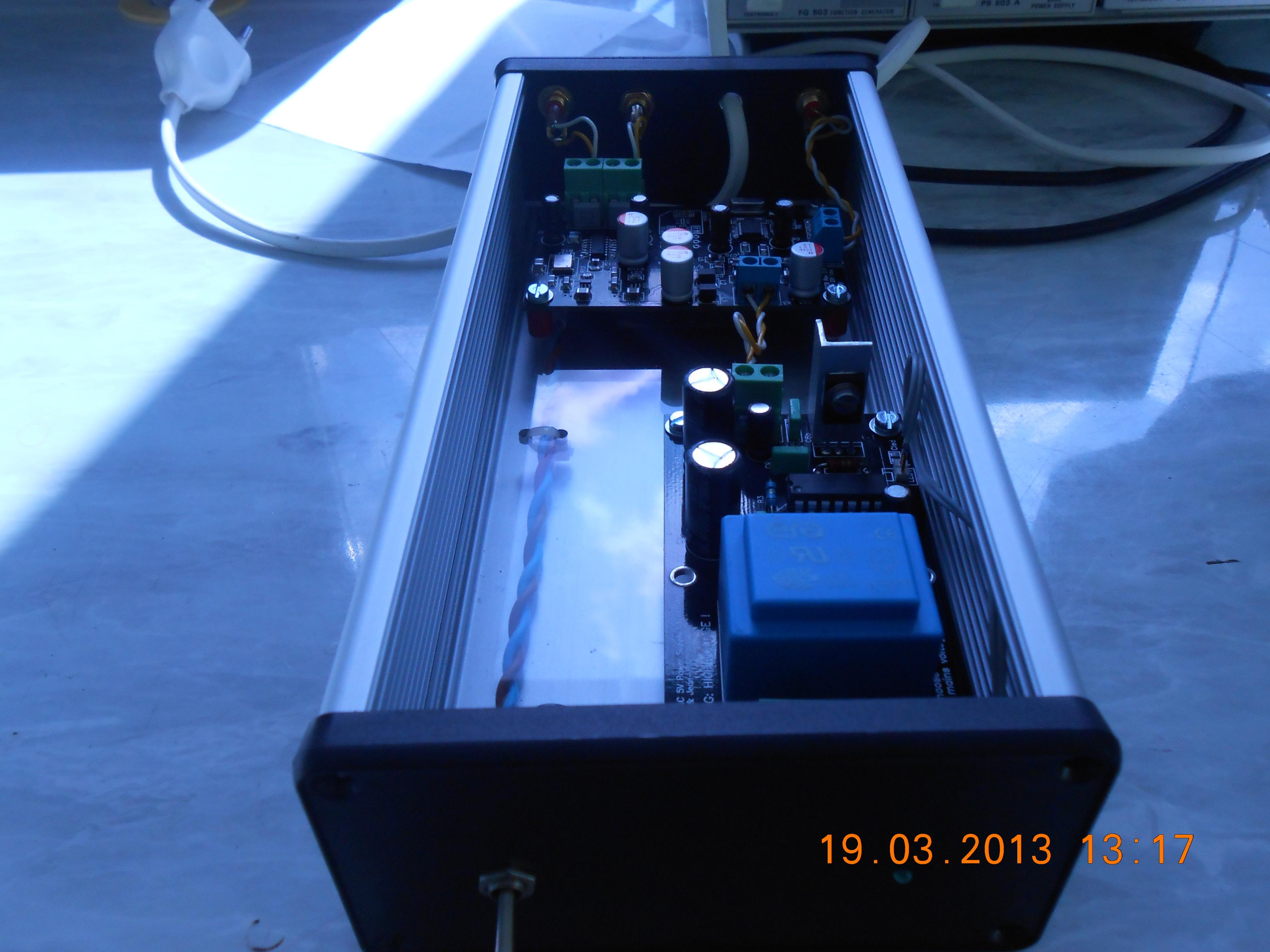

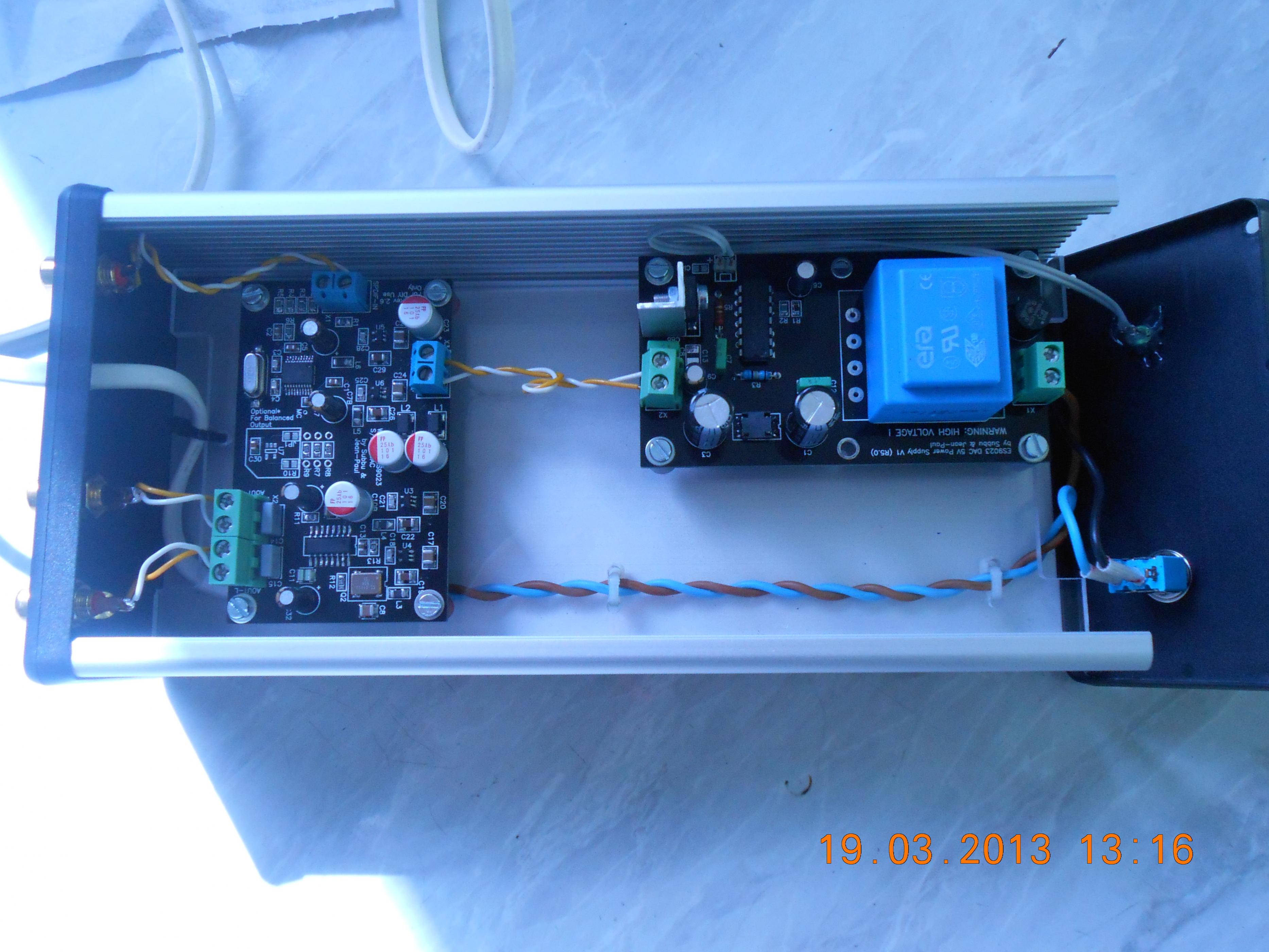

Tome, did you already solder one ? Please tell me how you like it.
Sorry for my late reply but I wasn't active on Diy forum last month.
Yes i built one and here is pics for my near finished DAC. I use Hammond aluminium case and I'm very happy with results.
