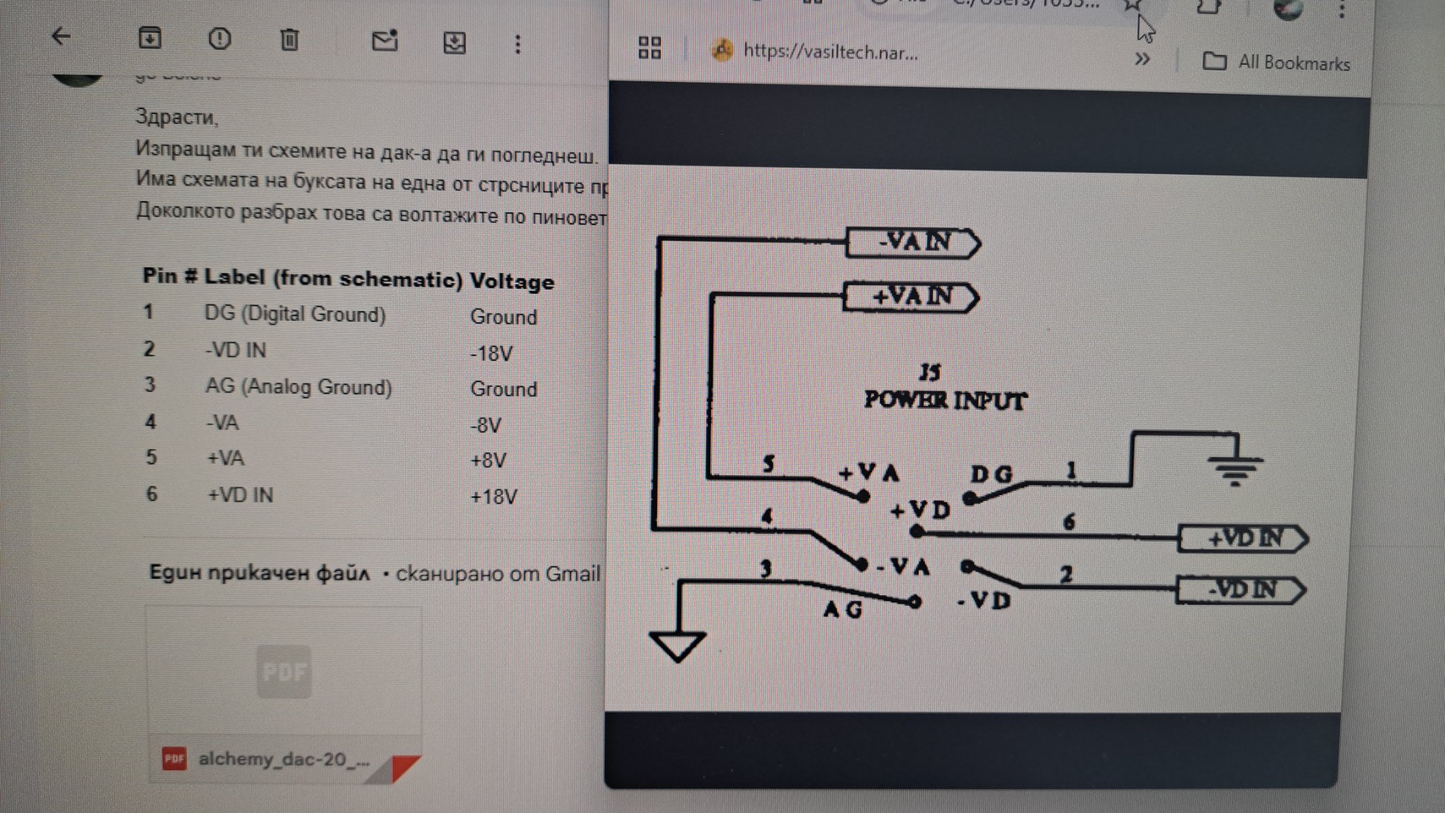

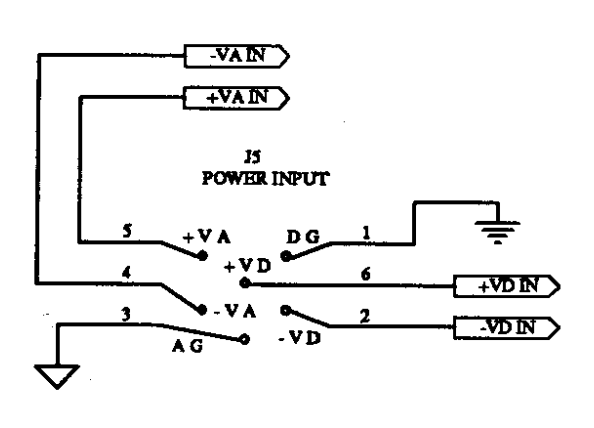

I am going to make a custom power supply for AA DDE v3.0 as I acquire the device without.
As far as I uderstand this device use both rails +/- 18v and +/- 8v and would like someone to reconfirm the pinout voltages and grounds as in the service manual the pinout is showed, but voltages are not mention, nor the perspective of view (my concern) - the diagram shows device inlet or pinout of the power cable? The pinout and measurements would be the same for all power supplies sharing 6 pin DIN plug so it should be PS2, PS3, PS4, which may help us to measure and confirm pinout positions of the cable.
Can someone help me please. Would be very gtateful and rely on your extensive expertise!

It is a drawing of the power entry input connector. If you want to be sure and prevent a fatal mistake (which simply is good thinking) you must open the device and see which pins go to which voltage regulator. It will be clear within minutes.
If unsure post a picture and it can be determined. The schematic is also quite clear. Edit*: the schematic is not so clear!
* It seems to have both 5V and +/- 12V regulators on the digital power supply lines so these can not be +/- 8V. The analog power supply line seems to also have 5V regulators. This may indicate some drawing irregularities. I would examine carefully what is connected to what.

Thank you for you dedication. I really appreciate it! The pins of the cable plug was wired with 2 bipolar voltages according to the picture. They were measured and crosschecked before connection was made. When plug it and power the supply ... all leds on the dac start to run from down to up (some check probably?) but then after second all lights dissappear and there were no voltages - my divider was burnt - I made from +32v => +/-18v and from another rail +16v => +/-8v

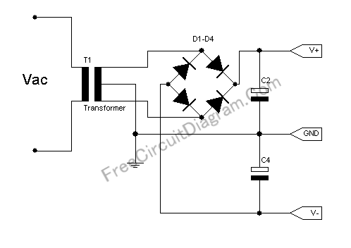

5. You need true symmetric PSUs. Nothing switched, nothing with virtual middle point or dividers no just real symmetric PSUs. The simplest of all possibilities.
6. So a transformer with double secondary winding and 2 of them both with rectifier bridges filter caps and +/- voltages.
7. This circuit both for +/-18V and one for +/- 8V (which we already concluded that is an error, reread post #5).
8. This would be a 2 x 12...14V transformer likely a 10 VA type and a 2 x 7V 10VA type but the latter should be verified as there are 7812 regulators connected according the schematic. 7812 does not work with lower input voltage that its regulated voltage.
All in post #5 and numbered but unanswered. It is give and take here. Please write electrical units the technical and correct way. V, mA etc. mAh is wrong that is energy not power.

I may be wrong, but what I see in the schematic is the need for two +-18 Volt supplies. This means rectified DC, not just an AC transformer.
So out side the DAC you need 2 transformers with 12V 0V 12V each.
Each transformer needs a bridge rectifier and 2 capacitors of 25 Volt /4700uf.
Now you have to connect six (6!) contacts: Digital +18 Volt, Ground -18 Volt and
Analog +18 Volt, Ground, -18 Volt
If you connected AC or the wrong polarity, concider the DAC to be burned toast.
Ps the primary AC of the transformers may be better 15 Volt instead of 12 Volt.

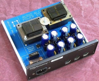

With lot of efforts I found an internal image of original AA power supply it looks like Power Station 2 (PS2) and it confirms 100% your guidlines and as far as I can see there is additional internal regulation there.
