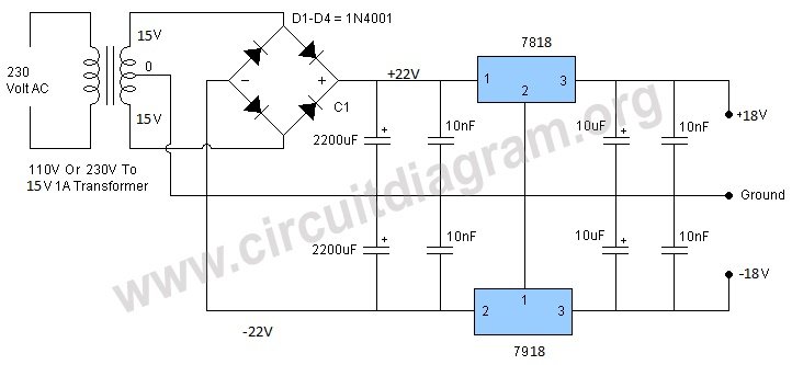

I tried to make you a picture of a dual power supply with 18 Volt output, that will work pre-regulated for your DAC.
If you want to keep the division of analog and digital supply as done by Audio Alchemy, you need two of these.
Do not connect ground, this is done inside the DDE.

Sorry, no. Just an example what you can do at no cost, from stuff in the leftover box.
The case contains what is pictured in the plan. You should do two of those.
The most unconventional feature of the Audio Alchemy products is the carefully made division of each stages power supply.
So your DDE uses one transformer to serve digital, one for analog.
PS you know the difference between a dual 15V-0V-15V power supply and a single 15V-0V one and the importance of the 0V ground?
