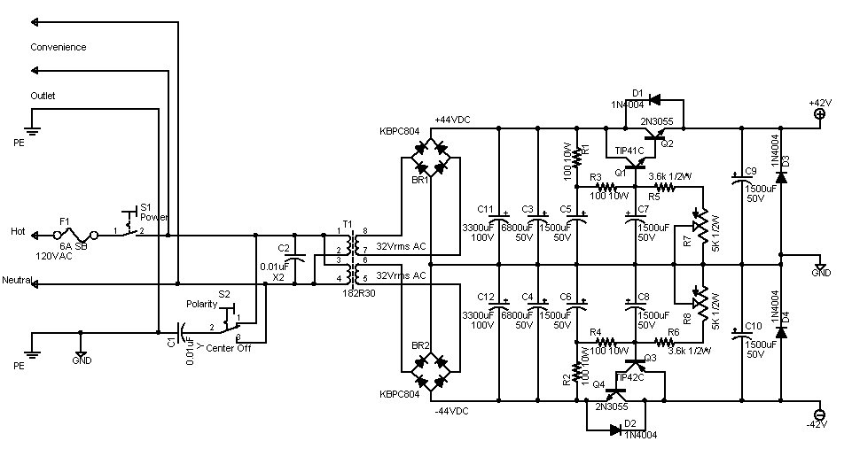

Hopefully you won't mind having a quick look at the grounding picture/modified circuit I will post a bit later to make sure I have understood all of your advice correctly.
Hello Andy
Im interested to see what your modified unregulated circuit looks like,
Any chance of posting this?
Cheers Dan

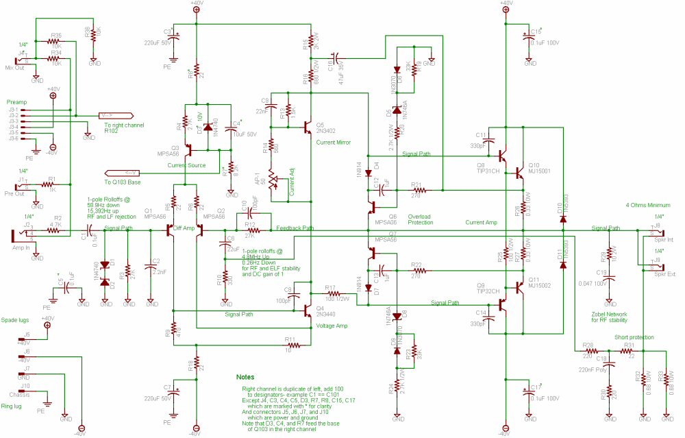

To clear things up for me, the hum problem that is being discussed is in the guitar amp whose schematic is posted in the other thread and not related to any of the amp regulators that are posted in this thread, correct?
If this is true, is there a diagram of how the grounds are actually implemented in the guitar amp? The schematic I'm examining doesn't say much as to how all of these circuit and input/output grounds are actually implemented.
It's tough to say lift the ground at the circuit imput and be doing anything other than guessing. The sequencing of the grounds and the loop layout can make all of the difference in the world.

AndrewT said:All we have is a reverse engineered schematic that I have lost contact with.
Here's the schematic.
Mike.

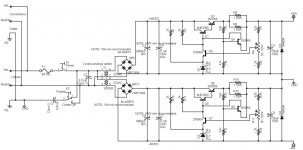

OK, well, I did it, and it worked like I thought it would, except for a couple problems I'll get into shortly. The hum is definitely coming from the power supply, no question about it. The only hum I can hear now is coming from the reverb-- which is unshielded, another cost-cutting measure by the manufacturer, I think-- I replaced the cheapie cables to and from the reverb coil, and it helped, but there's still just enough to be irritating. Coil (aka "spring") reverbs, BTW, are infamous for picking up hum, both because they usually don't have a good faraday cage around the coils, and because you have to amplify the signal coming back from the coil a lot. I'll put a cage around it and that should take care of that. So you know, I put a florescent light about six inches above the top of the amp case, to see if the amp itself is well shielded, and properly grounded, and I could only just barely hear the difference with the light off or on, which is pretty darn good; with the original power supply in there, the hum it already made was quite a bit too loud to hear the difference, so that'll give you an idea how much hum it was.
However, it appears that I don't have enough capacitance on the input- it's browning out at the top end. IOW, if I keep the gain and output level on the preamps down, it sounds awesome- but if I crank it up, it drops out if I hammer a power chord, and comes back when the chord quiets down just a bit, about 300 or 400ms into the attack; interestingly, this seems more prevalent at the top end, whereas one would expect the bass to demand more real power, being lower frequency and therefore staying on one side of the pushmepullu longer. It also has startup trouble- it won't come up properly if the speakers are connected when I turn it on, but if I disconnect the speakers, power it up, and then connect them, it works just fine.
I think 5A isn't enough for this amp. I could gang two regulators to get 10A to fix the startup problem, you can either use a pair of resistors, or, if you're finicky, you can use an op amp to get them to track, and I could probably take care of the brownout problem by that and increasing the input capacitance, but if I'm gonna use two regulators I can get almost as much power (8 or 9A) in less space using a pair of 2N3055-based discrete regulators with foldback current limiting; I'll use the circuit I posted a couple pages back, more or less. Two TO-3 cans instead of four; the rest of the components except for the smoothing caps are all small, the largest other than the pass transistors will be the MJE3055s in TO-220 cases that I'll darlington with the 2N3055s to boost their beta high enough to give me the output I want. If it were just one problem or the other, I might try to fix it with the LM338s, but both problems together make the discrete regulator the right choice.
Now, I'd say that means that you prolly want to avoid using the LM338s with a Lin amp above about 130 or 140W; you might get away with a monobloc 150W, but for stereo I'd stay below 75W/channel. It looks to me like the startup demands of a dual 100W amp (200W total) with two 8-ohm speakers on it are just too great for these regulators to handle.
I tested the 6700uF caps from the original supply to see if they were leaky, and they were within spec according to my scope; certainly they're not having any trouble below 1kHz, and for a power supply running at 120Hz, that should be fine. They have a bit more ESR than I'm entirely happy with, but hey, these were from like 1985 or something, and this manufacturer was kinda cheap anyway, so I'm not astonished or anything.
I agree that two 6700uF caps is probably not really enough for this amp. I'll probably want something a bit heftier in there, and in addition, I'm running the transformer at 46V and the caps are rated at 50V, which is kinda hinky- I'd be happier with 100V caps in there, so I'll prolly get some 10000uF 100V caps on order today. I'm kinda tired of doing everything with a face shield and heavy shirt on- it's hot down in the garage, and I'd be more comfortable with a long-sleeve T-shirt and shooting glasses. 😀
Oh, it's worth mentioning that I had to add two turns to the transformer to get up out of the brownout zone at 42V output- which is the lowest margin I'm comfortable with. I suspect I might be able to take one or both of them off with the discrete regulator, but I'll find that out when I bench test it. So if someone uses the LM338-based design with that transformer, with a 60W or 70W design, you'll definitely want to use a toroid rated for 30VAC RMS, in case you need to add a few turns to it. I was able to get what I needed with 14-gauge automotive primary wire; I don't have any magnet wire on hand; if it were fifteen or twenty turns, it might be worth getting some, but for two turns stranded wire oughta be fine.
It's my considered opinion that you can get quieter power for the money with regulation than with massive smoothing caps, but I have to admit that it's a much easier design to just put giant caps in there. If you want serious power, you'd better be prepared to test your regulator design out before you count on it working. I certainly have the knowledge and experience to implement this type of design, but I'm now on my second iteration, and I have a backup plan if this doesn't work, and anyone who does this had better have one too. It might be a bit beyond the abilities of even an experienced amateur who isn't really ready to do power supply designs, and it's well beyond a beginner.

This is the design I'll start with. I'll probably adjust R3 and 4 and 12 and 13 to get a higher current limit, and I may go with 10A or even 25A rectifiers; I've already mentioned my thoughts on the smoothing caps.
Hey, thanks for digging up the other schematic; I've been busy building or I'd have taken care of Andrew's request earlier. 😀

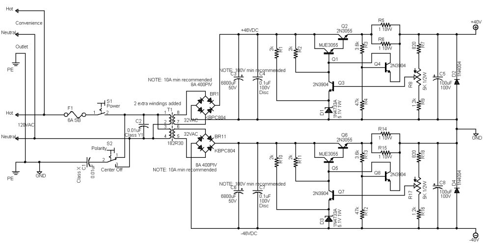

Errata:
1. The 1.2k and 820 resistors in the feedback amp divider were reversed. The 1.2k goes to + out and the 820 to - out.
2. The decoupling caps I have are 250V, not 100V. This makes little difference, but it is worth noting; I recommend 100V minimum for all caps in this design.
3. My output clamping diodes are 1N4002, not 1N4004; the 4002 is a 100V diode, 1A just like the 4004, so this makes little practical difference, but I'd recommend the 4002 as the minimum, since the 4001 is only good for 50PIV. Again, it makes little difference, but 100V minimum is the recommendation.
4. I added a 0.1uF decoupling cap to the base of the feedback amp transistor, Q3/Q7, to the negative rail. This is to provide dominant bypass, a required stability feature for this type of regulator.
My 10000uF 100V smoothing caps will arrive near the end of the week. I hope to be far enough along to know whether they are really worthwhile by then. They will also serve as a backup plan in case my regulation schemes fail utterly (unlikely, but the wise engineer makes contingency plans for everything. Remember the seven Ps).
Testing results:
Testing showed that the original current limit of 7.52-7.95A (at .65V to .85V Vbe for Q4/Q8) is insufficient for startup. I get motorboat oscillations in the power amplifier, showing that the output impedance is insufficient. I have upgraded to 10.12A, with a short load current of 1.44A, by increasing R3/R13 to 5.1k.
I also discovered high frequency oscillation of the current limit transistor, Q4/Q8, which I avoided by bypassing from emitter to collector with another 0.1uF 250V cap, and I'm delaying startup of the current limit by adding a 1uF cap to the negative rail to its base; this cap will also decouple even quite low-frequency oscillations in the sensitive base of this transistor. I have not yet determined whether another 0.1uF decoupling cap should be added to the base of Q1/Q5; I don't expect so, but I am prepared if it is necessary. This (1uF across R4/R12) is permissible to permit charging of capacitances on the amp board; the time constant is on the close order of 32ms. Over this time it should be impossible to draw sufficient current to destroy the 2N3055 pass transistors, even into a direct short to ground. The resistance of R5||R6/R14||R15 will prevent it, since there is build time for the transformer's magnetic field, and charging time constant across the input smoothing caps combined with the transformer internal resistance and the rectifier voltage drop and stray capacitance to consider as well.
Testing at 10A current limit, with the listed bypass and slow-limit caps in place, will commence this evening after work.
It is also worth noting that the preamp and chorus boards are taking their power from the positive rail of the power amp power; since a matched pair of 7815/7915 regulators is in use on the chorus board (where this power comes to them), it is my intent to take the input to this regulator pair from the positive input rail to the new regulator, rather than from its output, to ensure good balance between the two regulators, and to free the power amp board from having to deal with the consequences of events on these other boards other than their output. The draw is no more than 2A (limited by the capacities of the 7815 and 7915), and this should make little difference at the output, since line regulation is one of the strengths of this design.
ETA: I will also probably go get a pair of 25A rectifiers this evening; 8A is a little under what I really need, and the next they have is 25A.

Well, it worked, but when I was all done it dissipated too much power inside the chassis. No more dropouts, though, and no more hum.
But while I was poking around, I came across the capacitance multiplier- a much simpler circuit than the full-on regulator- which reduces ripple to managable (and even infinitesimal) levels without overstressing the pass transistors. The basic principle behind the circuit is to use the DC beta of a transistor to multiply the capacitance in a capacitive-input filter. From the point of view of a computer, the regulation would be unacceptable, but for a power amplifier, you frankly want as much of the voltage from your transformer and rectifiers as you can get, to reduce dissipation in the power supply, with the minimum ripple possible. You're not worried about either line or load regulation, beyond that which the transformer can provide; the regulation provided by the transformer is more than sufficient for an audio power amplifier.
What you get from this circuit is lots and lots of amperes, without excessive dissipation in the pass transistor, and with a minimal component count. The cost is that you don't have any more load or line regulation than the transformer can provide, but because that's more than enough regulation for a power amp, what you're doing is throwing away the parts you don't need.
I had a look at this, but I don't think I need that much sophistication in this design; I intend to go with something much more like Ron Elliot's design. Mr. Evil's design is, however, very interesting for the extreme efficiency it allows.
I'll design this circuit today and implement it; I expect I'll get noise specs about as good as from my regulator, and considerably less dissipation. When I have settled on a design, I'll publish it here.

That was it!
It works great. Sounds like a million bucks. No hum, no buzz, no dropouts, no heat.
I redid a couple things- I had some 3300uF 50V caps lying around, as well as the two 100V ones I had, so I beefed up the input smoothing network to 6800+3300uF in parallel. This obviates buying 10000uF caps. I also decided to go with 1500uF caps in the base drive network, and used Andrew's suggestion of two filters, each an R in series and a C in parallel, 100R and 1500uF. I changed the 3.3k resistor to 3.6k, and moved my 3300uF caps that I was using in the base drive to the output. And at the last moment I decided to put a pair of 1N4004s on the output, just to clamp everything where it's supposed to be... JUST IN CASE.
The 0.2V glitches are just plain gone. I don't know if reducing the base drive did that, or increasing the smoothing network, but whichever, it works fine.
I'll tell you something else, too: I was using those 3300uF caps in parallel with the 6800uF in the amp already- yes, kids, I had 10100uF on each rail, and it was still buzzing like a beehive. So much for beefing up the filter caps. I'd forgotten I left them in there. They sure didn't do much good. But slap that cap multiplier in there, and Bob's your uncle!
This is IMHO the right way to go for the power supply for a power amp- at least a Lin amp. I played a little, and it sounds GREAT- of course, I can't crank it, it's midnight here and the neighbors would run me out of town on a rail, but tomorrow... 😀 😀 😀
Here's the circuit. Let me know if there are questions.
