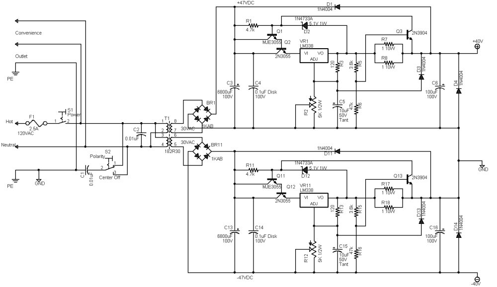

OK, I'm just about done analyzing a 2-rail supply with full protection, using LM338s. It's a modification of the National "floating regulator" application note, with a 5.1V zener to hold the input-to-output voltage across the regulator to under that value, a 2N3055 to block the input voltage, and a 2N3904 to do foldback limiting on the base of the '3055. I've used a pair of 1-ohm 10W resistors, Radio Shack $1.95 each, for the current sensors.

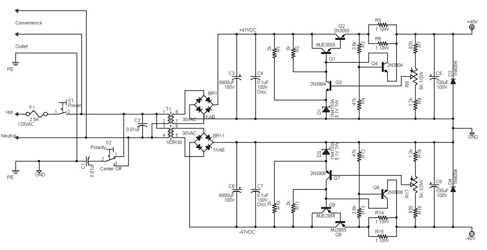

The '3055 dissipates about 20W max; the zener and '3904 are protected by a 10k resistor, limiting current to about 4.7mA total between them. The only thing I'm having trouble with is there might not be enough current to give the output I want; with a DC Beta of about 35, I might have to Darlington the '3055 to get enough current through it. I'm lookin into it. I'll post when I'm done. Keep yer eyes open.

OK, here's two of 'em. The second one is a pair of LM338s with appropriate protective circuitry. When I was done with the design, I realized I could get about the same performance and a smaller size with a discrete supply, and since most of the work to do the discrete supply was already done protecting the '338s, I did that too. The one in this post is the discrete design.
I invite analysis and commentary. I intend to breadboard the '338 design; the discrete design should be breadboarded carefully and operated with caution until its operating parameters are clear. I'll include my analyses following these two posts, and I'll post breadboard results when I have them. The transformer has arrived, but today is band practice so it might be a few days.

OK, now here's how they work. First, the discrete one- it makes the LM338-based one easier to explain.
Q1 and Q2 pass transistors are a darlinton pair of MJE3055/2N3055, basically the same transistor but a little less beefy and a little more gainy in the MJE line- it's a TO-220 instead of a TO-3 like the 2N3055. The darlington pair configuration guarantees enough gain to make sure that there is solid current flow in the main circuit. The 5.1V zener was chosen because in this value range, zeners have a very low temperature coefficient, and inherently low bulk resistance. This means that the 5.1V breakdown voltage varies almost not at all with either current or temperature. Q3 is the feedback amplifier, and R7, R8, and R9 are its voltage divider. Because this is closed-loop voltage gain, we do not need to consider the DC Betas of the transistors until we calculate to be certain there is sufficient current, and that the 2N3904s won't burn; the voltage gain is
A = 1/B
Where,
A is the closed loop gain, and
B is the feedback fraction.
The feedback fraction is just
B = (R9 + part of R8)/(R9 + R8 + R7)
For reference, this should be calculated for R9+R8/(R9+R8+R7)
and for R9/(R9 + R8 + R7) to show the limits of the adjustment. But we won't use this equation; we just need to get the closed loop gain, so let's solve for that.

Now, the output voltage is
Vo = (Vz + Vbe)/B

Vo = A(Vz + Vbe)
So we have to calculate for A = 1.13 and A = 5.85, and Vbe = 0.65V and 0.85V. The four answers are:

Right off the bat, I got a problem, and I know where it came from. When I did the original calculations, I used Vbe = 1.5V + 1.8V, automatically using the darlington drop and the max Vbes from the darlington pair. So R9 is too big to get high enough. We'll have to bump it up.
We'll shoot for A of 8.7, to get us just over 50V; with Vin at 47V, we can't ever actually reach this, of course, but it ensures that we can get as high as possible. There is a warning to be aware of here, though; if you push the regulator too far up, you'll brown out, just like 3-terminal regulators do. I'll show you how to calculate the brownout voltage shortly.
This means that (R7+R8)/R9 should be as close as possible to 7.7 (remember you have to add one!). The 5k pot is pretty standard, I use the little ones with high stability. So if we use a 1.3k for R7, and an 820 for R9, that will give us 49.93V at the top, and 7.03V at the bottom.
And another warning: if you run this supply at 7.03V, don't be expecting to get 5A out of it- that would be 40V across the pass transistor, which would get you 200W dissipation out of a transistor that only can handle 115W, and that's assuming a perfect heatsink!
Clearly, for the voltage levels desired by the original poster, a yet higher value for R7 and perhaps a somewhat lower value for R9 will be needed; with the demonstration above, it should be little trouble to get what you need using this regulator. If you want me to check your results, post them, and be detailed: show me your work. If you're confident enough to press on on your own, more power to you (so to speak. 😀 )
OK, now let's talk about another important feature of this circuit. It uses foldback current limiting, implemented using R5 and R6 as the sense resistor, R3 and R4 as the voltage divider, and Q4 to control the base voltage of Q1 and implement the foldback. The current limit in this scheme (this is standard for foldback limiting, so pay attention) is
Isl = Vbe/K(R5||R6)

Note carefully that these are 10W resistors, for a total dissipation of 20W between them. If our current limit is to be 5A, these resistors will drop 2.5V; this means that they will dissipate 12.5W, or 6.25W each. The maximum current limit we can implement with them is therefore
(20W/0.5ohm)^.5, or just over 6A. For this circuit,
Isl = (.065V/(((47k/(47k + 3.6k))x(0.5ohm))) = 1.399A. You'll notice you've come out very close to my targeted value of 1.4A. At this value, with input of 47V and output of 40V, the pass transistor will dissipate 7V x 1.4A = 9.8W, eminently reasonable.

Imax = 1.4A + (40V(1-(47k/(47k + 3.6k))))/((47k/(47k + 3.6k))0.5ohm) = 6.13A. This is why this type of limiting is called "foldback;" the current limit decreases as the load increases beyond the programmed current limit. In this case, the programmed current limit is 6.13A, and if we are dropping 7V across the pass transistor, then it is dissipating 42.89W. This is a heavy load, but it is well within the capabilities of the 70V, 15A, 115W TO-3 cased 2N3055, if it is properly heatsinked; most likely, if this amount of current is to be drawn for any length of time, or on a regular basis, it would be best to use a fan to cool the heatsink and transistor. But at 4A, we dissipate a much more reasonable 28W, which we can expect to dissipate without a fan and with a reasonably sized (and priced!) heatsink.
Now for the remainder of the supply's parts. R1 limits the current through the zener to 20.95mA, eminently reasonable for this 1W device, which dissipates 107mW under this load. R2 limits the current to Q3 to the same level, resulting in an even lighter load under normal conditions, since the transistor operates in the active region, not at the rail. And even at the rail, 107mW is by no means excessive for this 250mW device. R2 also provides current to the base of Q1, forward biasing the BE junction and taking this transistor into the active region; with a minimum gain of some 25-30 under its light loading, and with an equal minimum gain of 25-30 in Q2, we see that as little as 1mA results in the flow of a minimum of some 625mA, and with the more substantial current levels available of 10mA, we can send 6.25A out; this is at our current limit, so there will be no problem maintaining the setpoint voltage, provided we don't brown the regulator out.

Well, you got two Vbe drops across the darlington pair, and your drop across the sense resistors; like I said above, the max drops are 1.5V and 1.8V, so that's 3.3V, and at 6.13A you'll be dropping 3.065V across the sense resistors, so that's 6.3065V maximum brownout, and more like 1.4V minimum. Our 7V looks like it leaves us a nice margin.

OK, now the '338-based one.
The foldback limiting works the same way, and you'll note it uses the same resistors and transistor as well.
The 2N3055 stands off the voltage in excess of 5.1V above the output voltage. Note that this means that the current capacity of the transistor is compromised if the output is a lot below the input- just as in the discrete regulator. The zener diode sets the voltage from the output of the regulator chip to the base of the MJE3055; the MJE3055 drops 0.6 to 1.8V, and the 2N3055 drops a further 0.7 to 1.5V, so between 1.3 and 3.3V of the 5.1V the zener makes gets dropped across them, leaving 3.8 to 1.8V; this is below the regulator's brownout, but note that the higher Vbe(on) occurs when Vce is high- these are the worst conditions. Under more normal conditions, like the constant intended operating conditions of this regulator, this should not be a problem, however, it must be carefully breadboarded and load tested to ensure that there is sufficient headroom. If there is not, a zener rated at 1 to 1.5V more should do the trick.
The foldback limiter circuit is required to protect the 2N3055 from an output short, which would otherwise overload and quickly destroy it. The current limit on the chip would not limit enough to prevent this. The 2N3055 protects the LM338 from higher voltages than it is rated for, and the transistor can handle 60V, and pass 15A, and dissipate 115W. The darlington pair again increases the current amplification of the transistor to allow sufficient current to pass. The protection diodes protect the LM338 from cischarges of C5 and C6 as in the standard circuit.
The main advantage of this circuit over the discrete regulator is that it will be much quieter; perhaps as much as 15dB, or even more. I'll get into the ripple calculations, and show a few other things this circuit does that the discrete one does not, later.

can you move your foldback limiting to upstream of the regulator?
Otherwise the 3V (@Iout=6Apk) drop across the sense resistors ruins the regulation. i.e. the output voltage modulates with load demand.

if you are going to go to all this work -- why not use a decent error amp and reference instead of the quite (very) inadequate LM338 -- take a look at the impedance plot of this device --
...and that's why I put it out for review. Nice suggestion, Andrew. I'll do that. There's no reason not to, and good reason to do it.AndrewT said:Hi,
