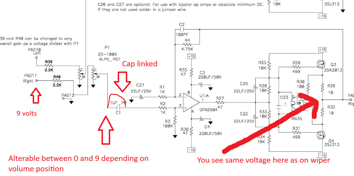

Will just add that the output voltage of the main amp will only follow the input voltage up to a certain limit of lets say 6 volts. That means if you set the wiper to 9 volts the output will not be able to reach that high. That is normal.
I removed the 220k resistor on the op-amp and measured the output at the headphone jack.The 9 volt battery goes to the input RCA.
Caps bypassed.
We don't use a resistor now if we are using the battery. The battery is the only input voltage needed.
With a 50k pot you should see the wiper voltage alterable between 0 volts and up to a little below below 9 volt.
Like this. The main output voltage will be a little bit below the wiper voltage because of R2 and R3 (which form a divider) but the output voltage should be the same as you see on pin 3 of the opamp.
I find 0V to 6.75V on both channels.
I'm powering 9V, one channel at a time.
This should all work then.

So 6.75V is right?Will just add that the output voltage of the main amp will only follow the input voltage up to a certain limit of lets say 6 volts. That means if you set the wiper to 9 volts the output will not be able to reach that high. That is normal.
6.75 volts sounds about right as a maximum the output can swing to for DC conditions like this.
If you set a lower voltage on the pot wiper, lets say 3 volts , then you should see the output also go to 3 volts. Reverse the battery and the reading should change to negative 3 volts on the pot and th amp output.

After the R39/R40 input RCAs I find 8.65V at the potentiometer.
So there is about 2V less at the output.

That's normal. For lower voltages below around 6 volt the two readings should be similar.After the R39/R40 input RCAs I find 8.65V at the potentiometer.
Do not have headphones connected doing DC tests. You would not hear DC anyway as it is non changing.Turning the potentiometer you can't even remotely hear anything.

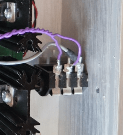

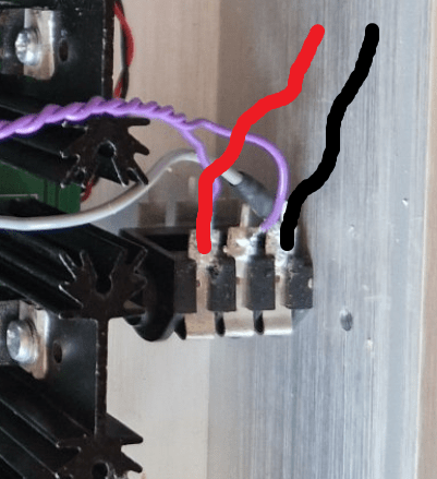

I want you to test using headphones as a probe next... give me a few minutes to explain it.
This is what you do.
1/ Unsolder these 3 wires and make sure they are not touching anything:
2/ Solder 2 lengths of wire here using the end tabs of the socket:
You now have the headphone socket wired up to use as a probe and it is no longer connected to the board. Plug the headphones in.
3/ Switch the amp on and connect it to your playing music source.
4/ I would always recommend you begin without wearing the headphones. Connect the two wires, one to ground and one to the pot wiper using the correct side for the channel in use. You should hear music if you turn the pot to full. It will be low volume but you should hear it.
Can you get as far as that?

Done!This is what you do.

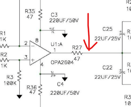

Now, and keeping everything else the same, remove only the headphone wire that is going to the wiper of the pot and transfer that wire to the junction of the two 10 ohm resistors R29 and R32 which are the main output. Leave the ground wire exactly where it is now.
You are moving only that one wire.
Do NOT wear the headphones. The music should blast out. Does it?

If it doesn't work then try adding a series cap (any small value like a 1uf to 47uf value which will block DC) in series with your test wire to the headphones and this time see if there is any audio here:

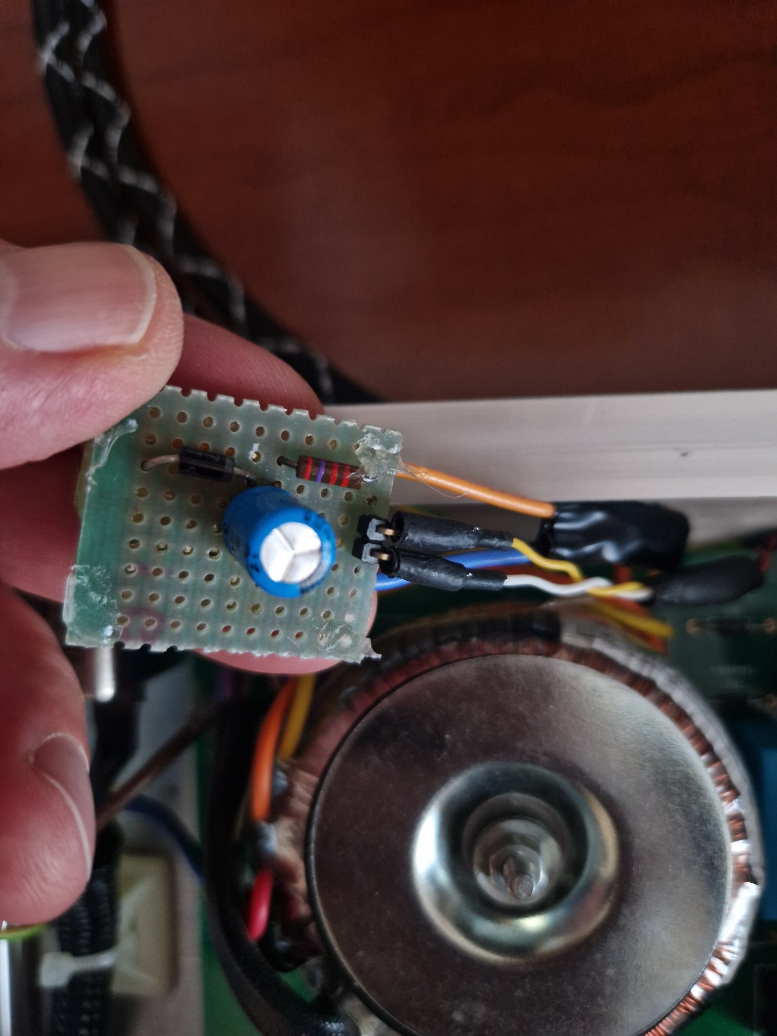

There is a little circuit ( resistor, diode, small capacitor) for the power led .
I dont' now if it can cause this problem
