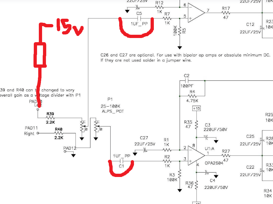

There are still other easy tests we can do. Do you have any resistors such as a 220k or 470k? anything in that sort of high value?
If you connect the resistor between the opamp side of C1 (the input cap) to the positive rail you should see the main output go to to exactly the same voltage as you measure on the opamp input the resistor is applied to.

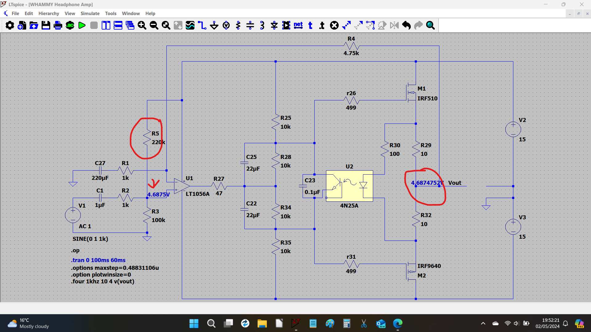

This is what I mean with the resistor test. You only need dab the resistor on to see, no need to solder.
Whatever voltage you apply at the opamp input should be seen at the output. Do NOT connect headphones doing this test.

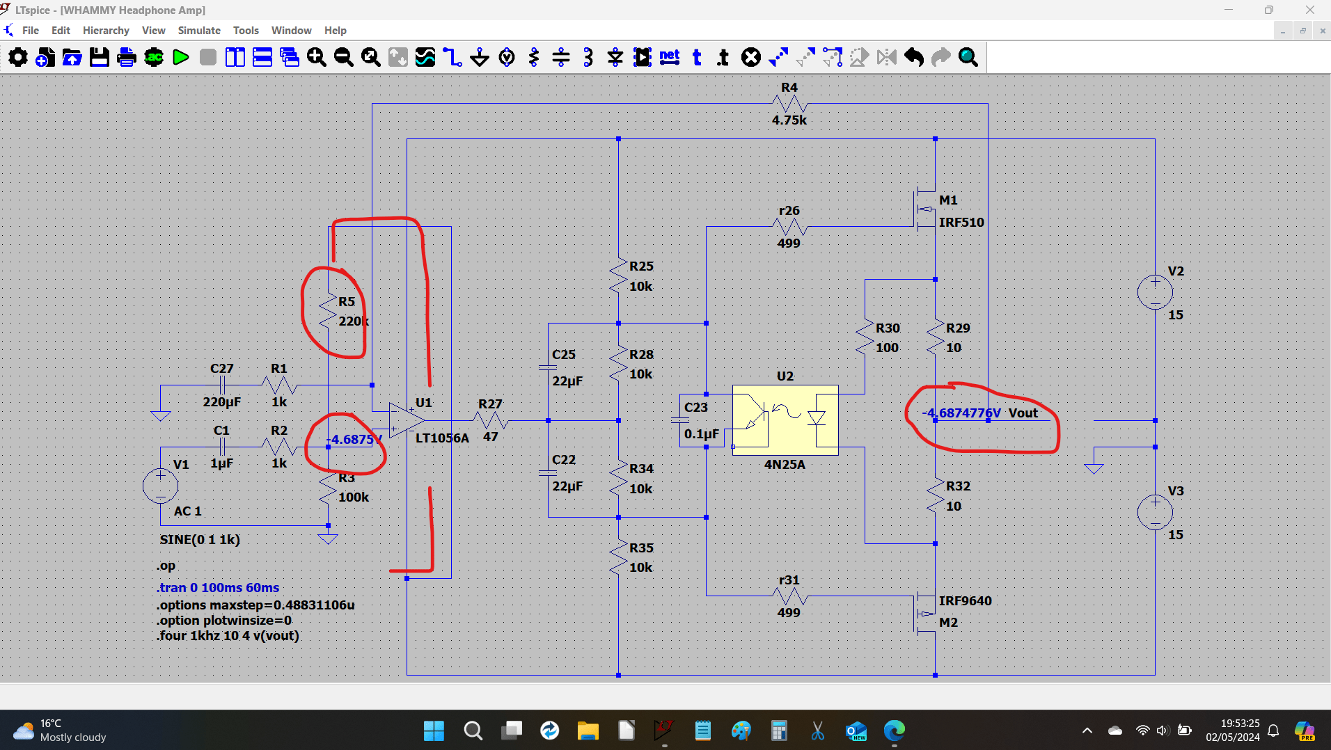

Here are two similar R values and one is connected to the positive rail in one test and to the negative rail in the other. The output should follow the input exactly. Don't use lower than around 220k.

Resistor between operational amplifier input and positive rail.
Then I measure voltage on the op amp output and input.
It has to be the same.

Amp on. The amp overall has a DC gain of '1' and so all we are doing is confirming the amp is operating correctly.
The opamp input voltage and the main headphone amp output voltage should be identical (the opamp input will not be the same as the opamp input, that is normal).
Make sure no headphones connected for this.

I found a suitable resistor for the second test but I'm struggling to understand (I'm not familiar enough).
I connect input opamp by 470kohm to +15v.
Where do I put the multimeter leads?
Between opamp input to ground and then on headphones output?

You measure from ground (so black meter lead to ground) to the opamp input pin you have connected the resistor to. Whatever voltage you read there you should also see the same voltage at the headphone output. Do not connect the 'phones though for this test and I would also say leave the RCA inputs floating (not connected to any external equipment.Where do I put the multimeter leads?
If you look at the circuit you have your resistor in series with the 100k on the board. So ohms law gives us a voltage of 2.63 volts if you have 15 volt supplies.
Worked out as I=V/R so we have 15/(100,000+470000) giving 0.0263 milliamps. V=I*R and so there is 0.0263E-3 * 100,000 which is 2.63 volts. If you connect the voltage to the negative rail the result would be -2.63 volts.

Resistor between input and rail +-15V
On both channels the same.
Input opamp to ground 2.67V
Output (jack) 2,67V

So that shows the amp is working. If that voltage were audio you should get sound.

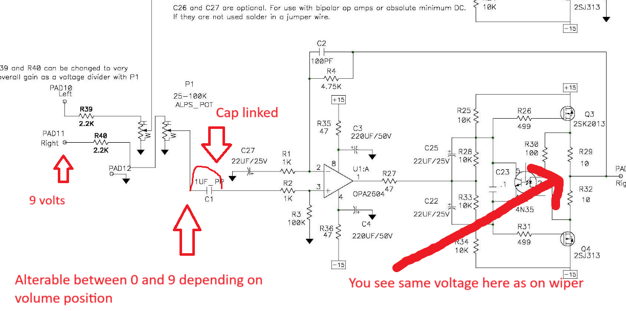

If you want you can try the same test but this time we use the RCA input to apply the voltage.
Look at the circuit:
You would need to link out C1 and C5 so that DC is passed.
Now you apply the test voltage to the RCA inputs. This time you can use a 9 volt battery as a source if you want or you can use a resistor as before.
The voltage will now be under control of the volume pot and be variable from zero upwards.
If you use a resistor you can use a lower value if you want because the resistor is now in series with the volume pot and that will reduce the voltage available. How low depends on the value of pot but nothing bad will happen because it is protected by R39 and R40.
If you use a 9 v battery you would see the voltage at the wiper of the pot alter from 0 through to 9 volts as you rotate the control.
With those caps linked that wiper voltage should appear at the opamp input.

I connected everything.
9V battery.
RCA input with R39/R40 2200ohm
Bypassed capacitors.
Opamp input to main via 220kohm.
50k potentiometer
Output to the jack I find from OV to 6.75V.
Measuring the channel that is currently not on battery, I find 0V to1.9Volt.

The 9 volt battery goes to the input RCA.
Caps bypassed.
We don't use a resistor now if we are using the battery. The battery is the only input voltage needed.
With a 50k pot you should see the wiper voltage alterable between 0 volts and up to a little below below 9 volt.
Like this. The main output voltage will be a little bit below the wiper voltage because of R2 and R3 (which form a divider) but the output voltage should be the same as you see on pin 3 of the opamp.
