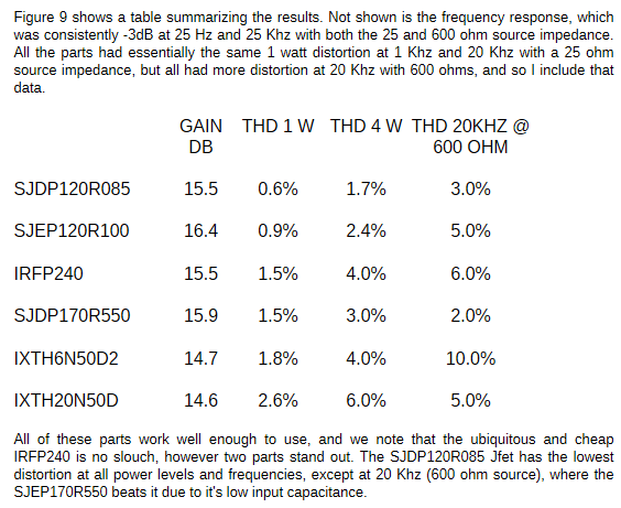

I'm pretty much a nube here, so I'm not exactly sure what makes for a good audio power JFET, but I got bored last night and found that Mouser is stocking and selling UnitedSiC power JFETs in TO-247 packages. They're making these things rated up to 85 amp and 650V. I'm too green to read the data sheet and really understand it, but I wanted to toss it out there for the crowd and see what I can learn.

Look at the data sheets, it is a power FET, in fact, it looks like a VFET.

That's not correct. SemiSouth made power Jfets and they are used in the First Watt J2. I used them in a First Watt F6.
SemiSouth in no longer in business, but there are other power jfets out there. Sometimes the descriptions are misleading, so it's best to ask someone who understands the specifications and manufacturing process for power jfets.

The gate capacitance on a IFRP240 is 1300 typical.
630pF on this jfet.
The IRFP240 and UJ3N065080K3S are a pin to pin match. Doesn't prove anything but...

Interesting, but is there any reason to prefer these over depletion MOSFETs? Small signal JFETs are useful for low noise, but that isn't important for the sort of use big devices like these would be put to. It would be a different matter if they were available in complementary pairs...

yeah ..... but we are always looking what's transfer characteristic like in 20-30Vdc and ~2Adc region
practically - either U-I graph , or table as vdi_ posted

So you are saying until someone runs tests on actual devices for a given voltage and current, we won't know if they are usable?
Well, there is a SPICE model for it ...
