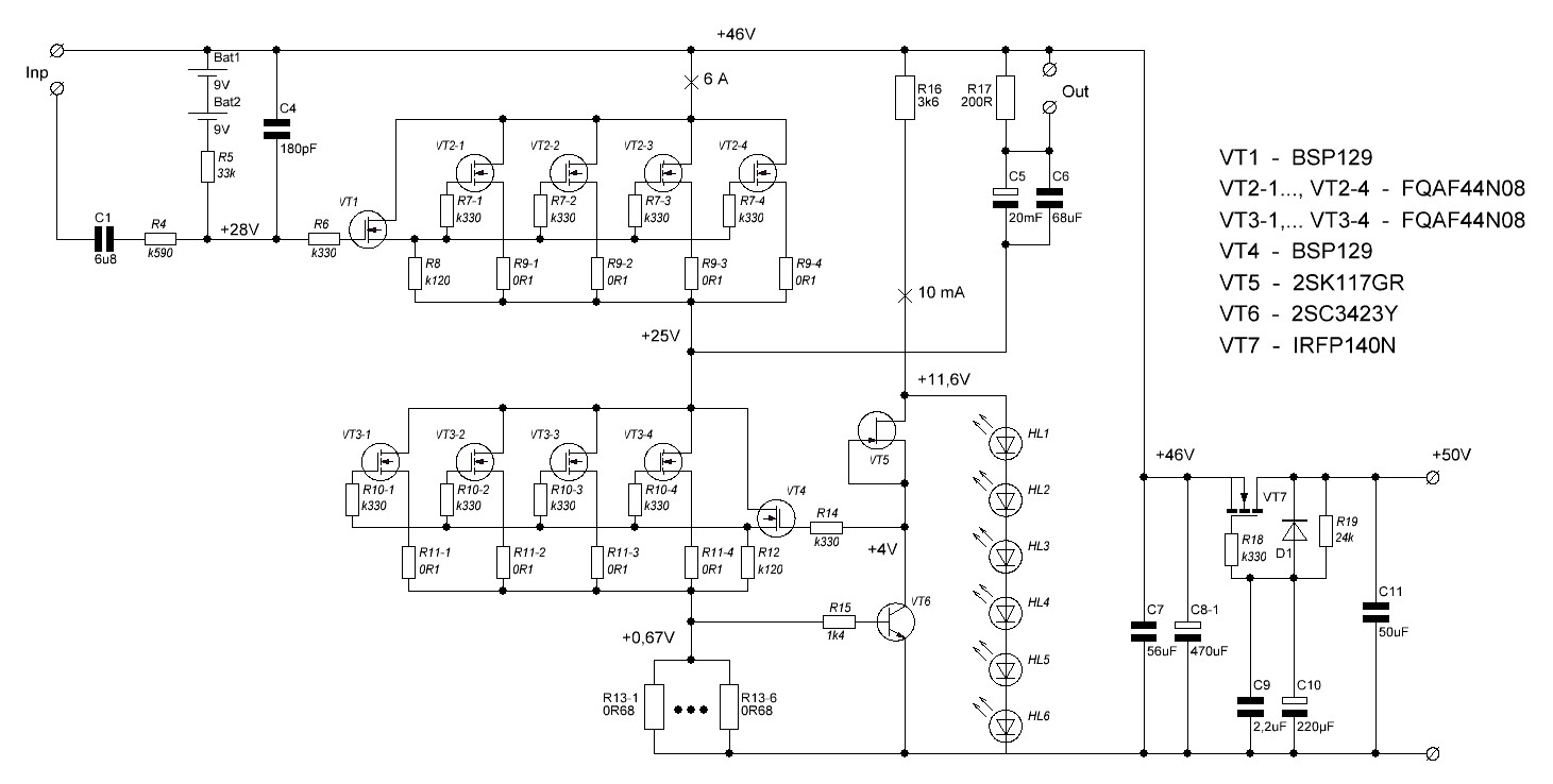

Power Follower 99 sound impressions?
Anyway, within a DIY it would be interesting to try. I guess this complete schematics should be good sounding.

Schematics in the post#41 , as well as the original Follower schematics, observes one major rule - current consumtion from power supply is fixed by constant current source composed of VT3...VT6, while active "transistor" VT1-VT2 shares this fixed current with the load, at any time moment under signal.
This gives crucial sound advantages of this approach compared to alternative schematics. Disadvantages - low efficiency and big heat sinks.

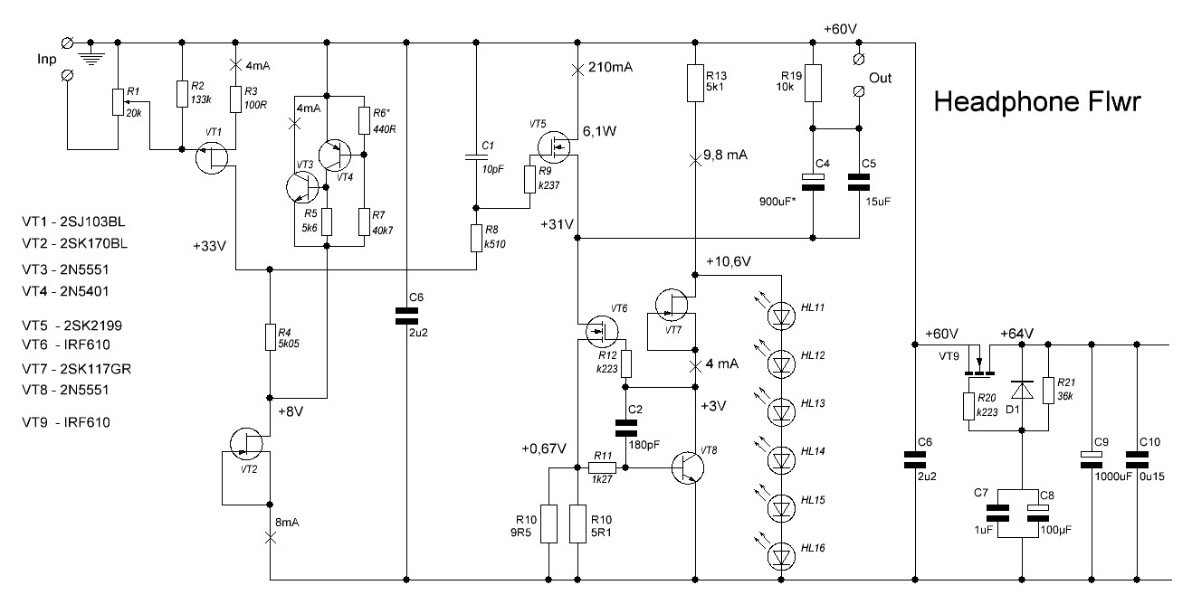

Intuitively I prefer the topology used by the Headphone Follower using K2199 and IRF610. How much wattage can be had from that small amp by replacing or paralleling K2199/IRF610?

Hello, Jay
I estimate possible wattage of this (with more idle current) K2199 based schematics, as 2W per channel, and 4W with the paralleled pair of K2199 (10W of heat is dissipated by each K2199).
What is interesting, just now I am playing with modified headphone schematics, with russian KP907A as an output active transistor (also 1...2W of output power, could fit sensitive full range speakers). Compared to K2199, the KP907A is more linear and has order of magnitude smaller Ciss, but rather low transcondustance (0,2S). I use some NFB in this case, in order to bring Zout below 1 Ohms range.

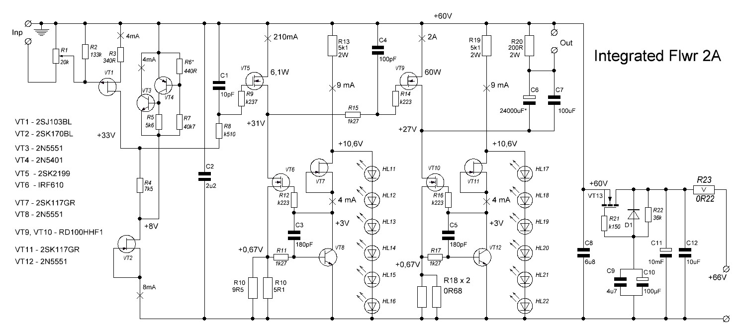

Actually I attached the output follower stage to this schematics, like here
http://www.diyaudio.com/forums/solid-state/189044-integrated-no-nfb-son-follower.html#post2572569
With this two-stage approach, it is difficult to get small output impedance. Even with IRF510 you will get something around 1 Ohm. If one would use more powerful transistor with higher transconductance, then Ciss of such transistor becomes too large for a given input amplification stage. Therefore, I attached third stage with RD100HHF1 transistors.
But, who knows, it would be interesting to put RD100HHF1 at the second stage for 15-20 watts output power.

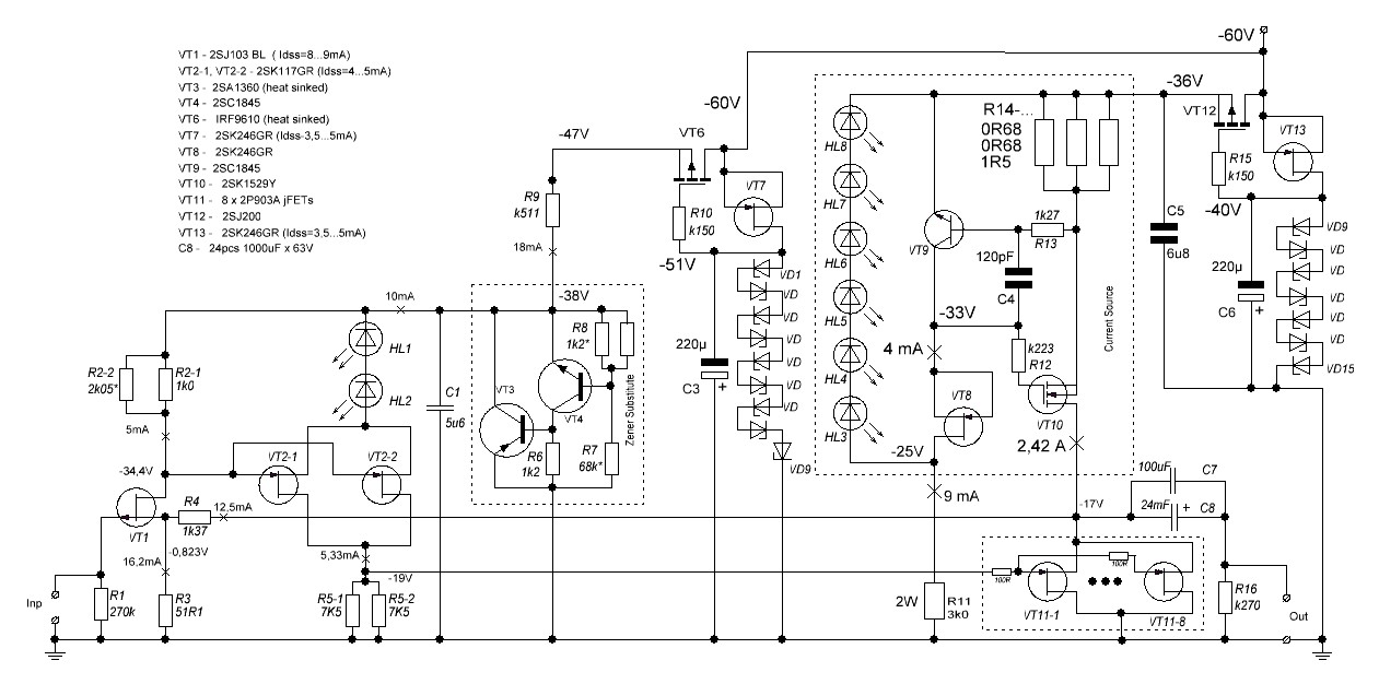

However, I do not continue along the above line, since subjectively I have found out that the schematics below with power jFETs at the output sounds even better, and dig this way. These KP903A jFETs are available.
http://www.diyaudio.com/forums/solid-state/197493-jfet-amp-current-nfb.html#post2727321
