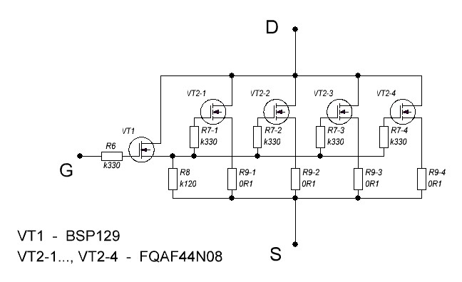

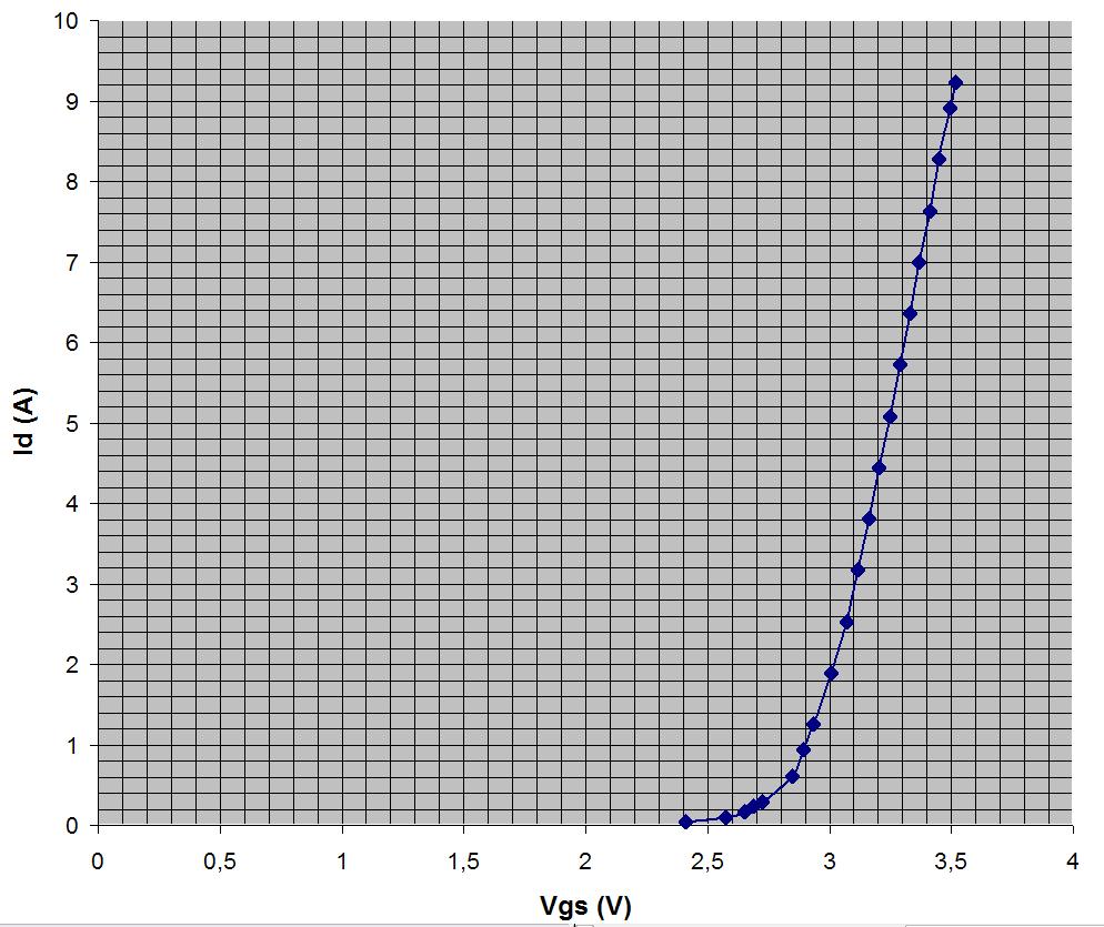

Ciuffolli Follower 99 sounds good, and I would like to try a version with low input capacitance and high current.
I propose to substitute the IRFP150 by the following composite structure. The BSP129 input capacitance is near 50pF, and transconductance of the composite structure is near 15S, that will give output impedance well below 0,1 Ohms.
Here is a real measured curve at Vds=10V.

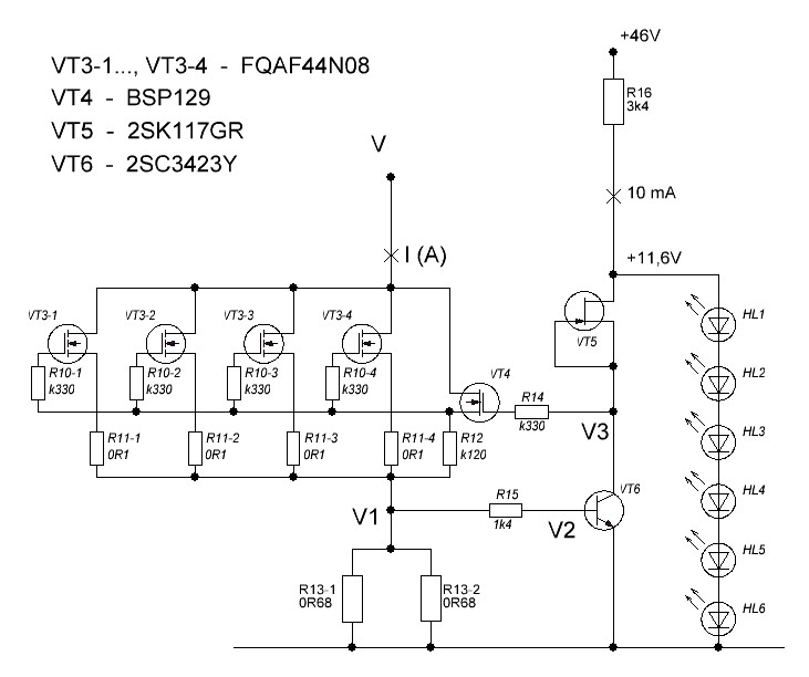

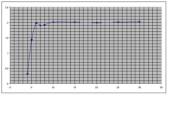

Next step in the Follower 99 implementation is current source approach (the bottom transistor in the original schematics). I have put together and measured the following current source and, at approximately 2A current, tested current stability vs voltage variation.
Current stability is very good, except for a bit strange dip at the low voltage region.
