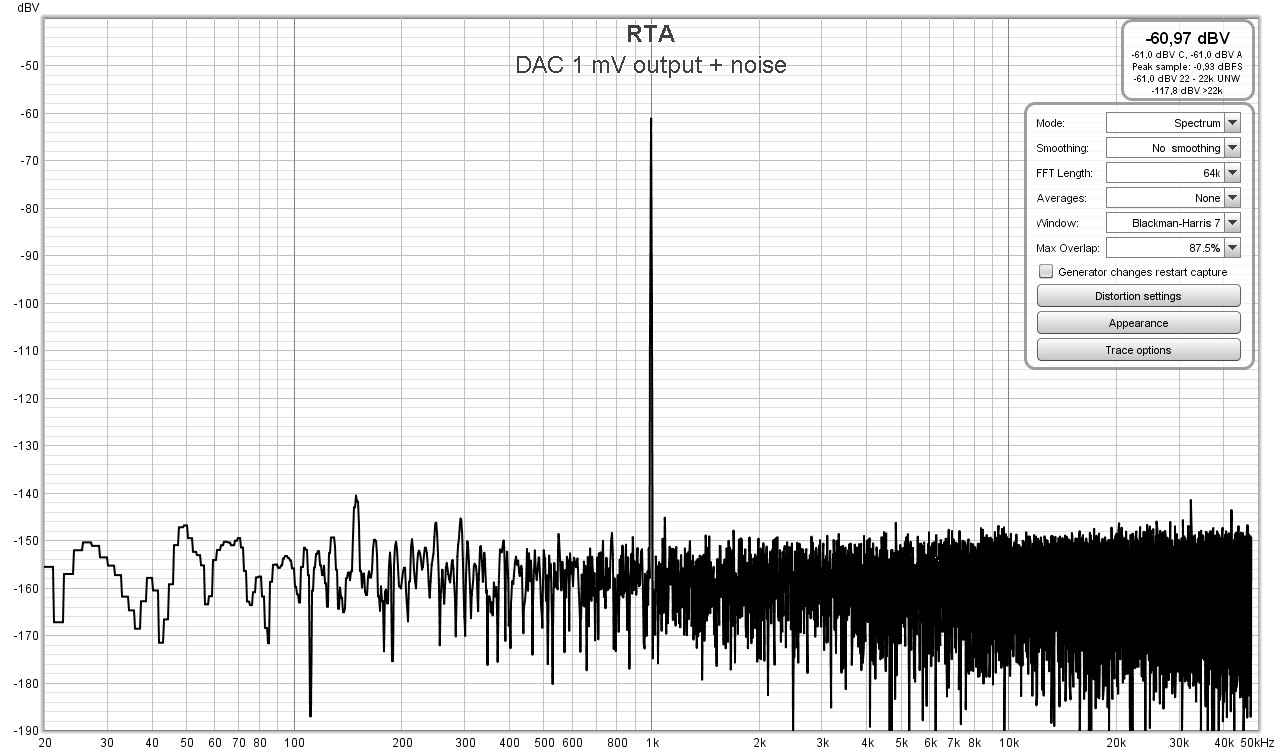

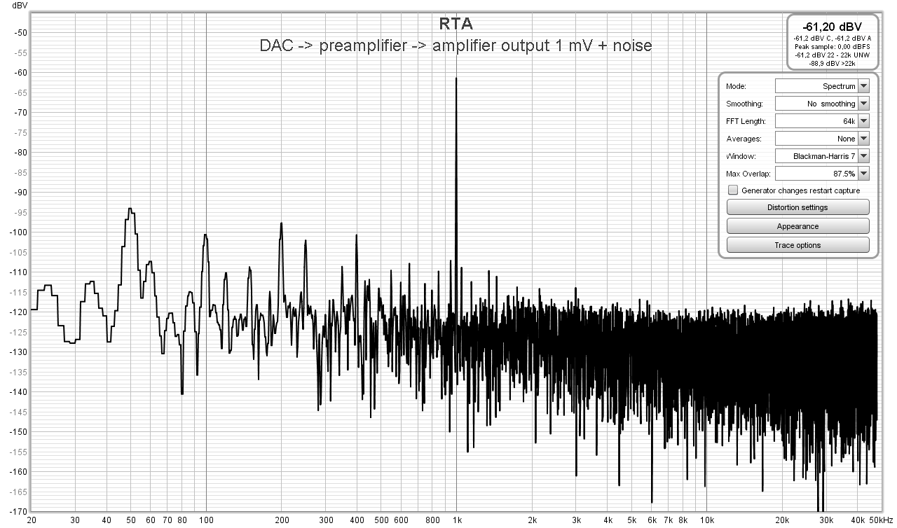

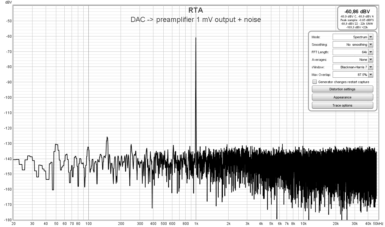

To move this thread from opinions to real data, here are some measurements of noise floor from DAC to power amplifier output, with any effect that plain unshielded power cables and audio signal partially traveling through power earth wires between audio components has.
Location: rural area with surrounding industry like food processing, large warehouse freezers, several hundreds kW solar plant, metal processing industry with heavy welding machines. All that less than 1000 m from my house.
Noise was measured in 20 Hz – 48 kHz bandwidth using calibrated 60 dB LNA and Focusrite ADC + REW software. Measurement were taken as real time, without averaging, so any noise floor variations or additional noise peaks from EMI/RFI could be spotted. Connection from laptop to DAC was deliberately made with, out of specification, 7 m long USB cable (2 m standard one + 5 m extension of lowest imaginable quality). All power cables were ordinary 2 m long with no shielding.
As part of measurement, several clamp-on ferrite cores were added to power cords to se if there will be any change. There were absolutely none.
Equipment unweighted noise levels in bandwidth 22 Hz – 22 kHz:
- LNA – 0.066 uV (-143.6 dBV)
- DAC – 1.17 uV (-118.6 dBV) about -125 dBV to nominal 2 V output at RCA
- Preamplifier – 5.2 uV (-105.7 dBV) It has Schurter RF filter at mains input
- Power amplifier – 35 uV (-89.1 dBV) It has Schurter RF filter at mains input
RESULTS
- DAC output: it remains exactly the same with laptop powered from battery or AC, with 1 mV signal turned on or off. Observing noise floor, level and shape for several minutes period, does not bring a single hiccup in noise or signal level, apart from natural noise variation.
- Preamplifier output: now we have two power cords in effect. LNA is connected to the preamplifier output and level is again adjusted to 1 mV. There are no visible noise changes over longer time period, apart from elevated base level.
- Amplifier output: now three power cords are in effect. Again, no noise floor or signal level changes over time and no temporary peaks.
This is an example that reasonably well built equipment will be immune to mains noise and EMI and would not benefit from the ‘audiophile’ accessories.
Now, if audio equipment is built without any RF filters at power inputs and if audio ground is short circuit connected to power earth, there could be changes in noise and sound with Rapunzel type braided power cords and power conditioners. But, that is a wrong remedy.

Why would I do that? Test is performed on equipment as is under realistic conditions. AFAIK, DAC doesn’t have proper input RF filters. Preamplifier and amplifier have Schurter power entry modules with RF filter.Question: Did the equipment tested use power inlet modules with internal ferrite filters? If so, how did you test without ferrites?
However, it is important if there is noise on power earth wires, as this noise can affect audio signal ground through mandatory safety connection, avoiding any filters at power entry. If audio signal ground is connected to power earth through reasonably high resistance (NTC or resistor in parallel with diodes) noise is suppressed. Audio signal is always partially going through power earth wires between two devices. Ferrite cores or shielded/braided cords could benefit there if audio signal ground is short circuit connected to power earth and there is induced noise to speak of.

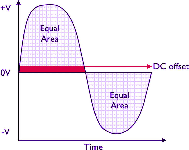

Not hype. I write now as I have a toroid in front of me suffering from it.I've been reading about DC offset on the mains voltage supply caused by the likes of electronic dimmers and computer power supplies.
It is claimed that less that 500 mV of DC can be sufficient to cause toroidal transformers to become saturated, which adversely affects sonic performance and may cause audible mechanical vibration.
https://www.isol-8.co.uk/dc-on-the-mains
Is this a real phenomenon or just marketing hype?
