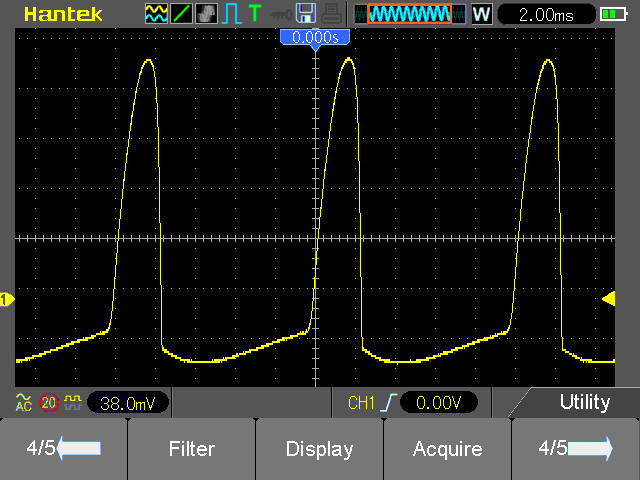

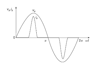

There's a nice illustration of haversine pulses in this link: https://www.sunpower-uk.com/glossary/what-is-haversine/
"The input current waveform of a power supply employing a capacitive filter will consist of haversine pulses which contain several harmonics."

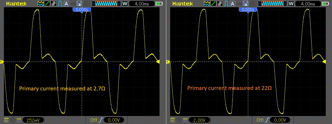

Eh, no. This is how capacitor input current actually looks like. PS harmonics and primary current waveform are at post #183.
I see that I attached the wrong image, which actually shows a typical non-linear current waveform in an SMPS.
I now attach another diagram from my link that shows the relationship between the voltage and the unidirectional diode currents that flow during the conduction time. I think this is more in accord with your traces which I've also taken the liberty of attaching, but you can always say "Eh, no"! Nonetheless, the link remains explanatory.

I like your images that show the fast rising and falling current waveforms, this with the diodes and the transformers inductance causes RFI noise.

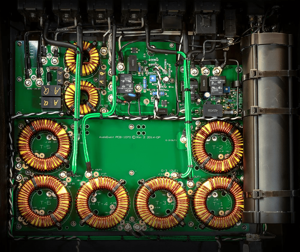

Lots of filtering going on. Do note that it looks like all the green wires are ground, and they all appear to be screw connected, not soldered. Good practice.Look at all the inductors in the ground paths.View attachment 1123951
Are those coils the type that saturate hard? High inductance until high current is drawn, but low L with current? Are they dual winding common mode?
I recall bryston doesn't go for UL, but do the Canada CSA thing. I think the statement was "inspect at the level of", but not actual listing.
I make sure any fault will run the breaker in the magnetic regime. Not sure what that unit does without a schematic.
Without a clear schematic or understanding, just assuming that inductors can be allowed in the ground to break a loop can be a very dangerous thing.

Your left jpg is the ideal haversine that would be seen on the AC legs of the bridge. It is odd order harmonics.I see that I attached the wrong image, which actually shows a typical non-linear current waveform in an SMPS.
I'm simply trying to explore the meaning of haversine waveform as introduced by jn. We're not all experts around here, and some of us are still trying to understand the mechanism by which power cords can make an audible improvement in hi-fi reproduction.
At the capacitor, the current pulses will be even order harmonics. Layout and loop control in the chassis is very important to keep these odd and even harmonic rich pulses from attacking the ground reference for the circuits, as well as not allowing the fields to stray through loop on the circuit board.

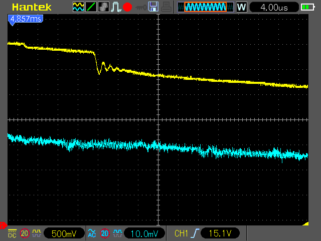

It looks like a steep change but, considering that time base is 4 ms/div, it is actually slow change. As Mark Johnson explained in detail in his work published at Linear Audio and at Quasimodo thread, biggest dI/dT is at the moment rectifier stops conducting. At this moment ringing occurs. It is well visible at post #291. Resulting EMI is in RFI spectrum (167 kHz) but has low energy and doesn’t reach even first PS capacitor. I checked this as well in case of high quality 500VA toroidal transformer and ringing frequency was about 600 kHz. Again, nothing at all at PS output or amplifier circuit.
RFI noise could be picked up by small AM radio only up to 2-4 cm apart from wires, and that’s it.
It is important to point that rectifiers used were MOSFETs under LT4320 chip control. Results are at least 10x less ringing than with best diodes in Linear Audio article. Active rectifiers are in another league than diodes.
Also, EI transformers have more leakage inductance and will ring at lower frequencies than toroidal transformers.

Did you look at the patent link I provided? It is about inductors in the ground path. In there might be answers to your questions, but maybe not. 🙂Lots of filtering going on. Do note that it looks like all the green wires are ground, and they all appear to be screw connected, not soldered. Good practice.

Thanks for including that reference of my work in 1994! Thanks too for the info on the transformer inductance.It looks like a steep change but, considering that time base is 4 ms/div, it is actually slow change. As Mark Johnson explained in detail in his work published at Linear Audio and at Quasimodo thread, biggest dI/dT is at the moment rectifier stops conducting. At this moment ringing occurs. It is well visible at post #291. Resulting EMI is in RFI spectrum (167 kHz) but has low energy and doesn’t reach even first PS capacitor. I checked this as well in case of high quality 500VA toroidal transformer and ringing frequency was about 600 kHz. Again, nothing at all at PS output or amplifier circuit.
Schurter has offered "ground choke" options in their filters for a while now. Not just for audio applications.
Schurter AC Filters
I think that a problem with a lot of filters is that they often connect a series pair of capacitors from line to neutral and connect the junction of the two to ground. In a test set-up, with really short leads, that gives more common mode filtering. In actual practice, neutral is connected to ground back at the breaker box, so that causes a problem. Of course, that depends on the frequency and the length of the ground connection. In any case, it often increases ground currents. A lot of filters specified for medical applications don't have this capacitor pair. Wonder why...
