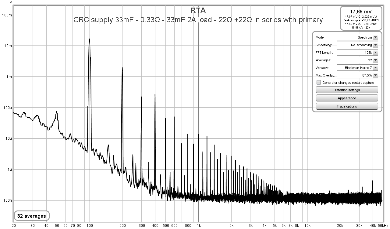

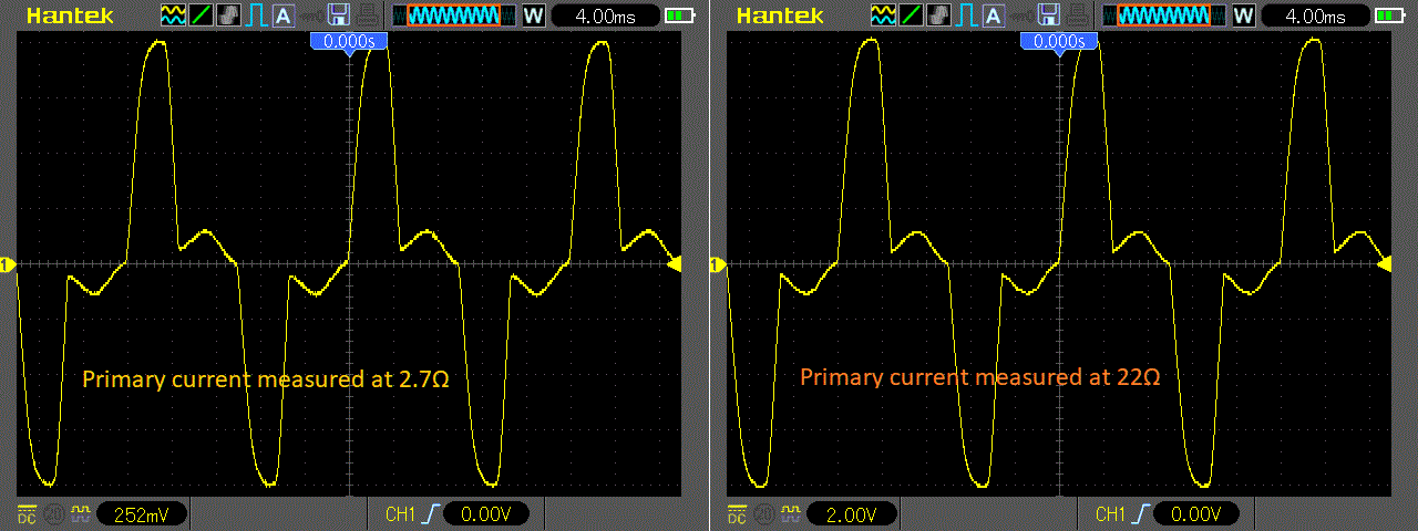

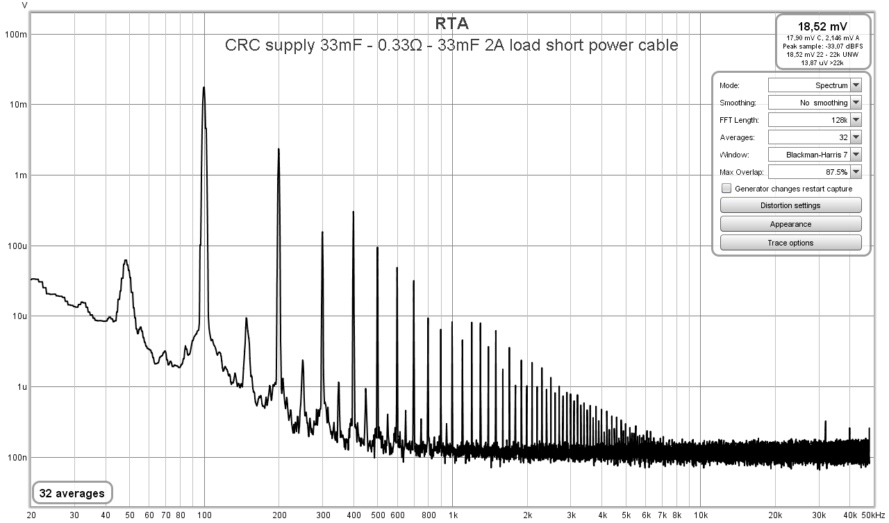

Rail harmonics were measured at simple CRC power supply connected to mains with short cable and no filters. Another measurement was made with two 22Ω resistors added to both primary wires. If low power cable impedance enables harmonics and noise to be damped by allegedly low power network impedance, then inserting such high resistance should make harmonics and noise to increase.
There is no meaningful difference. Small differences are due small variations in mains voltage and noise over time and different moment of taking measurement. Transformer primary current waveform doesn’t change as well.
When thinking, ‘where could harmonics go’ it is better to understand that measured harmonics don’t exist as a separate from the main 100 Hz waveform charging PS capacitors. They are simply deviation of main 100 Hz charging voltage/current, from the ideal sinewave. So, all harmonics go to PS capacitors and circuit supplied by PS.
Harmonics would change if power supply cable can change shape of voltage/current flowing to PS capacitors and load.

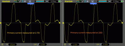

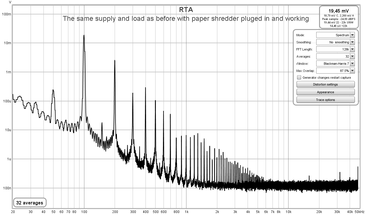

Now, we have another made up example, where mandatory noise suppression components were obviously removed from the paper shredder.
I plugged very similar shredder to socket next to power supply plug and measured noise with shredder on. Only difference was at 50 Hz as magnetic fields from motor were 50 cm apart from the measurement cables and gear.
You can accuse me of not knowing how to make proper measurements, unlike those
To be clear, I’m sure their products successfully reduce noise from mains. It’s not a high science.
