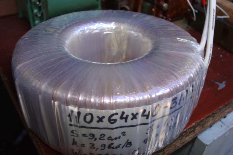

Hello Pepe
About 12V.
I make it curtanly.
2 A ...
Dataheet for feelament is 6.3V.
Ukraine was be the USSR.
And there was many tubes like institutes and military factories and military base...
Russia is USSR was too.
But if this Lampizator use RC fllter for filament - I am indestand...
But if you have your oun thinking, please try...)))
I am about cap.
Cap is between DAC and tube and at the output.
May be use accumulator -3V...
At the output - may be think about transsformer?
But I think it's > clearly for you(what is beter-cap or transformer)...
At the nearest time I will show you the amorph trafo...(the picture)

Dear Nafanja,
thank you for taking the time to explain that to me, I really appreciate it.
The following pictures are draws about what I understood from the specs of the 6H6P and what you said:
So following your indication, heaters will be 6,3V (either DC retified or AC directly) at @2A . Therefore, I need 1 secondary of the transformer to be 6,3VAC @2A.
The other secondary, again : 120 VAC @1A (Which I will rectify). I decided to use 1 tube only, and try to make things simple and easy.
Having clear that part, then you talk about 2 caps on the design:
The C1 cap on the picture is a decoupling cap (given the DAC is voltage output), as you know of course, but here you recommend... a battery or accumulator of about -3V for autobias or something ?, this is interesting... I would love to hear more !!
The other cap you talk about is the one that is just by the RCA connector. Do you recommend using a trafo there ???, I am not sure I understand...what would you do ? (my electronics are not that good, as you see...). what will be the benefit of a trafo there ?
And finally you mention an "amorph" trafo , I'm afraid I am not familiar with this... which will be the benefit ??
Thank you very much for you patience and understanding, my english is not that good and I find difficult to explain here the details of my project.
I look forward to you comments, and again...thank you !!

Hello Pepe.
For the sound need quelity cap.
You have pulsation of curent and you will need good capacitance.
I know man. who build ultra-high-end. He use in his RIAA near 400 MF (no electrolitic). or more.
But have oinion that trafo is better than cap.
But it's opinion.
If teoreticaly-
Zout = 65.5 Ohm.
With resistor Rcathode = 330 Ohm.
LR - R = 47 OHm.
With transformer Rout= Zout 65.7 Ohm=Rcathode
47000-470/65.7 = n
(The last resistor)
Slew rate is more near = n more
(We work on the input capacitance of next tube or transistor)
The transformer with near >100 Henru is the
near o Hz (-odb). The high frequency will me near 500 kHz and >...maby 1.5 Mhz...
Low faze distortion too.
High Slew rate is that you will hear...
You will make the dofference after the hearing.
If you will likwe - it. I will back the money (trafo too)))
